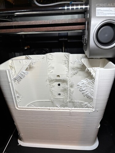

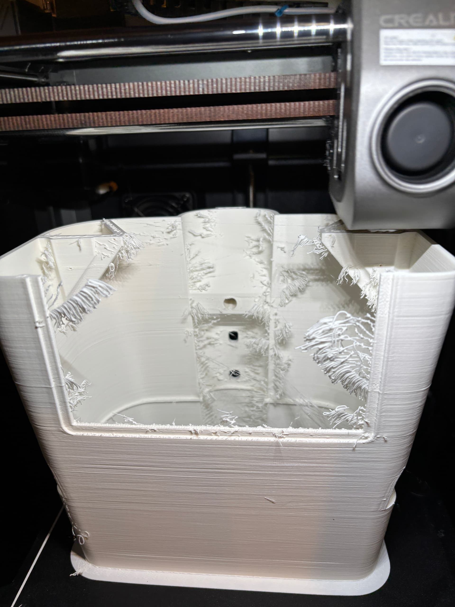

This only seems to happen when I print with LIGHT WEIGHT PLA. Doesn’t matter what make. I am using PolyLite LW PLA presets in ORCA slicer with the temperature at 240. Can anyone tell me what I can do and where in ORCA to prevent this?
Hello !
If I remember correctly, the LW PLA of PolyLite is prefoamed, right ?
So you may need to dry it a lot before use ! (55˚C for 6h is generally good)
Also, it’s normal to get a lot of stringing with it. That’s one of the downside of LW-PLA
Same with the speed, how fast are you printing ? LW-PLA is generally 25mm/s - 60mm/s max
Hi Alex,
First layer is 60mm/s, other layers are Outer 200, inner walls 300.
I’ve seen some posts on FB groups that say, go faster, select do not cross walls (already had it selected)
