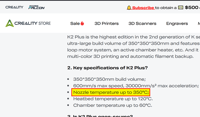

Printing over 300 degrees nozzle temp with the K2 Plus is driving me insane. I am trying to print with Fiberon PPS-CF at 320, and every time when the printer completes the self leveling and heats the nozzle to 320 it kicks an error and shuts down. Internal error on command : “BOX_MATERIAL_FLUSH” , “values” :[BOX_MATERIAL_FLUSH] "box_material_flush LEN=140 VELOCITY=360 TEMP=320: TEMP must not have maximum of 300. I am losing my mind. I have tried using the “generic” PPS-CF profile in the slicer and selected in the printer external spool holder, and with a custom material profile I made based on manufacturers settings for the filament. I have come to the conclusion the problem lies somewhere in my slicer settings/filament profiles/configuration but just cant figure it out. I have been printing for 7 years and have never had this much frustration - even back in the day of manual everything and fighting for first layer and dimensional calibration.
Any help would be be GREALY appreciated

So I finally got some movement from Creality that made sense. I have inserted the code and am drying the PPS-CF to try again tonight…
"Latest update: Our R&D technical team has found that firmware errors were caused by differences in filament. We will optimize the firmware in the future to improve this issue.
Temporary solution:
Please go to the Fluidd settings and add the following macro at the end of the configuration file gcode_macro.cfg (as shown in the image):
Copy Code:
[gcode_macro BOX_MATERIAL_FLUSH]
rename_existing: BOX_MATERIAL_FLUSH_BASE
gcode:
{% set temp = params.TEMP|int %}
{% if temp >= 300 %}
{% set temp = 300 %}
{% endif %}
BOX_MATERIAL_FLUSH_BASE LEN={params.LEN} VELOCITY={params.VELOCITY} TEMP={temp}
