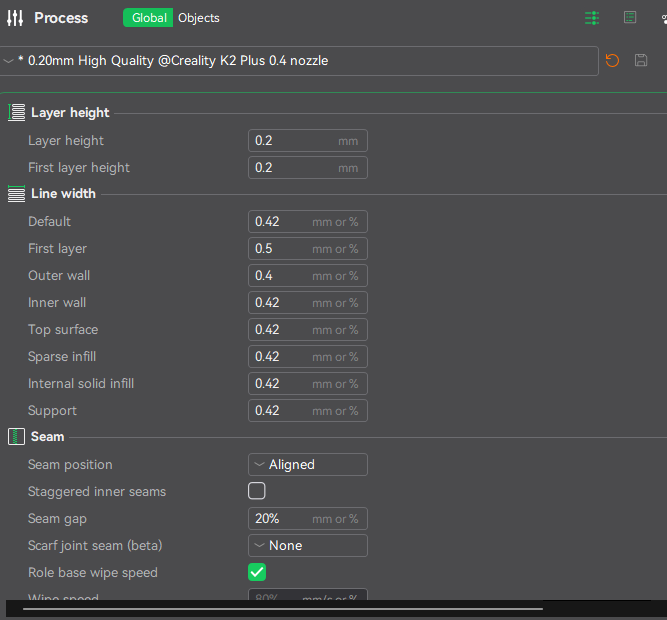

She prints!!.. until she has the CM2784 error… LMAO!!!
I am going to look around the forums to see what everyone else has been getting, but there is no clogged nozzle and the bed mesh is within the .4mm range now. The weirdest thing about the error I got, it happened when I was attempting to print a large object, I was able to print the temperature tower but the large print was going fine and then maybe 25% into the second layer the error code CM2784 popped up. Forces the tool head to move to the back of the printer to clear nozzle off. but refused to restart printing. The extruder motor does not spin or move after this error comes up. But I was able to get the bigger temperature tower printed which is weird.
Did the old IT trick of power cycling the machine and the printer began extruding again. Not sure why it causing this but I will have to do more research into it. My thoughts are as follows:
  • Temperature too high
  • Adjust Z offset
  • Calibrate retraction
  • Check filament profile (maybe need to adjust the speeds)
    → current printer profile is set to the so-called “High Quality” profile
But my guess it has to do with the speed settings of the factory generic polycarbonate profiles. I am not much of an expert at this nor do I claim to know anything. but if I had to guess it has to do with the speed this is set to. If anyone has a printer profile they can share that would help out a lot. In the mean time I am going to look at what other printers are using for this filament. As well as look at what polymaker suggests for their filament to be printed at.
I am also wondering if the Z offset does not get saved from the beginning of the print because I did notice that the nozzle was too close to the bed or it could have been the filament was underextruding.
