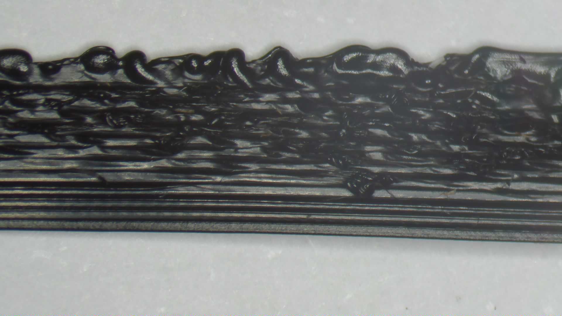

Any way the issues. Pic 1 is of the top surface.
As you can see, pretty “lumpy”, that’s why I increased the temp. This part of the print is a brim, lower part of the print is the outside or first pass of the print.

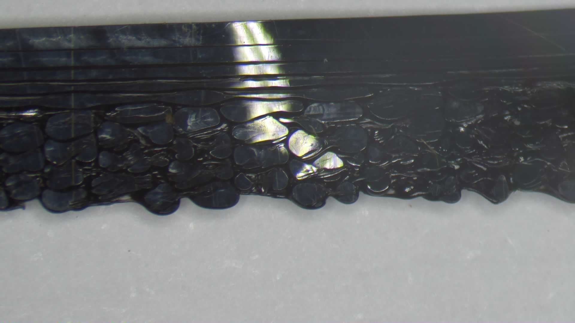

The underside or bed side also shows this issue.
As you can see it starts out pretty good, I’ll tune the first layer width, but seems reasonable, then it goes to rubbish and due to the lumps the nozzle lifts the print off the bed and fails.
If anybody can help I’d be very grateful!
Have you printed in a heated cabinet with fans off? It prints pretty much the same as ABS.
Yes, I’m using the Creality soft inclosure and there shouldn’t be any print fan at all. I will double check that though.
