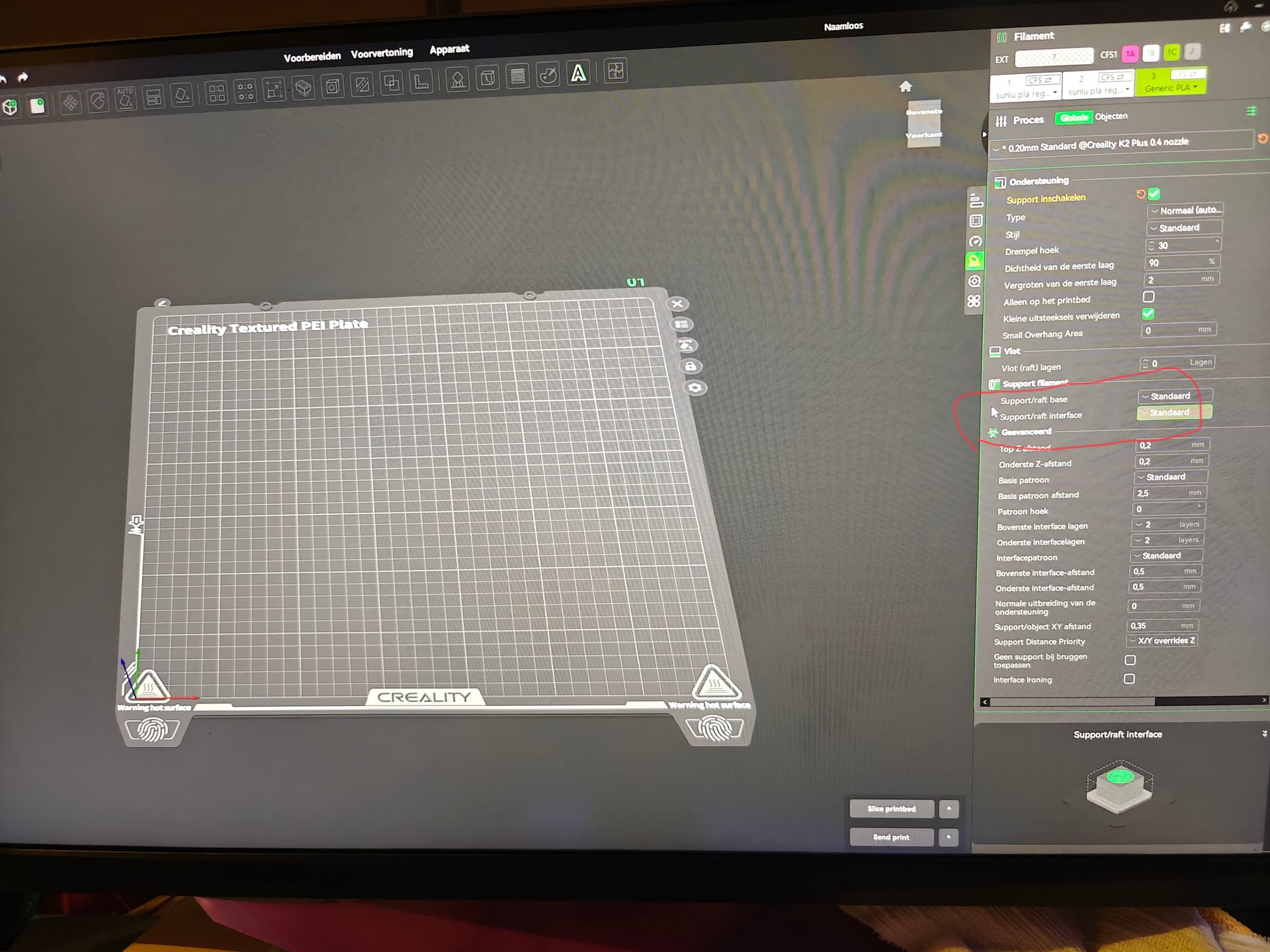

Hello; im trying to print my object in a different filament than its supports but i am not aware how to. (Creality v6 and printer creality K2 plus)
can you be more specific ? are you trying to print using different filament types (PLA mixed with PETG, etc) or just different color ? or are you trying to use different filament material for support (or support interface).
As HC_1234, says, “a bit more information please” as I look at it like you are wanting to print with a filament that is not supported by your K2plus.
If so, what type ? like metal fiber maybe ? or is it simply say PLA in a gloss that is not listed in what is already available in the slicer filament menu.
Cheers.
You can select here the material for support.
Dont know how the flush rate is now. You need to flush enough because when it mix in the nozzle it wont stick ar you gonna get a clogh.
Also you can get problems with the purge tower. Dont have used it for a couple of months and not did any test after last 3 firmware en slicer updates.
