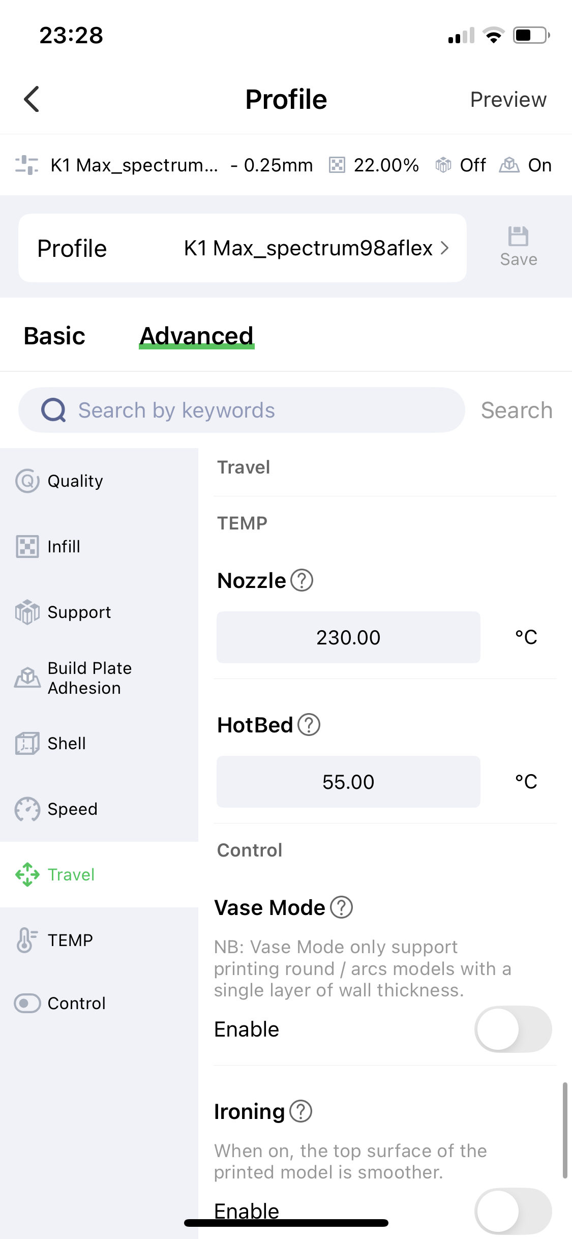

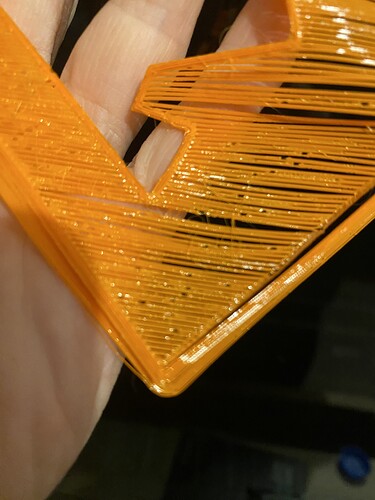

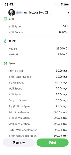

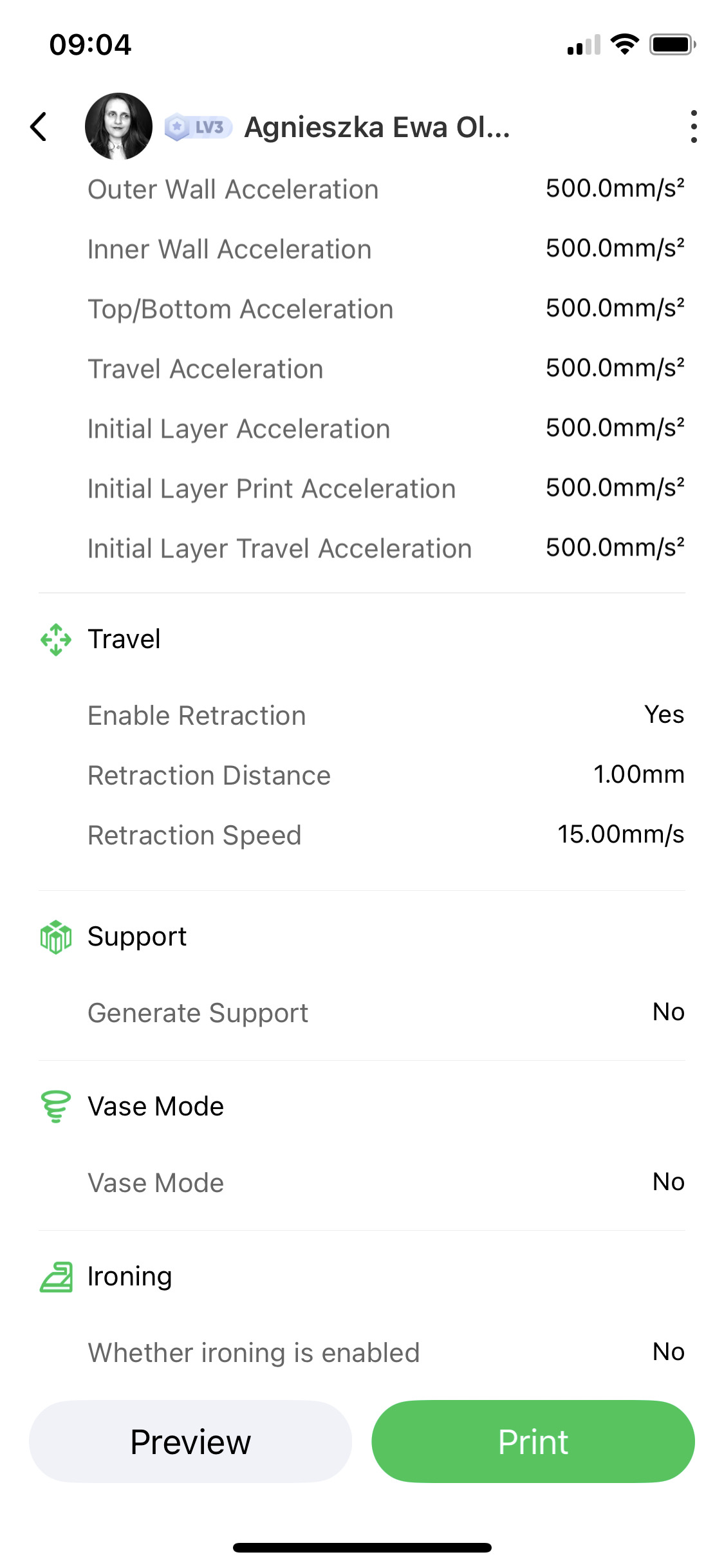

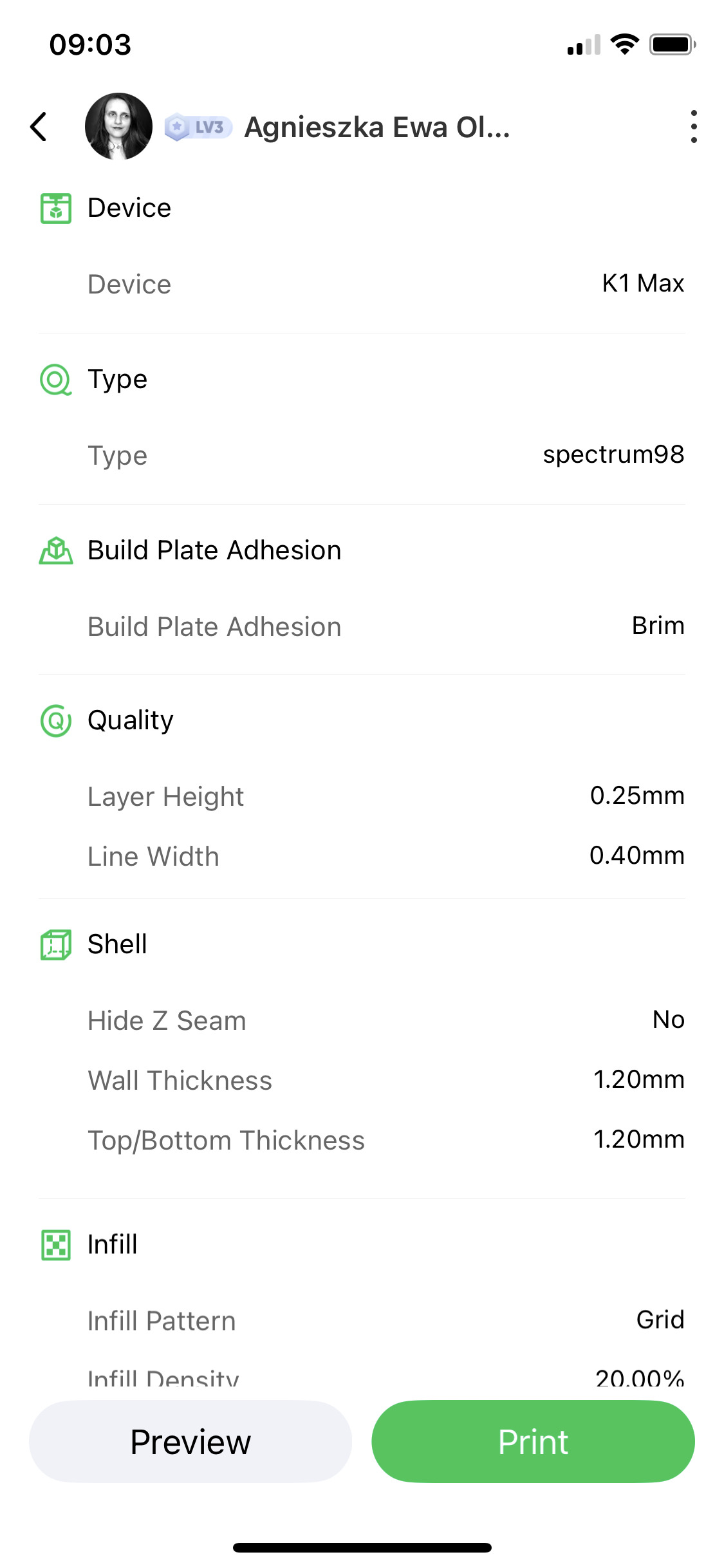

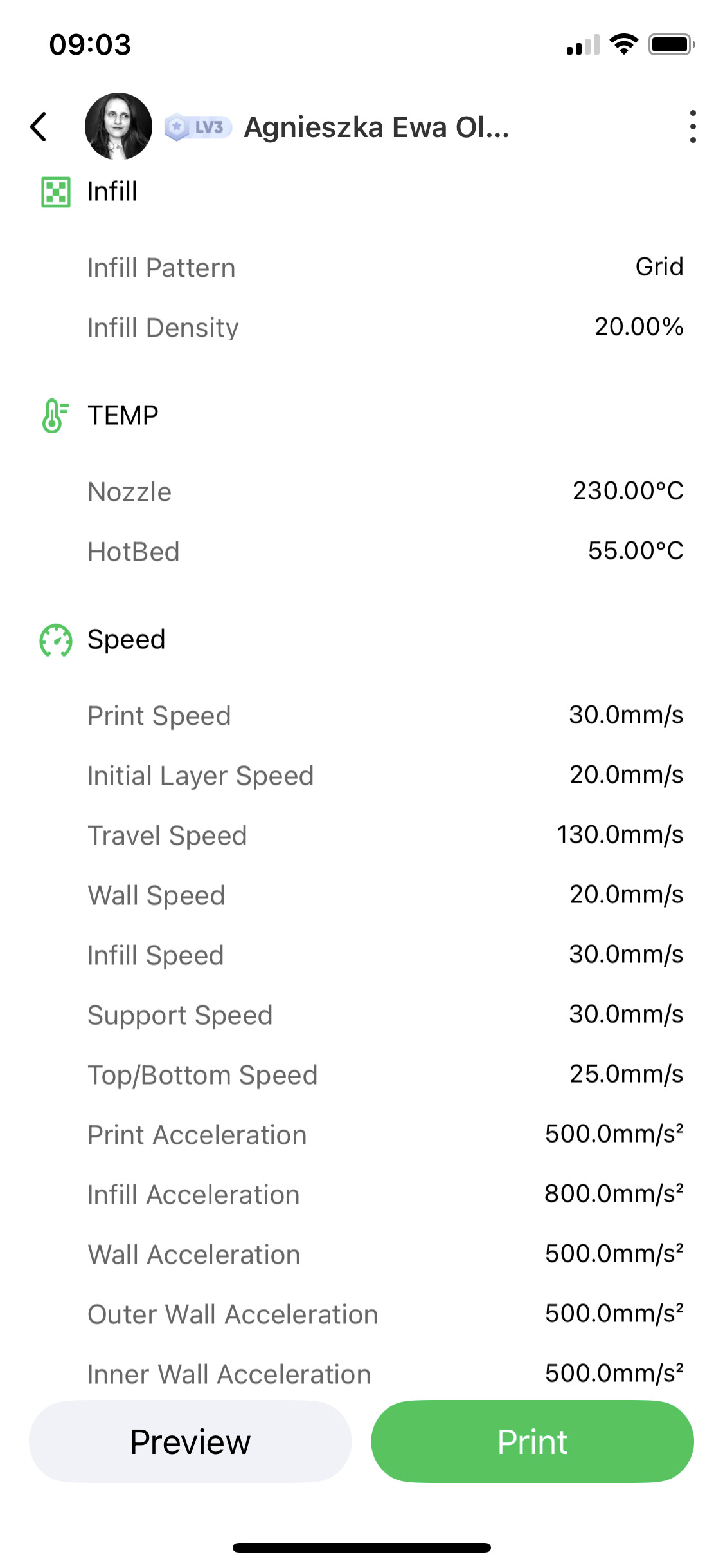

Printing tpu on k1 max
I have issues with printing tpu. I added some settings directly from the slicer. I haven’t adjust as far only feeder settings. I don’t know why it is not working. K1 Max should handle smoothly with 98a. What else I can change?
