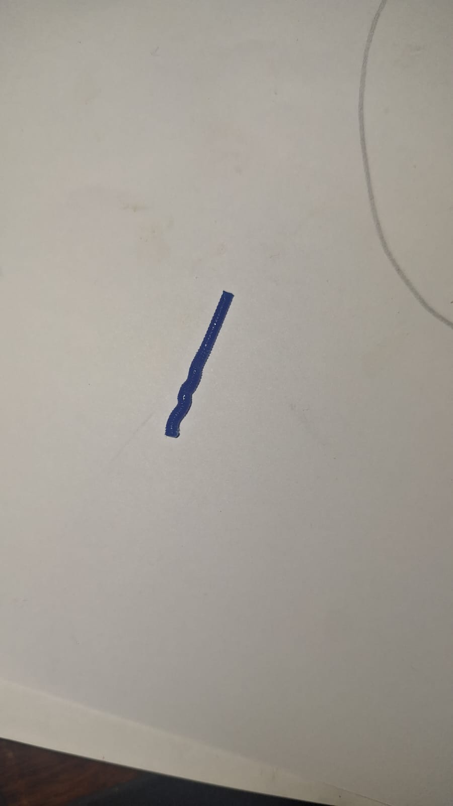

Hello, I have a problem with my Creality Hi Combo. I want to print some small keychains, but I’m having issues with the extruder where the filament enters the nozzle. I’m experiencing jams, and I’m not sure what’s causing them. It’s not that the nozzle is clogged; I feel it’s due to the retraction. I should mention that I changed the nozzle from 0.4mm to 0.2mm, and I’m using a preset profile from the Creality Print software. I’ll attach a photo as evidence of the problem, and I would greatly appreciate any help. I’m a complete beginner with 3D printers and would really like to resolve this issue. Thank you for your time.

May be you are using a high nozzle temp for the fillament, try lowering it a little bit.
I have seen this a few times as well using PETG. I have seen some suggestions that it is related to retraction.
Some troubleshooting ideas.
  1. First to try - clean the nozzle. there may be some build up in the nozzle but not enough to keep from printing. This would include doing a cold pull.
  2. Make sure filament is dry.
  3. reduce retraction - PETG can cause blockages if too far and too fast retraction. Maybe reduce retraction speed (25 to 35mm). See settings under Extruder in you Printer Settings.
  4. Correct temperature (too low-hard to extrude; too high-oozing)
  5. Try other filament brands. Make sure the filament is tuned (temp, flow rate, pressure advance, max flow rate).

Note I don’t think that is the problem if this is PETG (probably retraction setting). If TPU, you really should slow the speed down by a lot.
Thanks, I will try a Cold Pull tomorrow to see how is my nozzle.
