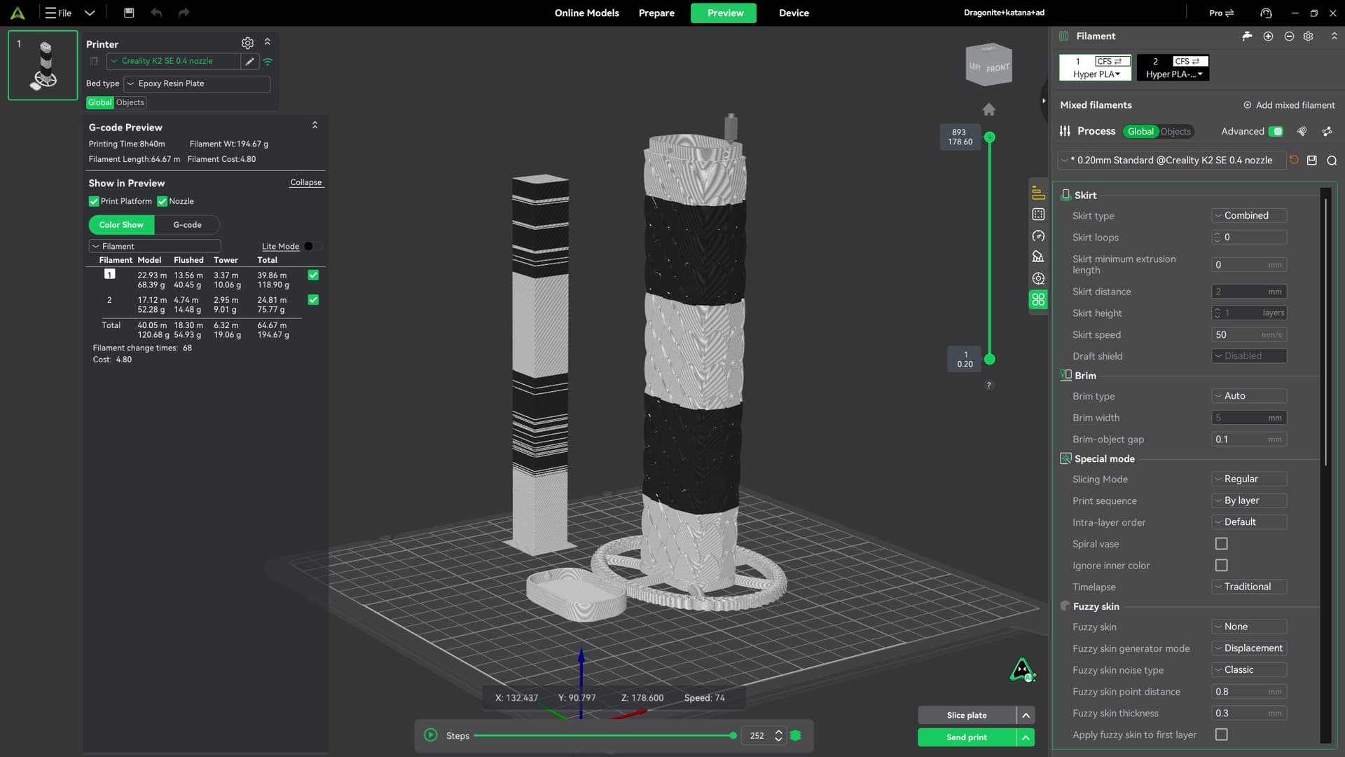

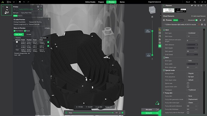

I recently bought a k2se and just started trying out multi color printing. The issue Im having is when slicing a print Im getting random filament changes adding alot of time to the print. These are simple layer paints changes as Im just trying it out and not going to wild and it keeps adding single drops of the second color in the middle of the infill and even some times small triangles of simular shapes. Each time its in the infill and its adding tons of time to the print as far as the slice is as I haven’t done one yet not wanting to take loner than I need to do these. Ive tryed changing tons of setting but they continue to show up with each slice. I even tryed slicing up a model with single color and just swapping the fillament from PLA with the model to PETG for the suppot interface and it’s doing there as well all though it’s only switching on the support and not in the model itself. Im using Creality Print all though I have loaded up Orca and it’s doing it there as well. The pics I added are just a way to show how much the changes are on the purge tower as well as a close up of one of the small triagles its seams to be randomly adding.

For this I think it is better to do a filament swap on a specific layer instead of painting colors on the model…

Didn’t know about the layer filament changing option on the slicer. tryed that and it’s working that way.. thanks much
