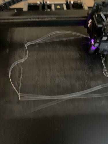

Z offset is too high. You should be able to adjust it on the fly. I would print a skirt of 3-5 wide before the actual print to get that Z offset adjusted perfectly. I have to do it on all 4 of my printers, it’s a simple adjust of lowering the Z offset by 0.05mm increments until it squishes into the bed properly.
I tried a -50 Z offset however even that doesn’t work.
Can you get the nozzle down to the thickness of a piece of paper? Then drop the Z down by another 0.05mm and you should be pretty close.

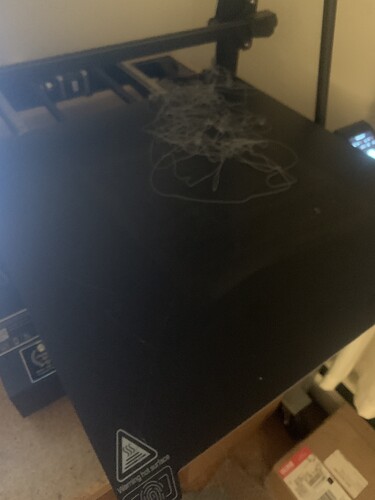

I have dropped the nozzle down to -155 z-offset. I used some SIBOOR PVP glu stick. I washed the PEI sheet and used isopropyl alcohol on it. I built the print using a raft. The model adhered but after a few hours it slid off the build sheet and landed on the floor. I cannot finish a print on the CRM4. Nothing stays fixed on the PEI sheet. I am using PLA. Do I need a textured PEI sheet?
I cannot use a brim because when I print a brim the CRM4 only prints an outline and then the brim fails. Here is an attached photo of what happens when I attempt a brim.
