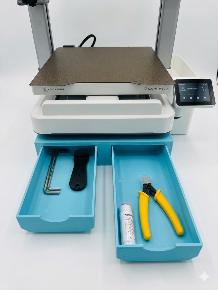

I recently designed and uploaded to Creality Cloud a base with drawers for my Creality Sparkx i7 3d printer. While I could have done the design in Autodesk’s Fusion or other free CAD program, I decided to design it using Creality Print version 7. Here is how i did it.
This was my process but I am not an engineer. Although I as a maker, I have started to learn Fusion and other free CAD programs, so this is probably very inefficient and if you see ways to improve this process I will not be offended.

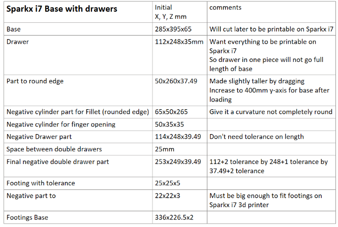

First of all we need to get all the measurements.
In hindsight I have all these measurement now but in reality I would keep going over to the printer and get measurements as I thought of them.
We will do the drawers first since we will need the drawer piece to build the base, you will see why when we do that part.

  15. Take base with rounded edges and before hollowing
  16. Add tolerances of 2mm (1mm for each side and top/bottom) and 1mm on y-axis
  17. Clone and center and move on x only then meaure to be 25mm apart
  18. Save as negative part

Save whole .3mf and delete unneeded parts and add drawers stl and save final .3mf for printing later.
Print and enjoy
