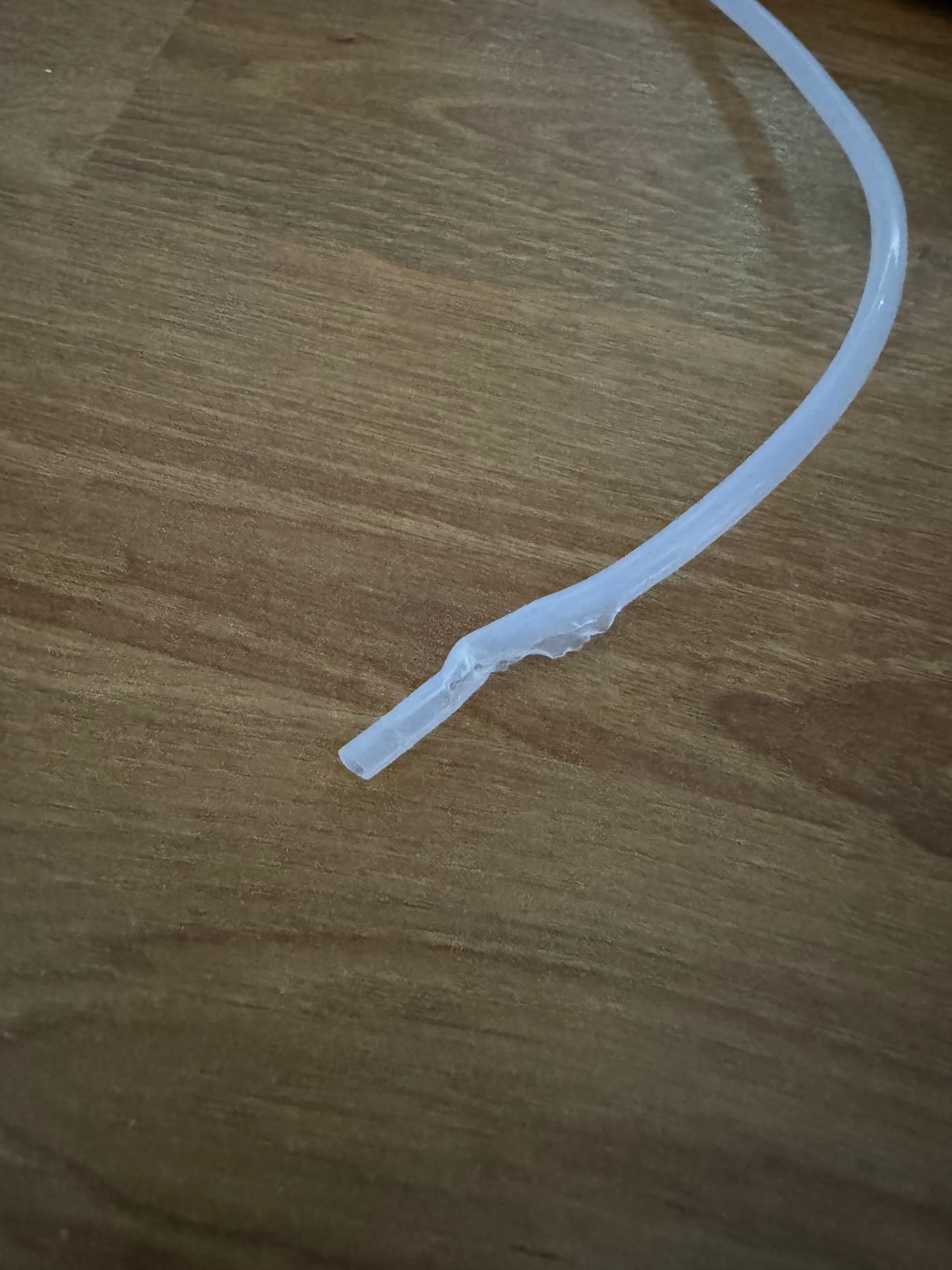

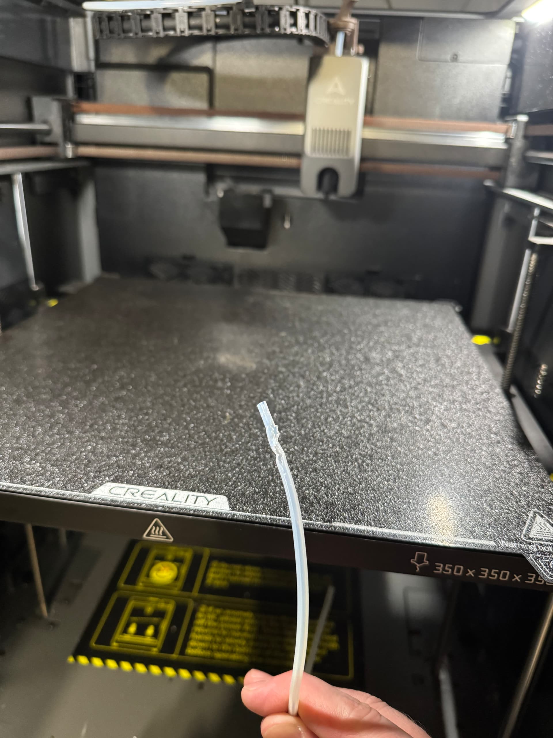

Make sure you check and change the PTFE tubing regularly. I was printing PETG-CF over the weekend and went to start a regular PLA print and it failed to make it to the extruder. :thinking: noticed the filament on the counter right away. Easy fix, just retract the filament and replace the tubing. It’s good practice to keep some on hand! It wore through right where it exits the CFS unit.
