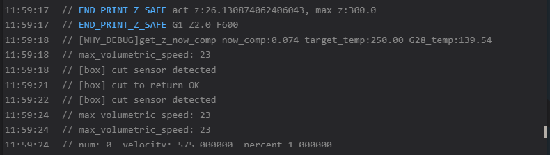

  • Regarding max volumetric flow settings ,since i have swapped my nozzle, i wanted to achieve higher volumetric flow, but sadly I can’t because my fluid ui console shows max voluemtric flow 23, I have set 27 in my filament profile, but every time it shows 23 in UI.

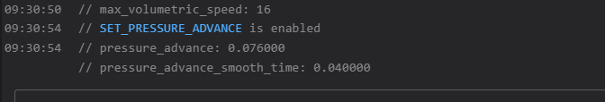

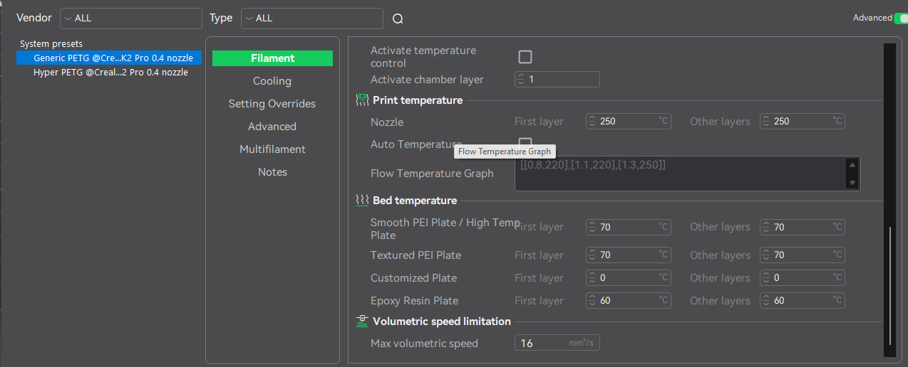

Update regarding max volumetric flow, I have tried some different settings, what I noticed was that if i set CFS unit filaments to generic PETG, than every print my volumetric flow rate is limited to 16, like it is on system preset. IF i set creality hyper petg my max volumetric flow is set to 23 every time. Sadly only those 2 options are available in CFS settings on my printer display / creality print interface).

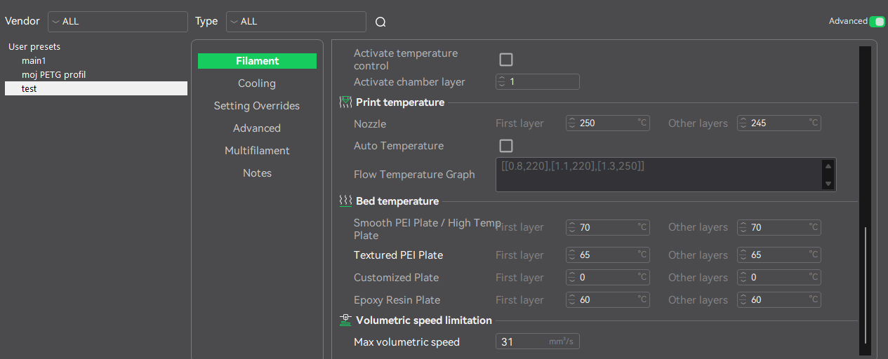

I have tried making new filament settings, reinstalling whole creality print, checking settings but i can’t seem to figure out why my printer is locked to that low volumetric flow.
^ PIC1 : My new test filament
^ PIC2: Generic PETG
^ PIC4: ( TEST filament profile choosen in creality print), when print starts it sets volumetric speed based on system preset and not user preset I am using.

But no matter what setting i choose on k2 pro, fluidd ALWAYS shows max volumetric flow 23 or 16 based on what CFS has picked. There is no option other than Creality / Generic PETG, and based on what I see, printer uses System preset volumetric flow and not user preset one.
For example here i choose Hyper PETG from creality in my CFS, then i choose my own filament setting preset in my Creality Print( I had set it at 31) but when print started, it’s again limited to 23.
Even when doing max volumetric flow calibration, system automatically puts 200 as limit in my filament settings,but when i start the print console still shows either max volumetric flow 23 or 16, based on what i choose in my CFS.
When i did max volumetric flow calibration I have put calibration from 20mm3 to 50mm3s but after inspecting print its perfect from bottom to top, so im 99% procent sure it’s capped somehow, somewhere.
