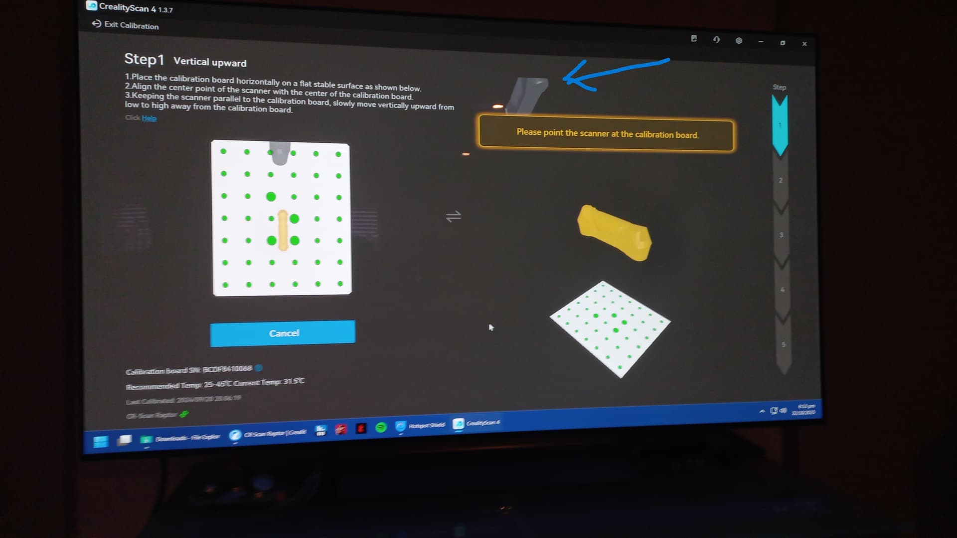

What I’m Seeing: When I position the scanner square over the board and far enough away for the error to disappear, I can see:
  • The scanner shadow is positioned over the board on the left
  • All registration dots are green, indicating the scanner sees the entire board
  • However, the shadow image of the scanner that should appear on the right (which moves up and down with scanner height) is off-screen because the scanner is too far away
  • This shadow should overlay the yellow image at the correct height to initiate calibration
I can get the shadow image to appear on screen if I move the scanner off-axis (the blue arrow is pointing at the scanner shadow image in my screenshot). This confirms the system knows where the scanner is in space. But as soon as I move the scanner closer or back to vertical, the shadow image disappears and the error message returns.

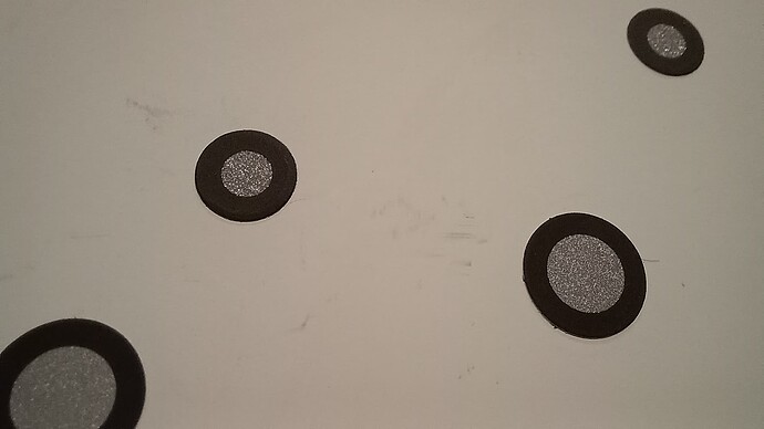

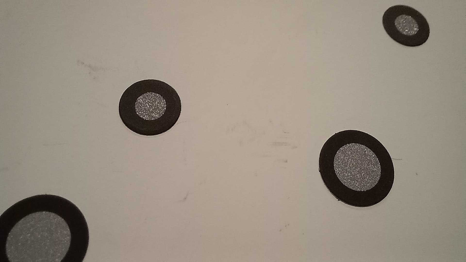

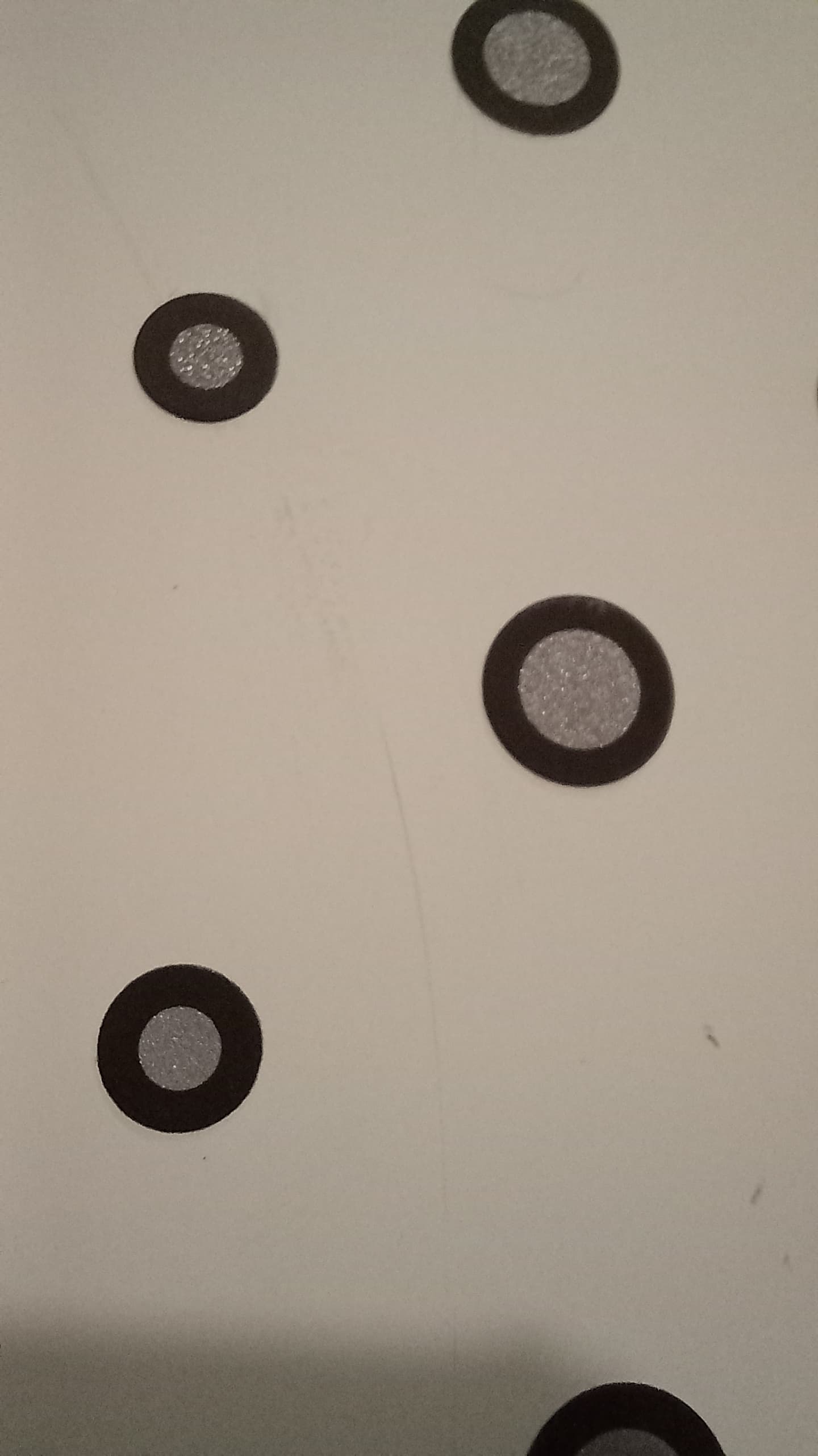

A bit more info… So I tested the scanner and it seems to scan objects correctly. I noticed some slight marks on the calibration board. They are quite faint. See pics. Might this be sufficient to throw out the calibration process?
Any advice would be welcomed.

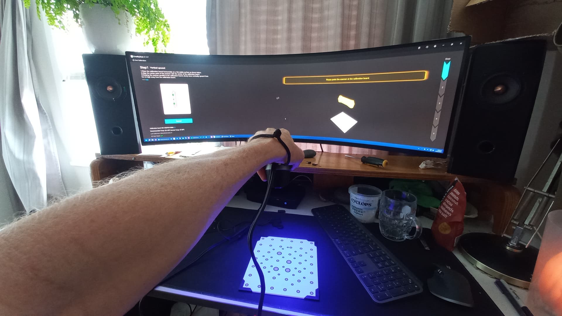

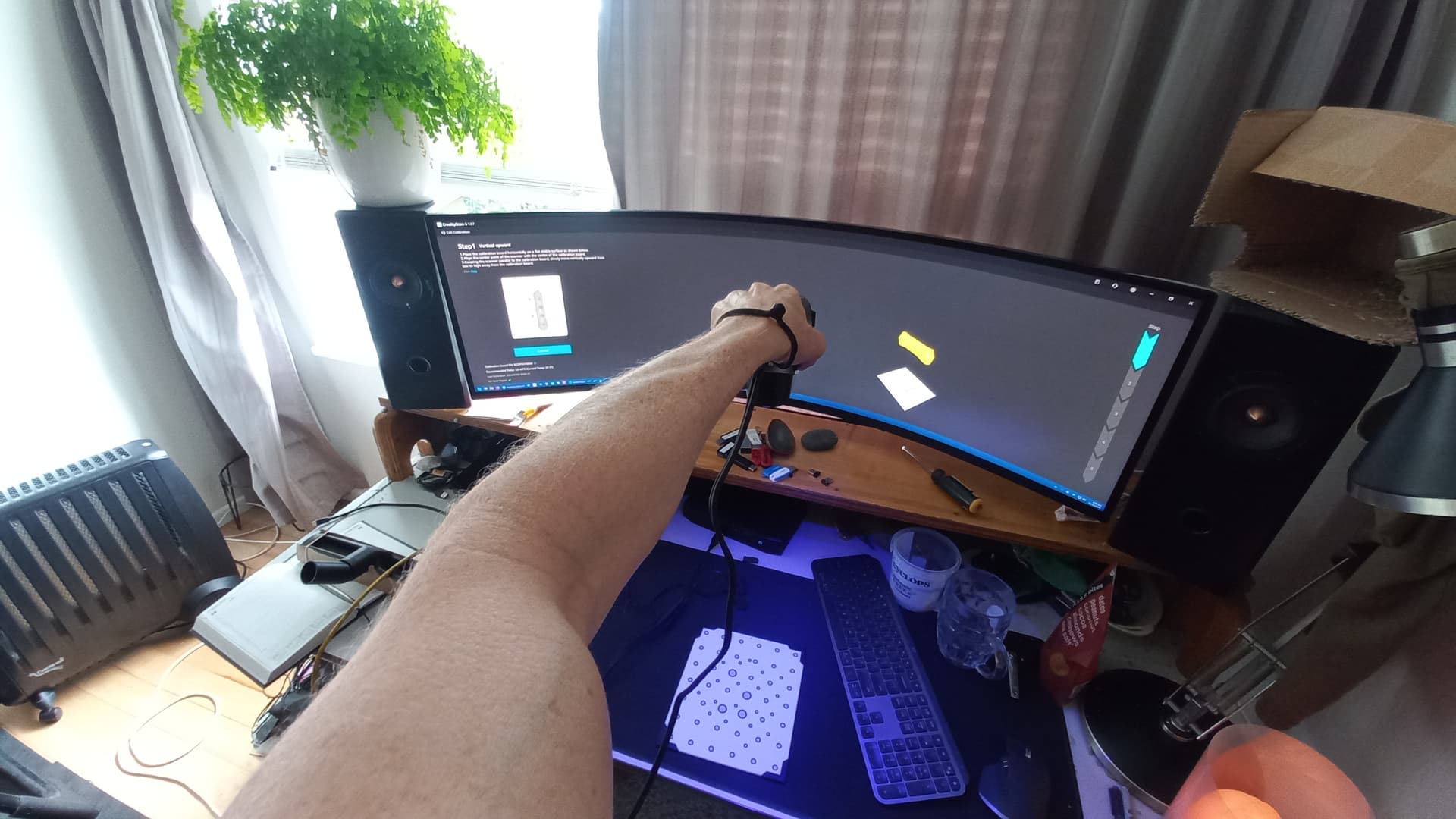

Photos of the calibration errors i’m experiencing:
Scanner at low level: causes “Please point the scanner at the calibration board” error
Scanner at high level: scanner recognises calibration board but its too high to start calibration process.
Scanner off axis: Blue arrow points to shadow image of scanner, suggesting that CrealityScan is aware of where the scanner is in space but its just too high to be seen when directly above board.
