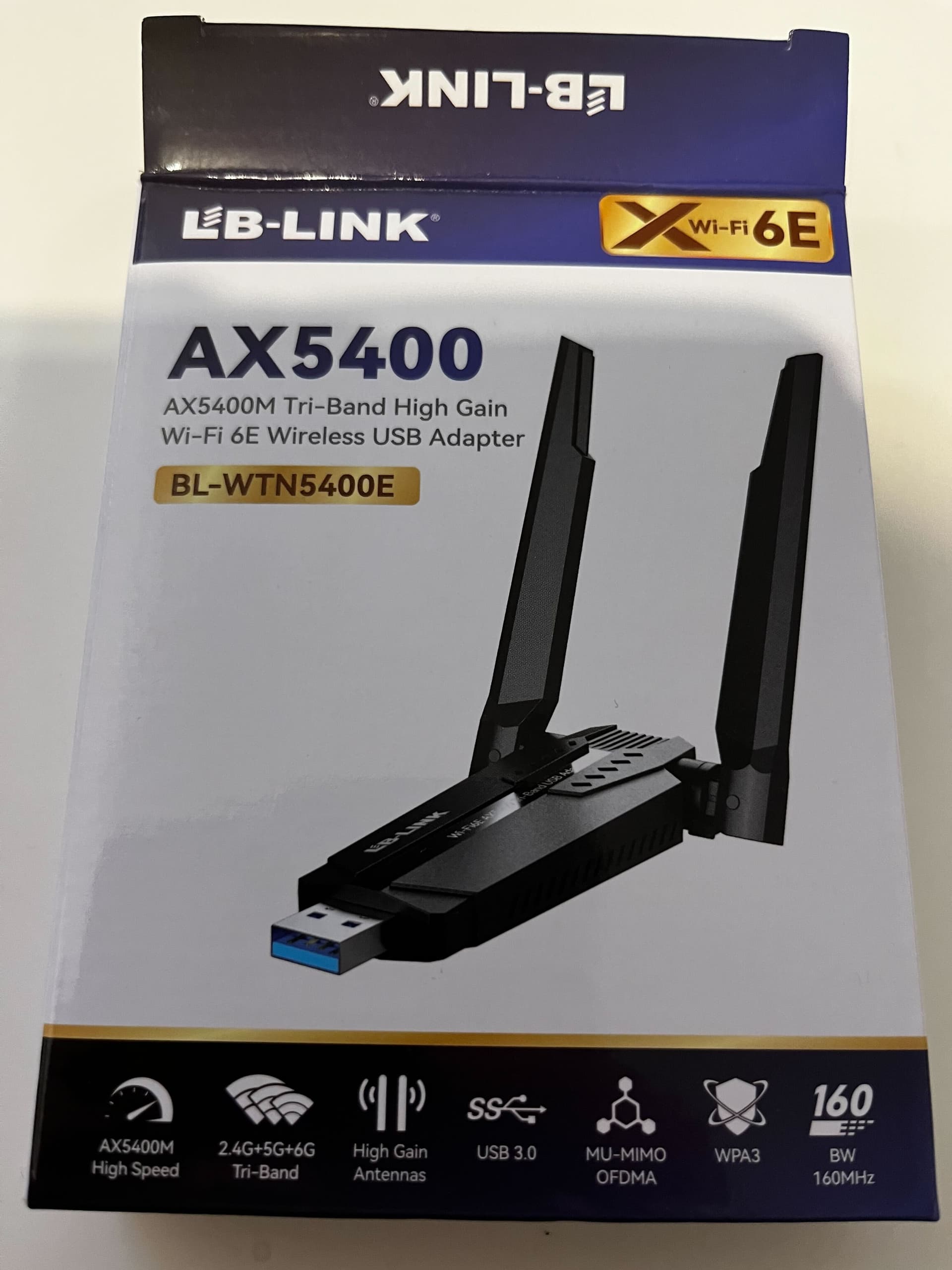

i have that setup and it does work, not sure what could be wrong with yours to be honest, as i didn’t need to do anything special, just make sure that you’re connecting the wifi dongle to the fastest port you have
The wifi dongel that came together with my Bridge explicitly says “Only supports Windows 10/windows 11“.
Have you gotten it to connect without the dongel? Also, which wifi dongel did you get? Does yours support MacOS?
you need to use the dongle as far as i’m aware, i don’t have the box anymore, but mine is not exactly that one, although looks pretty similar - it is a comfast cf-972ax
edit/ and i didn’t notice if there were compatibility indications on the box, but i just plugged it in and it does work :slight_smile:

Yeah, I tried the dongle. Nothing happened. But it was kind of expected when it says it only supports Windows.
Would you mind sharing your MacOS version when you have the chance? :innocent:
well i just found something interesting, the wifi dongle wasn’t actually doing anything after all, looks like mine isn’t compatible with macos either! i’ve been connecting directly all along (which might explain the low frame rate to be honest, i think with the dongle working it would be higher)
i then went to research a bit and it is possible to workaround and get drivers installed for my dongle at least, but it’s too much work and some ‘hacky’ software - Wireless-USB-Big-Sur-Adapter/Usage-macOS-Tahoe.md at master · chris1111/Wireless-USB-Big-Sur-Adapter · GitHub
