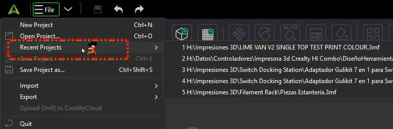

Can anyone tell me where the recent projects files are kept in windows 11. I work across multiple pcs and would like the same recent projects synched across the devices.
Thanks

If you are talking about the item «Recent Projects» on the File menu of Creality Print, THERE IS NO DEFAULT folder, as you can see is the full path of the last open projects, on the Creality Print you save a list of the full path of the last files you opened.
If you want to preserver THE LIST no the files those are saved on the Creality Print config file, That file is stored on “%APPDATA%\Creality\Creality Print\7.0\Creality.conf” (FOR CREALITY 7.0)
Be aware of that file can not be manually edited and contains ALL THE CREALITY PRINT SETTINGS.
Also on that route there are the folders
“%APPDATA%\Creality\Creality Print\7.0\system”
“%APPDATA%\Creality\Creality Print\7.0\user”
which contains the profiles you must backup user one.
