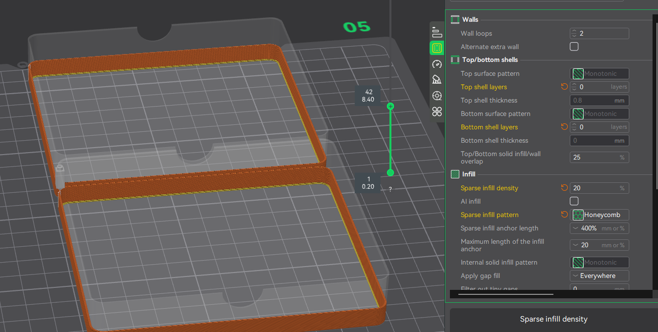

Remove top and bottom layers issue

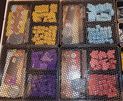

Hello, I’m trying to print by removing the top and bottom layers just to reach this final print presentation:
I just modified the settings of my profile as I usually did with Cura or other slicers but I only reach this result:
You can also see the settings I changed. Can anyone help me on which options I have to change?
Thank you in advance!
Hello !
Do you have the lite mode activated ? :slight_smile:
You can see that in the “Preview” section where you can select “Layer type” or “Speed” or …Etc
OMG thank you so much Alex! I didn’t know it and now I can see it :smiley: Let’s go print!!
You’re welcome ! :grin:
