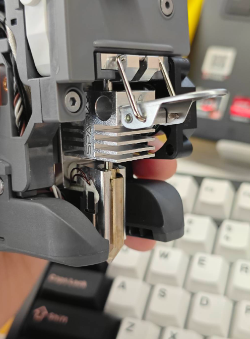

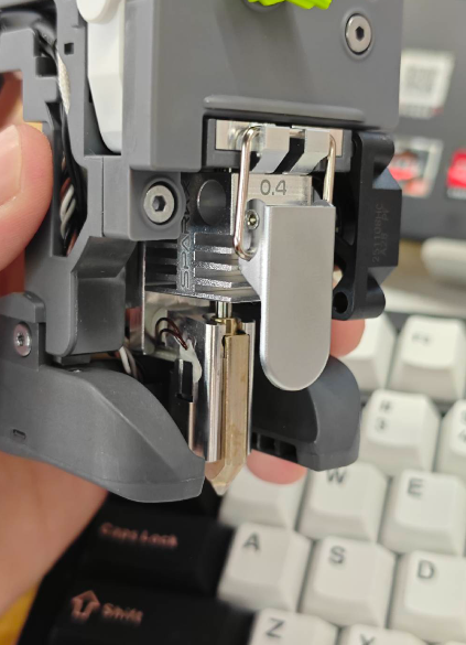

Remove the toolhead front cover, then remove the hotend sock and the quick-release hotend. Be careful not to operate while hot to avoid burns.

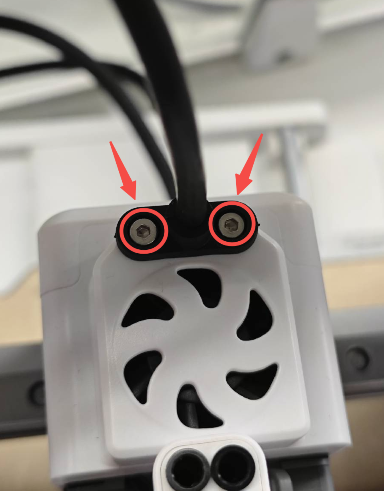

Unscrew the two screws on top of the toolhead and disconnect the toolhead cable.

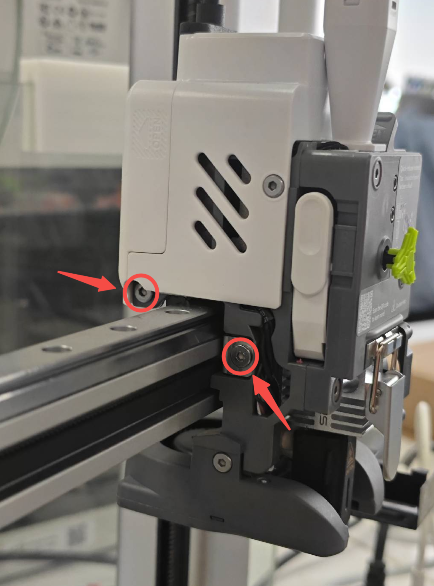

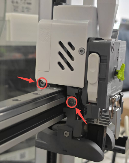

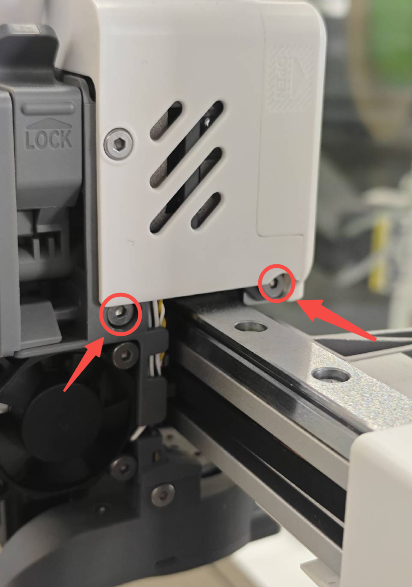

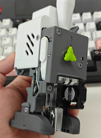

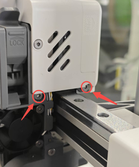

Unscrew the four screws on both sides of the toolhead to remove the entire toolhead, allowing access for the following steps.

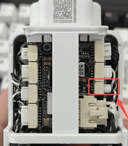

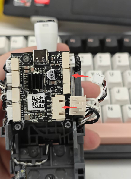

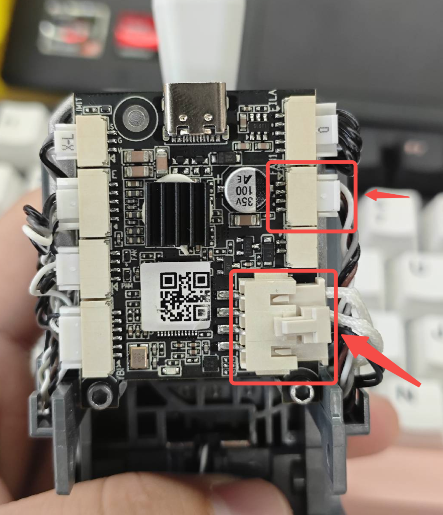

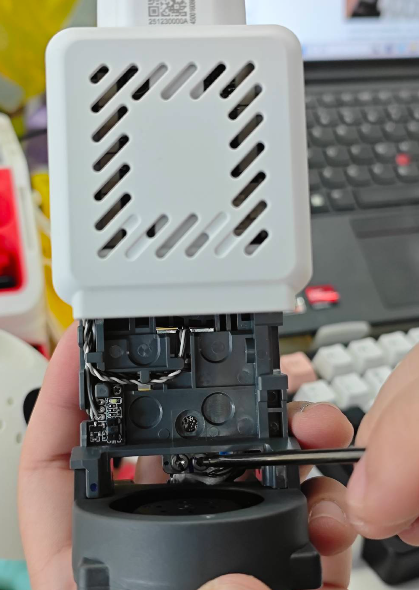

Remove the Toolhead Back Cover to expose the Toolhead Board. As shown in the figure, unplug the connector corresponding to the Extruder Cooling Fan.

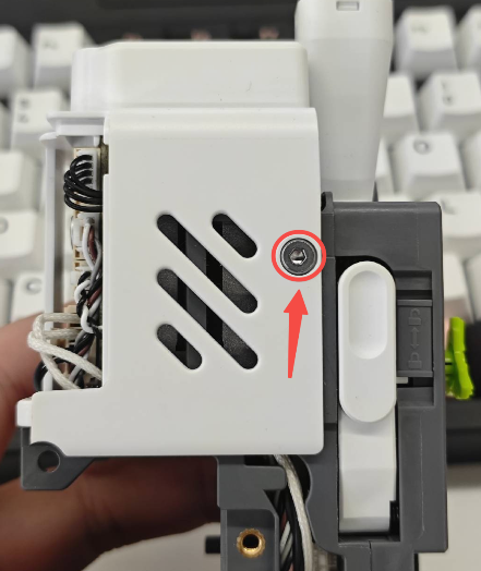

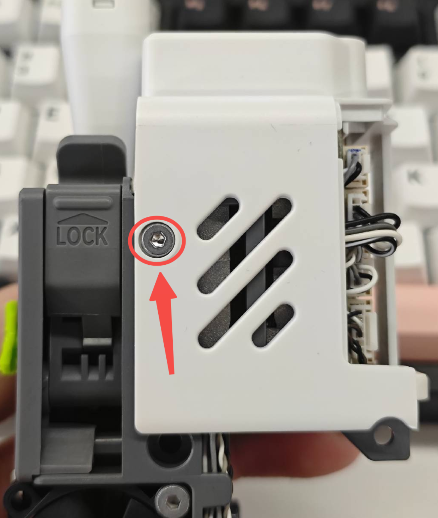

Use the H2.0 hex wrench to unscrew the two screws on both sides of the Toolhead Rear Housing, then lift and remove the Toolhead Rear Housing.

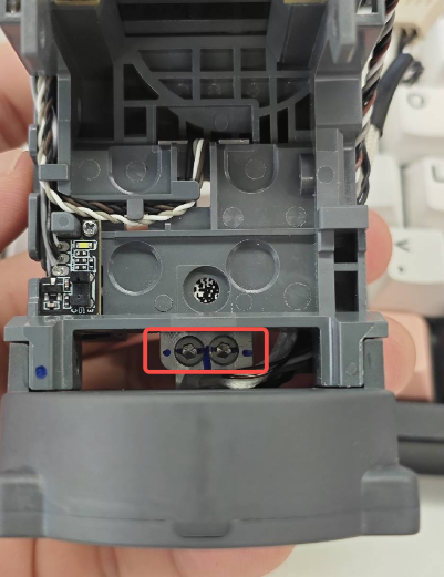

Removing the Hotend Heating Assembly and Part Cooling Fan Assembly

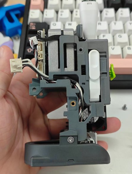

As shown in the figure, unplug the connectors of the Part Cooling Fan Assembly and the Hotend Heating Assembly, and carefully remove the cables from the cable channels.

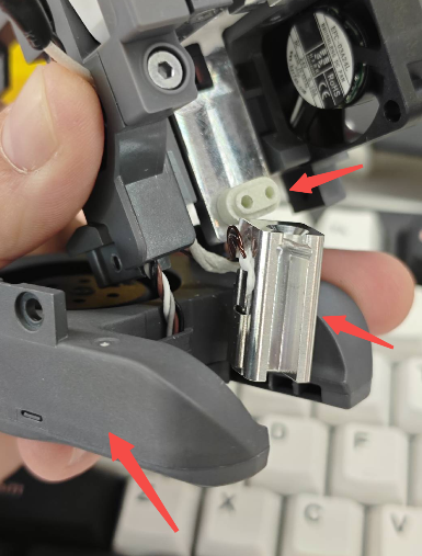

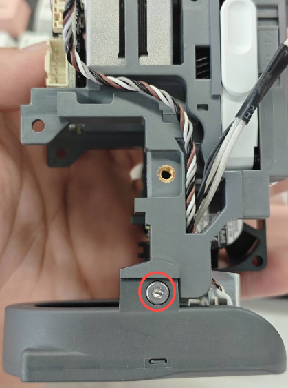

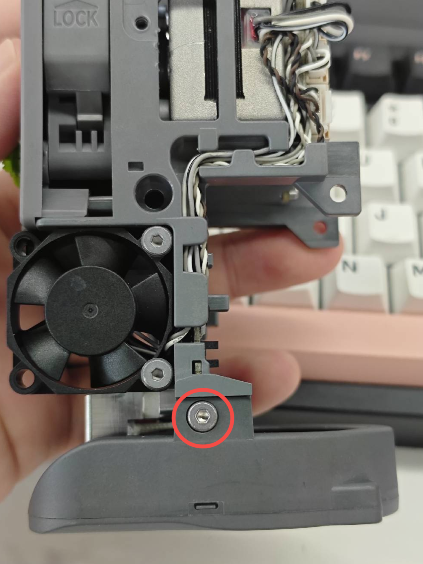

Unscrew the two screws on the back of the Hotend Heating Assembly to release it.Unscrew the two screws on both sides of the Part Cooling Fan Assembly to release the fan.

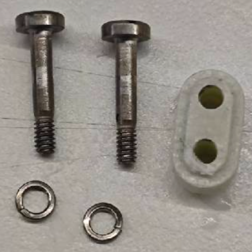

With both the Hotend Heating Assembly and the Part Cooling Fan Assembly loosened, you can more easily remove the Hotend Heating Assembly. Note: Do not lose the insulation block or the screw washers of the Heating Assembly.

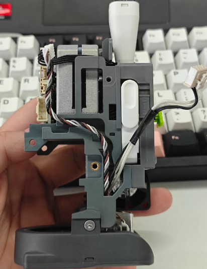

Route the Part Cooling Fan Assembly cable back through the side hole and organize the wires neatly.
Prepare the new Hotend Heating Assembly, first pass its cable through the side hole. Make sure the cables for both the Heating Assembly and the Part Cooling Fan Assembly are properly arranged, and do not forget to install the insulation block.
Secure the Part Cooling Fan Assembly and the Heating Assembly with screws. Do not fully tighten the screws of the Heating Assembly yet.
Insert the quick-release hotend back onto the toolhead and snap the latch to ensure it is properly seated. Then fully tighten the two screws of the Heating Assembly.
Arrange the cables of the fan and Heating Assembly neatly in the cable channels, and plug them into the corresponding connectors on the Toolhead Board.

Mount the toolhead back onto the X-axis of the i7 and secure it with screws.
