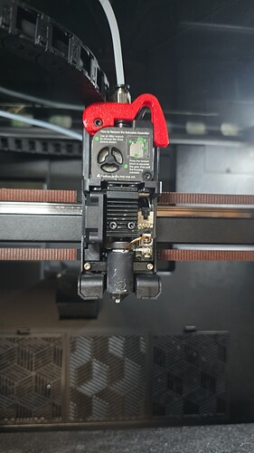

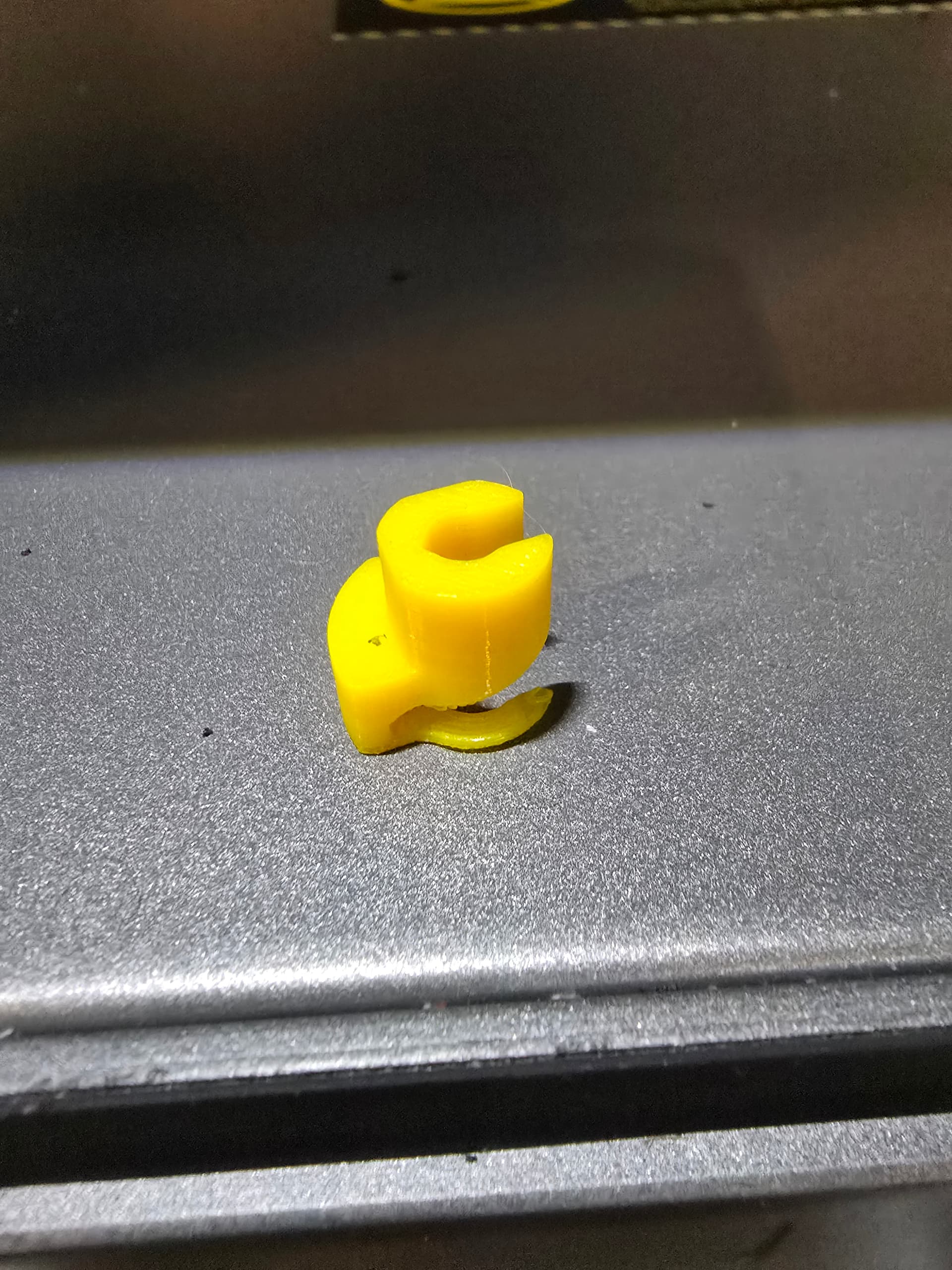

I’m on the old extruder and have ongoing problems with the PTFE tube where it attaches to the extruder. The Creality strain relief helps a little. I’m having a bad search day. Could you link me to the community mods to use pc-m4 / m10 ones?
THX
There are many, but these 2 i personally printed and used for a while, so know they work
https://makerworld.com/en/models/1039198-creality-k2-plus-extruder-ptfe-m10-pneumatic-mount?from=search#profileId-1058707
The strain one is more for protecting a working front cover extruder connector… the above is for when its completely gone and doesnt hold ptfe any more

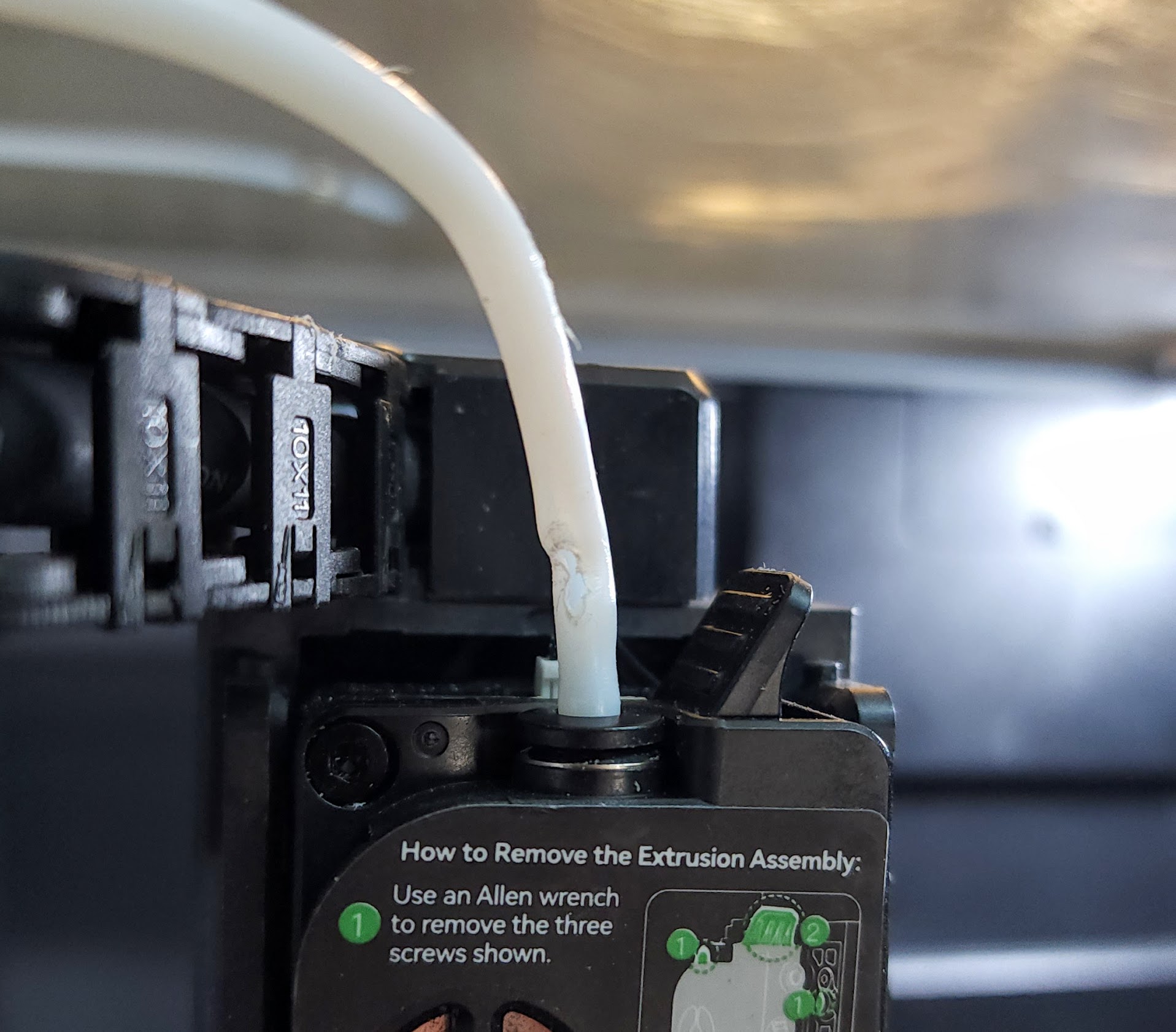

Thanks! The bottom one is the one I use. It helps a lot, but the Bowden tube keeps wearing out at the top junction.
This pix is with the strain relief removed.
Ever with the strain relief in place It looks like the Bowden tube is getting heat and friction damage. Note how the tube bows in just above the attach point. Also curious that the hole is on the inside of the curve, as if it was actually caused by the strain relief plus heat.
I’m wondering if the revised extruder diverts more heat away from the Bowden tube junction.

It’s probably a number of things…
Blobs of the end of the filament being dragged back through to the CFS, heat, angle…

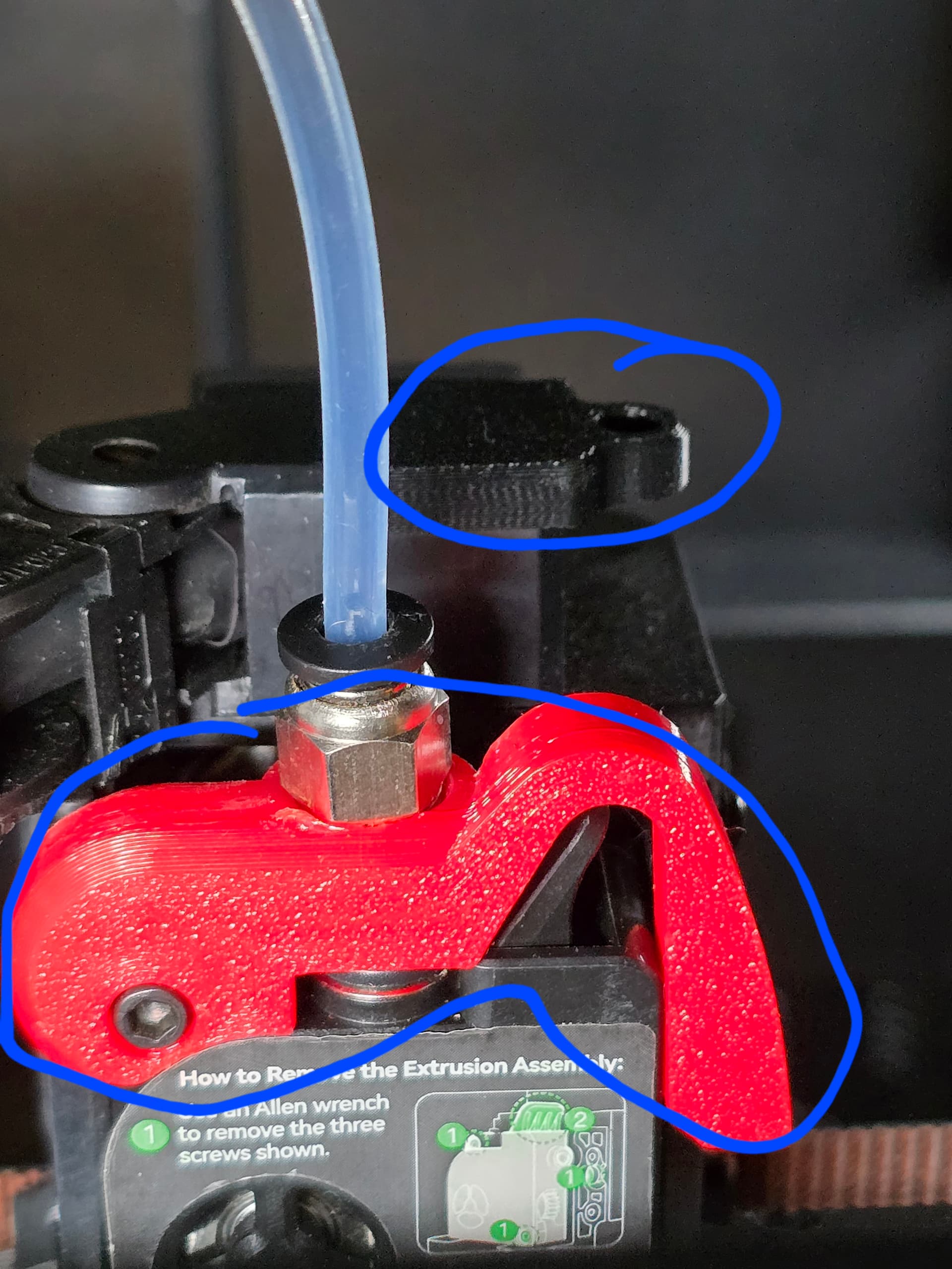

Actually all the more reason to use the photo above with the red print…as that has an m6/m10 higher up and provides a longer “straight” run to the gears… so should help prolong PTFE, and the connector is easily replaceable.

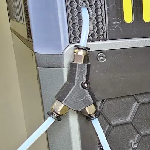

with the ptfe spacer-insert, modified as a 2 or 3 way splitter, like this without the need for M10’s or M6’s, to reduce the height..
the idea is that I’d be able to continue to use the CFS via 1 splitter and have the other always there to easily / quickly insert side spool filaments without having to pop off the PTFE tube all the time, thus not chewing up PTFE tubing quickly by repeatedly swapping out PTFE between TPU printing vs normal printing, which i’m doing (or swap out extruder front cover)..
any f360 experts out there willing to design that for me ? i’ll get there, it will just take a few days, someone who does this day in & out could probably do it in 5 minutes.

Doing away with the need for these 2 im currently using
