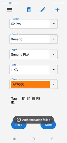

Hello Guys is any one having issues when writing to the RFID tag? I got the same exact tag and im getting an authentication error when trying to write. any help would be greatly appreciated.

Hi! thanks for the warm welcome :slight_smile: . I did use this video as guidance, I even used another phone to test with the same thing Reading is not an issue but Writing is.
I found out the issue the first 2 tags are dead …..:sweat_smile:
Thanks for getting back to us with that information. That’s an interesting discovery and shows that some of these RFID tags may be defective, although it seems unusual for two of them to fail.
Are the app and RFID stickers working correctly now?
I’m also curious whether anyone else has experienced this issue.
Yes, the rest of the RFID tags i have used are working just fine. I managed to write 6 spool with out issue. When The second tag failed i was like there is no way it the tags.
