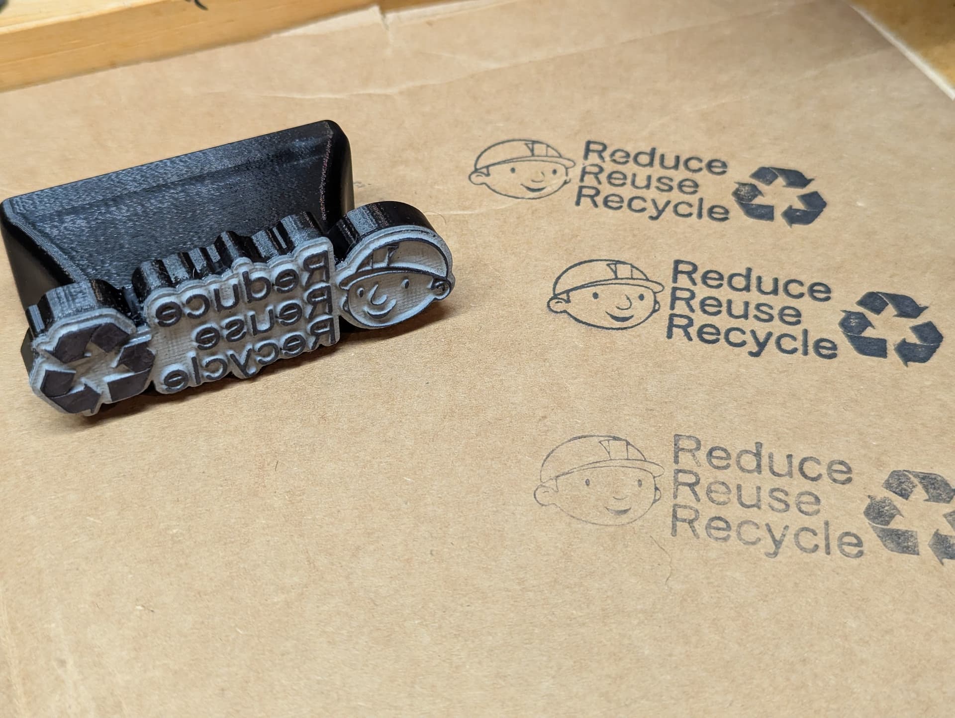

Has anyone tried making rubber stamps with their Falcon A1? If so can you please provide me with the settings and a little how to info. Most of YouTube videos are more powerful lasers or CO2 lasers. Thanks

On my 40w Falcon2 Pro, I use:
Fill, 1200 mm/minute at 50%(20 watts) - 1 pass
Line - cut out stamp after fill is done - 900mm/min at 50%(20 watts) - 3 passes(could probably do less)
Works well:
