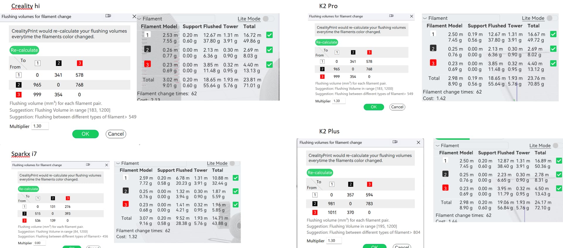

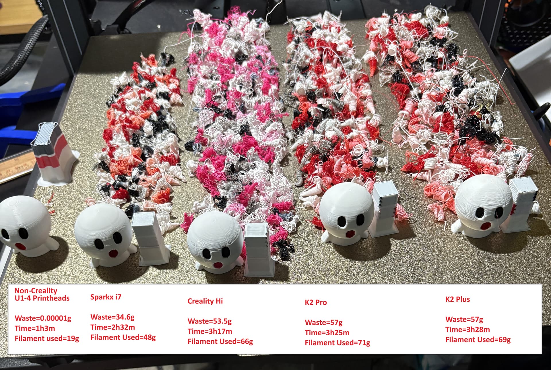

Recently I did a post with comparison of filament waste when multi-color printing. I learned that I did it wrong (Flush volumes were not updated when I changed the printer).
So now I did a comparison between 4 of my Creality Printers (Creality Hi, Sparkx i7, K2 Pro, K2 Plus) as well as 1 non-Creality printer that has 4 toolheads. Hopefully Creality will soon come out with such a printer.

  1. Assuming you start with the correct default multiplier for different printers, fine-tuning the flush volumes – which takes some testing to accurately dial in the correct amounts for each printer.

Results of testing. The Sparkx i7 does indeed produce less waste when the correct Flush Volumes are used. In my test it was between 61% to 65%. Probably due to the shorter nozzle on the Sparkx i7. Note the 3 other Creality printers all have the same nozzle length.
All the numbers are in the attached pictures.
The model I used was one of mine.
