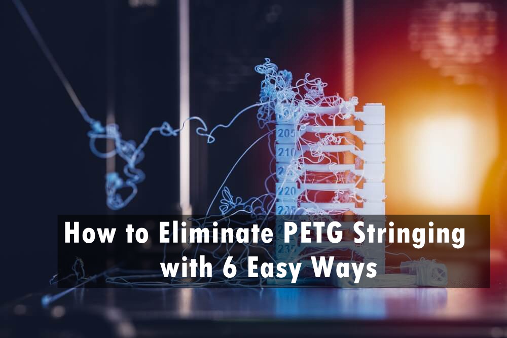

What is PETG Stringing?
PETG stringing occurs when the printer extrudes excess filament as it moves between printing areas, leaving thin strands or “strings” that mar the final print’s appearance.
This can be due to various factors, from printing temperature to filament moisture. Understanding what causes PETG stringing is half the battle; next, let’s tackle how to fix it.
How to Eliminate PETG Stringing with 6 Easy Ways
1. Nail the Retraction Settings
Retraction is crucial in combating PETG stringing. When the extruder moves between print sections without depositing material, a retraction setting pulls filament backwards, preventing oozing. Key to PETG success is finding the proper balance in retraction distance and speed.
  • Retraction Distance: Start with a slightly higher retraction distance than you would with PLA. Experiment by adjusting in small increments, typically between 4mm to 6mm.
  • Retraction Speed: A moderate retraction speed works best for PETG. Begin at around 40mm/s and tweak as necessary, observing any changes in stringing behavior.
