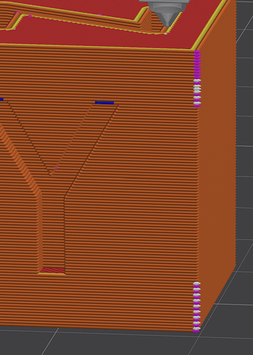

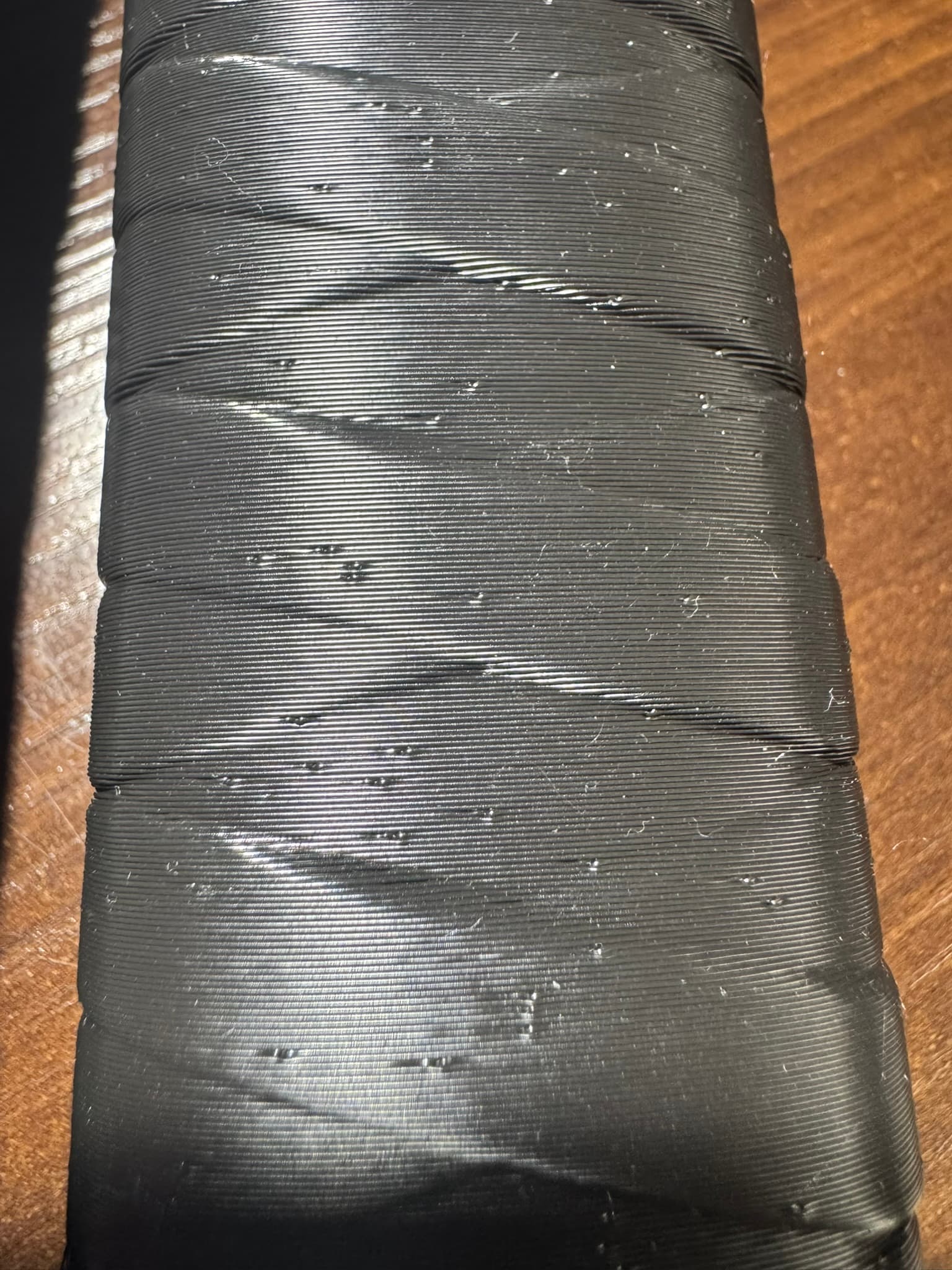

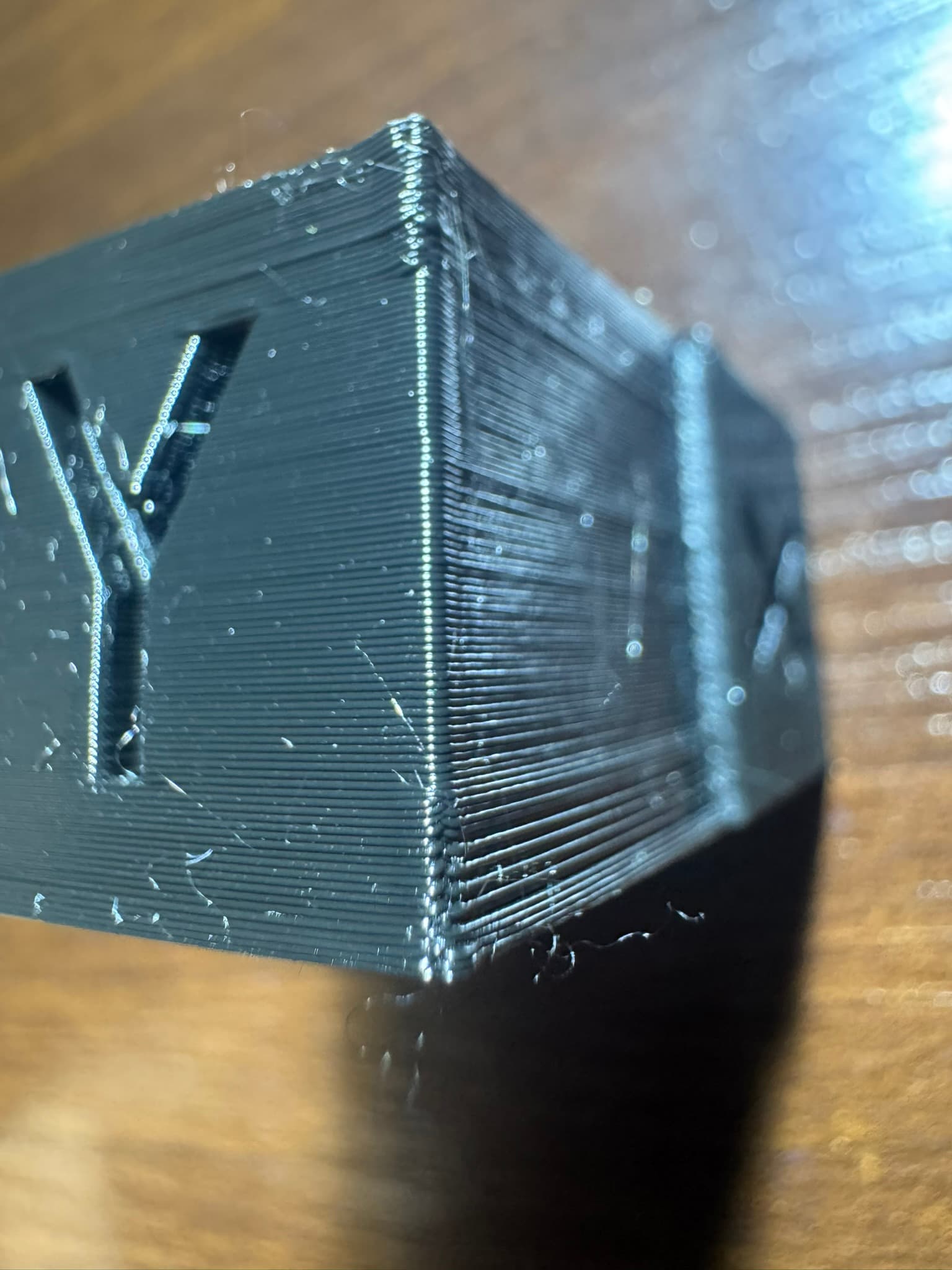

Until I print katana sword I didnt seen the problem. I have an Ender 3 V3 Plus. At the seam points my printer makes gap. That gap size no comes more smaller by changing values on creality print. for a time I tried Cura also, but no any difference. I was using on printer V1.2.3.21 then I tried 1.2.3.8. Software from V7 i downgrade to last V6. I do seam gap %0. Even I tried -2%. I changed retraction values. smaller and slower. I used PLA silk, PLA and PETG. Contour I used but been worst, some layers been like ballon. I open extruder, its full clean and fine. Belts I adjusted to be sure. All the bolts I checked. I dont know what to do anyomore.
Is there anybody can help me about it?

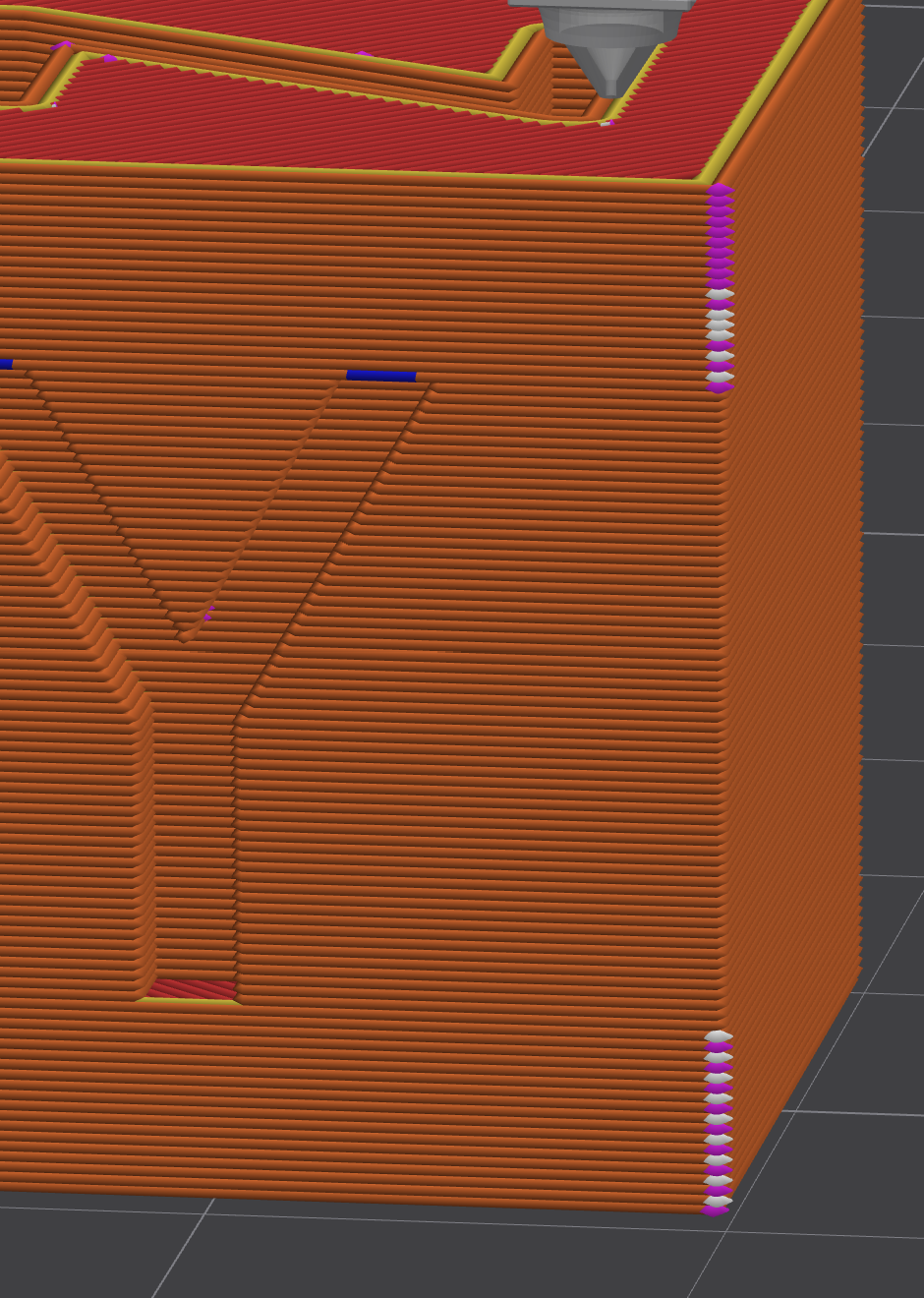

recractions on some lines (lenght 0.8mm - z hop 0.4mm - speed 30mm/s)
recractions result on some lines
seam position is random

https://www.youtube.com/watch?v=EG18RhFUq6Q I found solution like that. result quite cool.
