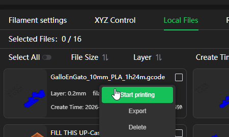

By example, on Creality print, go to the device, then to «Local Files» tab, upload or select a file to print, right click on the name and select «start printing»

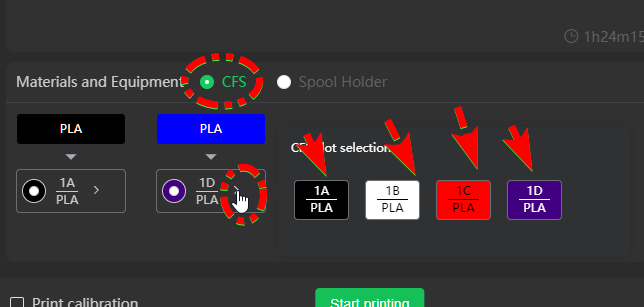

A new dialog is shown and you can select the origin as «CFS» then for each color you can click on the « > » symbol at right of the color. a dialog showing the current spool slots is shown and you can select the one you like, then if the material is compatible you can start the printing by clicking «Start printing»

Thank you for your reply. Sorry for the delayed response but it has taken me this long to understand what you meant. A lot of messing around later and I finally get it, for the software - I choose the colour along the top that is the colour of the model as shown in the picture, and select below it the filament I want to use. I’m still not getting it to work on the printer but I’ll keep trying!
