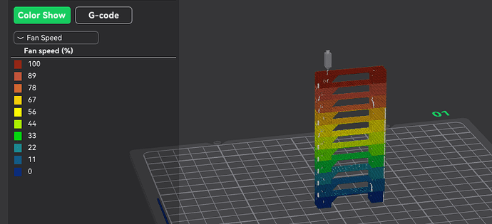

How to set the fan speed?
There is a calibration model for testing the fan speed. There the speed increases from 0 to 100%. How is this done?
Have you checked the g-code? There should be something like this:
  • M106 S0 → fan off
  • M106 S64 → ~25%
  • M106 S128 → ~50%
  • M106 S192 → ~75%
  • M106 S255 → 100%
    If not you can slice and look at which layer the fan speed should increase. Then you raise the fan speed to this value in the cp6 software interface on the device section, where you have the camera of your printer (if your printer has a camera). There you can control model fan and side fan with a slider. Or you can do this on the touch screen of your printer, but when I remember right, there the layers are not shown on the display. Well, best would be of course if the change is done automatically by the g-code. Don’t know what you wanna do refers to the model fan or side fan, do you?

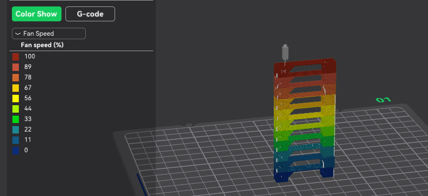

I found how to split the calibration model into parts. But I don’t know how to set individual fan speed settings for each part via CP6 interface.
