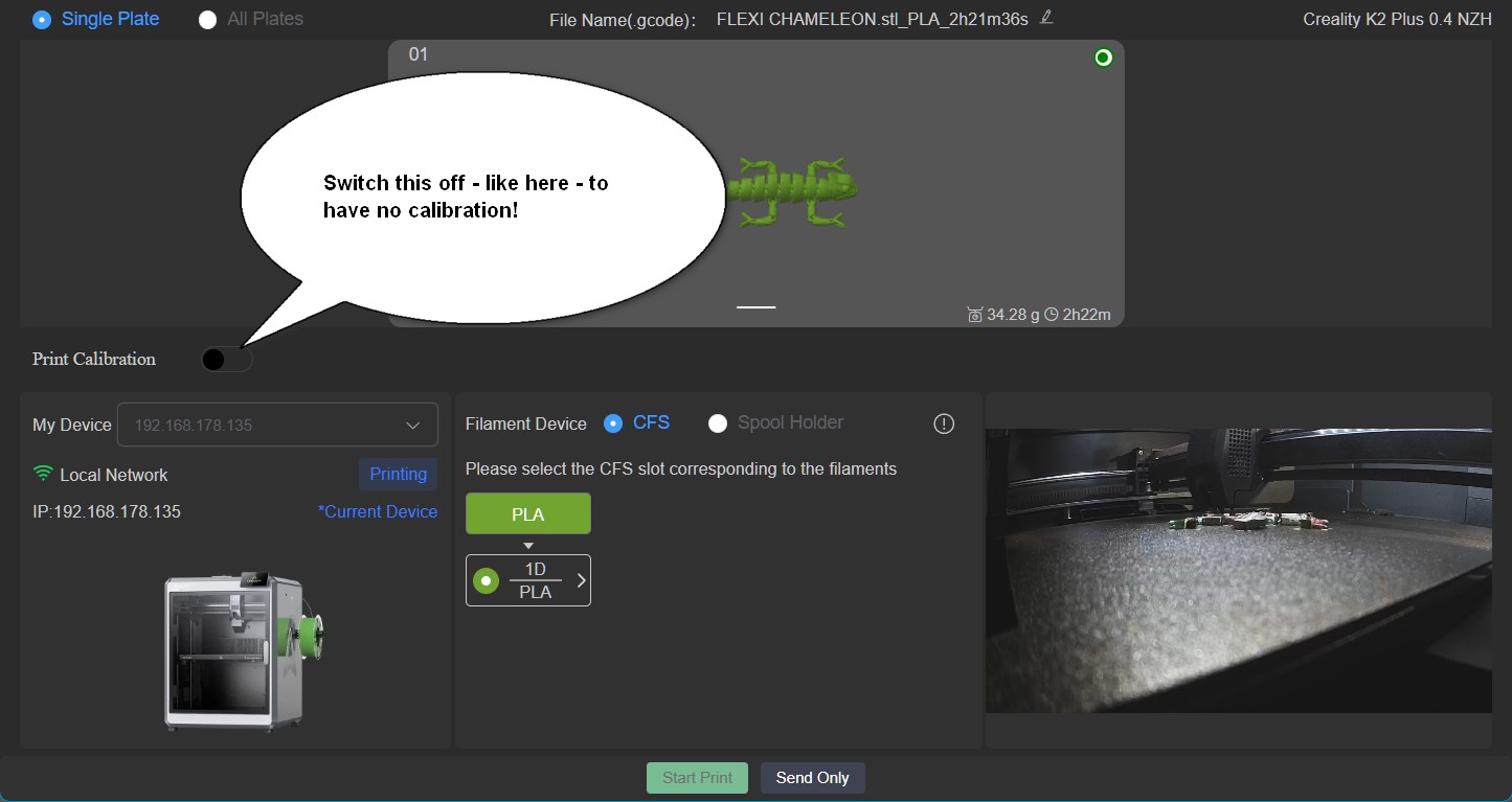

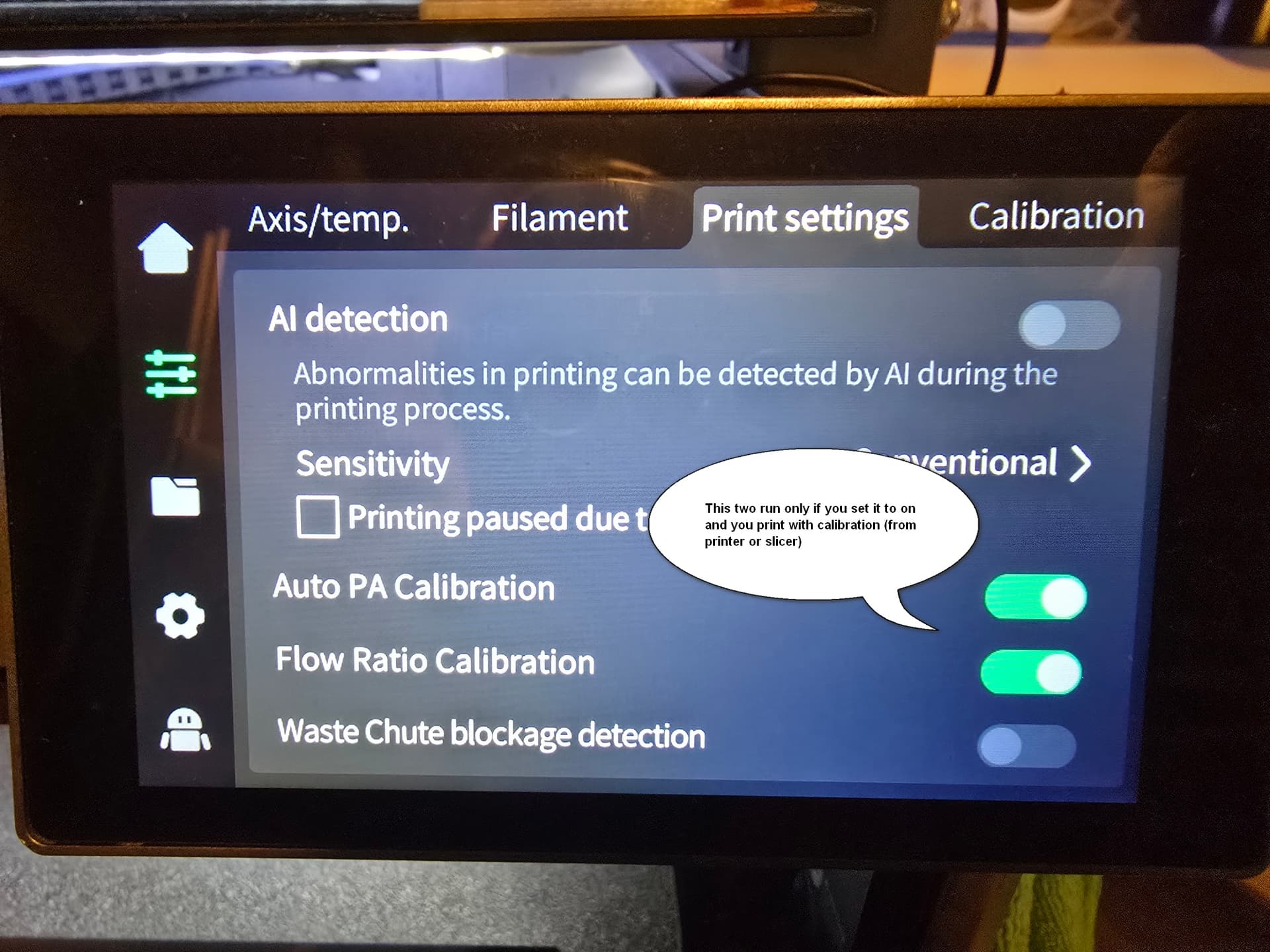

On Printer you need to switch it on here
and when you set then calibration when sending print or printing them they sill be done!
If you switch above on then all 3 calibrations (Bed mesh, PA and flow rate will be run on this print.

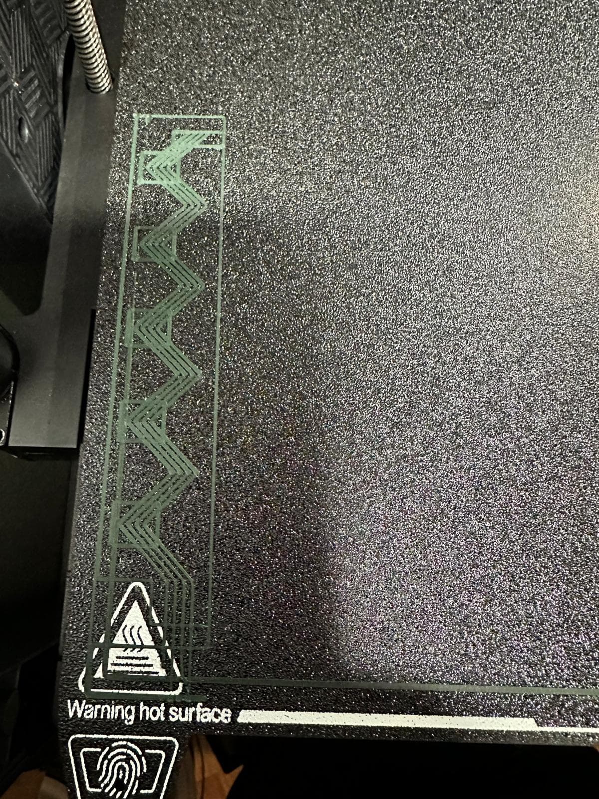

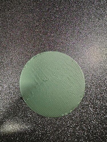

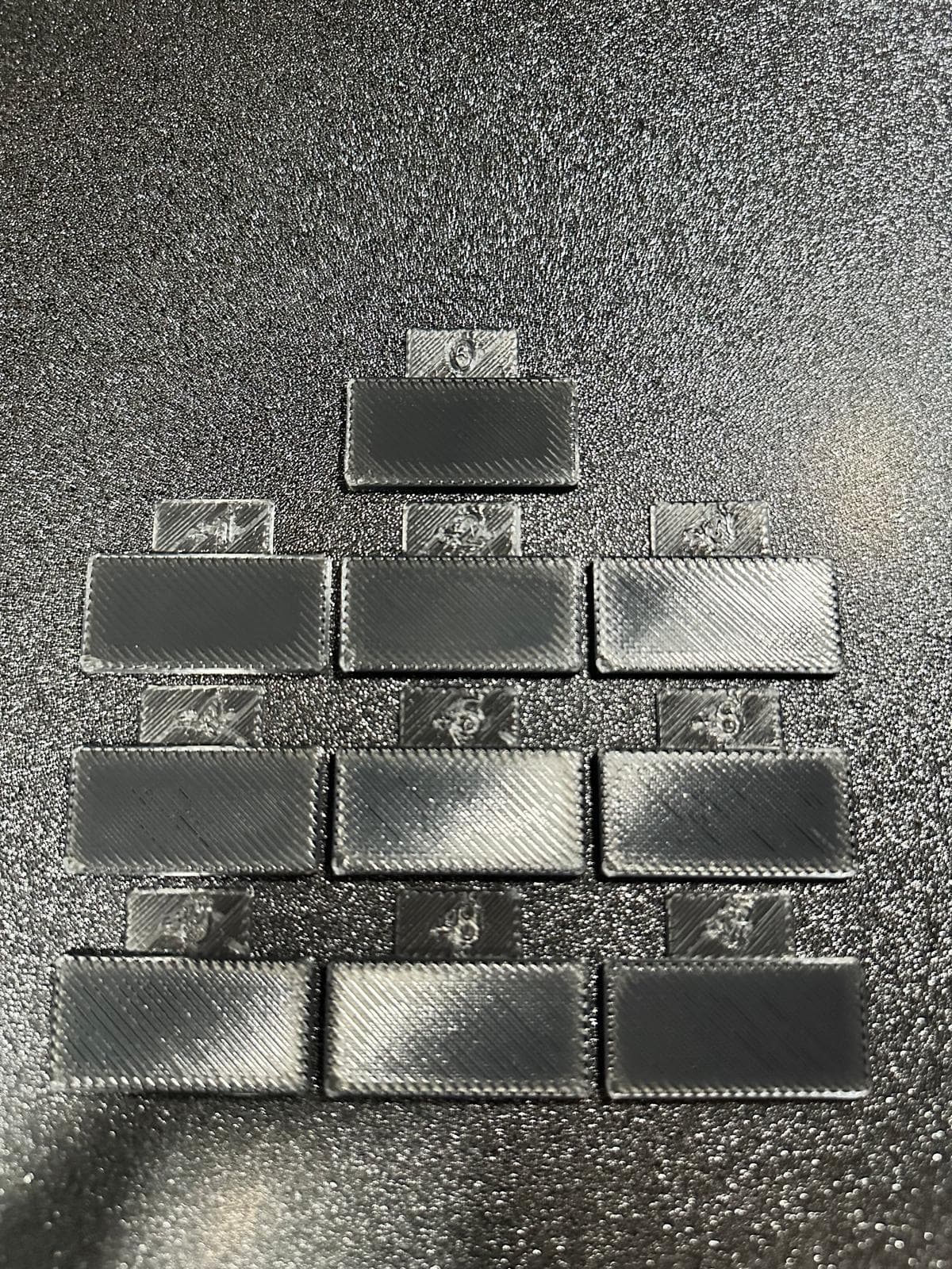

I’m sorry frank, forgive me but if I don’t enable it on the machine - does enabling calibration in creality print not do anything worthwhile? Or do I disable calibration in creality print on that print screen above, and only enable it on the machine itself? Sorry, I just want to be sure I do this properly. Also, here is flowrate pass 2:
Interestingly, on the printer both flow rate and auto PA were enabled. So every time i’ve printed, and also enabled calibration in CP6 - was that even necessary? Does auto calibration on the printer (not CP6) mean the PA settings in the filament profile are ignored or they take priority?

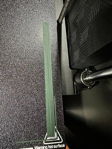

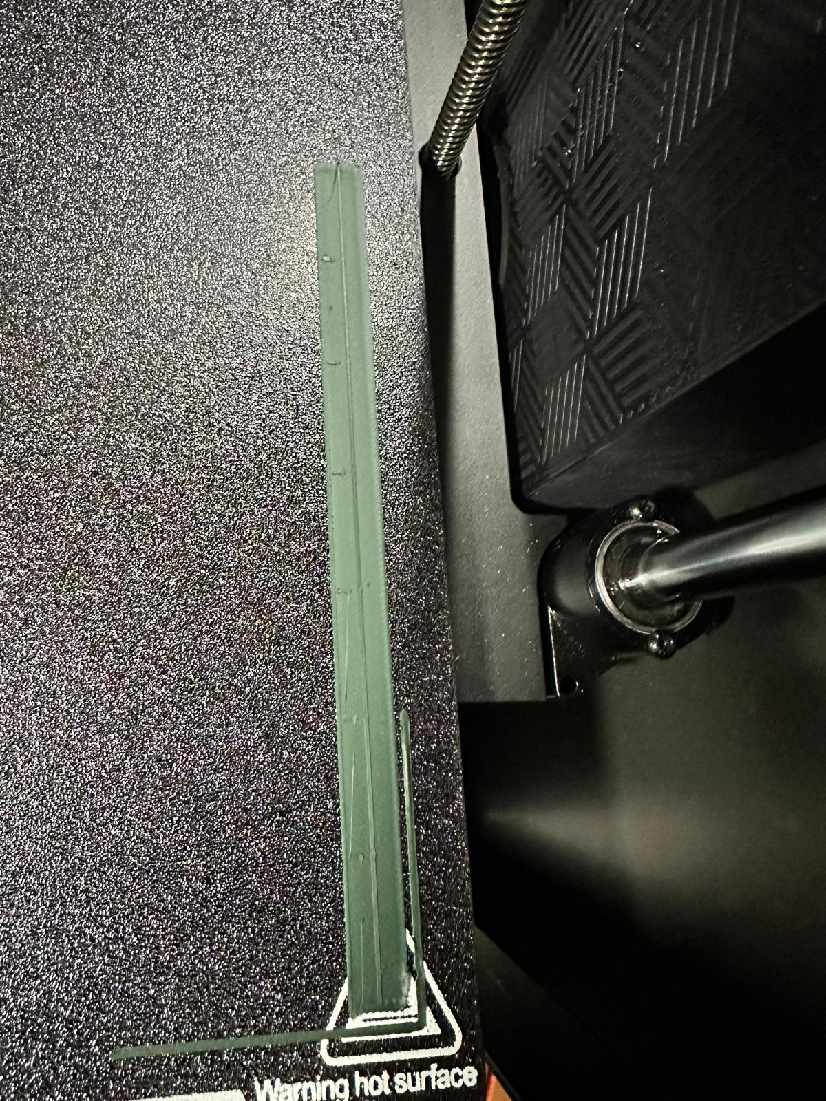

@frankjoke here are some pics from me following your steps in your new roll calibration thread. It’s a brand new roll of Erryone matte dark forest green PLA, only I had to choose creality CR-PLA in CP6, I didn’t see any ‘generic’ one otherwise. If you spot anything, please feel free as always :slight_smile:

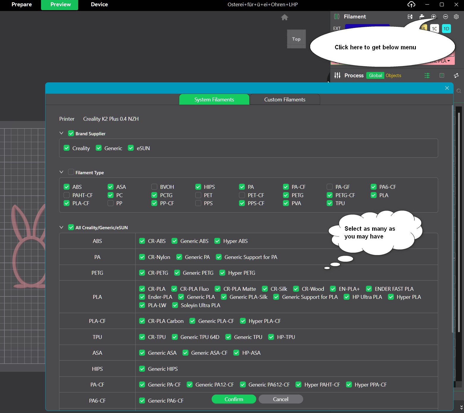

Maybe you did not import them, see below how to import needed system settings:
The cog on the upper right side in CP6 shows the menu (after a while after CP6 grasp the info form their servers).
Ah I found the issue - somehow my 0.6mm nozzle was a user preset, not system, and I couldn’t gain access to those until I added the nozzle under the main printer settings again. Thank you! :slight_smile:

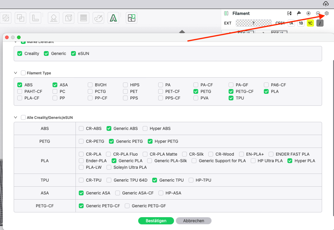

I was/am printing mainly multiboard tiles as well as some panels (300mm long) out of PLA-CF and PETG-CF. I was able to cut the print time down by 50% nearly. I also found filament profiles for many of the vendors in C:\program files\creality\creality print 6.0\resources\profiles - but even when clicking File → Import → Import Configs after selecting the configs and CP6 tells me it imported - I don’t see those filaments in the dropdown, or in the list to enable. Are you familiar with this by chance?
Take a look at this, at the top right under Filament you have a cogwheel, here you can then select all the filament types you want to use, as well as the generic.

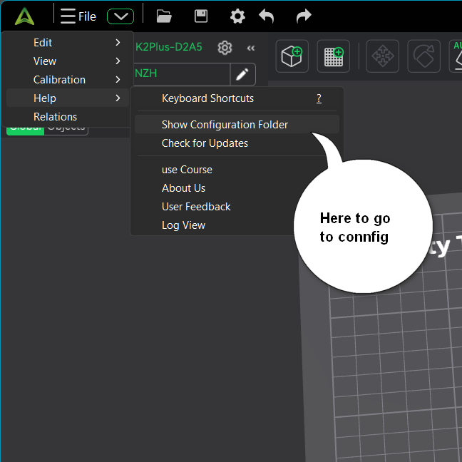

My filaments are in different location, I reach it by
in there I have a System C:\Users\%username%\AppData\Roaming\Creality\Creality Print\6.0\system and C:\Users\%username%\AppData\Roaming\Creality\Creality Print\6.0\user\default\filament directory where my filaments profiles are stored in subdirectories for different printers.
p.s.: Using CP 6.0.5.1840

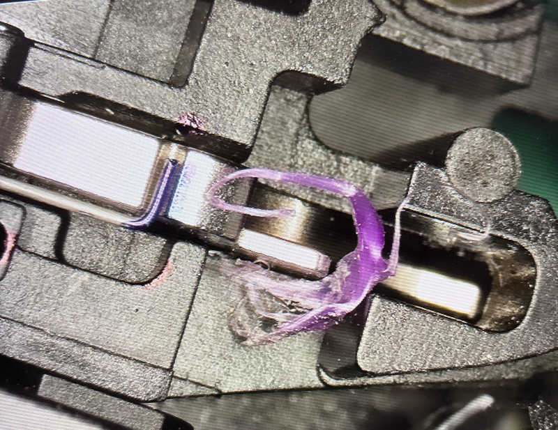

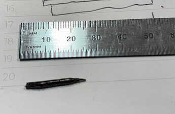

After a few hiccups with each filament type the K2 is printing PLA, ABS, PETG, and PC just fine. The one filament I’m still having probs with is ASA. About every 2-3 prints it clogs the nozzle and when I warm pull the filament I get this - see Photo.
ie a fattened slug on the end of the pulled filament.
I’ve see this before on filaments albeit not so long. It looks like the filament is softening up too much before it gets to the heated section of the extruder?
I checked the printing filament temperature as I just accepted Creality_Prints default value and it says 260ÂșC which is 20Âș higher than the max recommended printing temp on the side filament spool.
Just wondering what folks who print with ASA use.

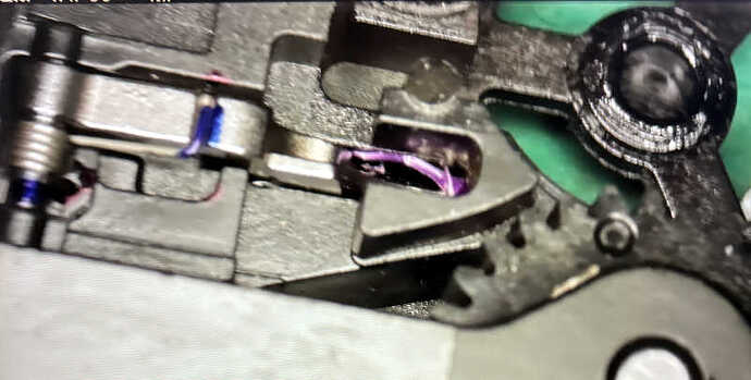

Found the problem - nozzle not blocked but a small fragment of old purple filament caught up in extruder filament sensor. I don’t understand how this was not a constant problem because the last time I used Purple filament was about 2 months back

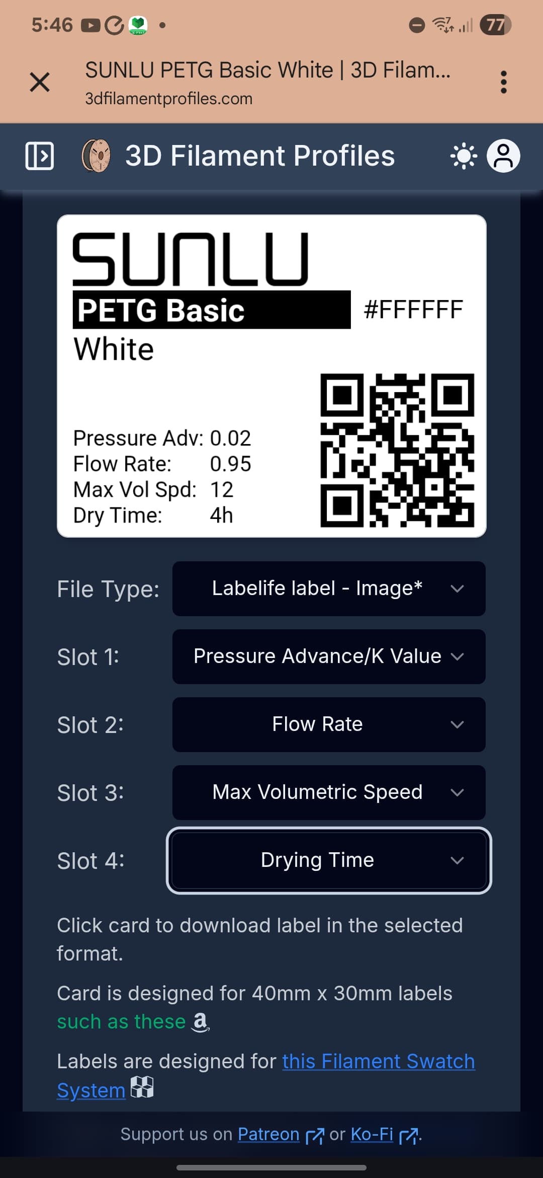

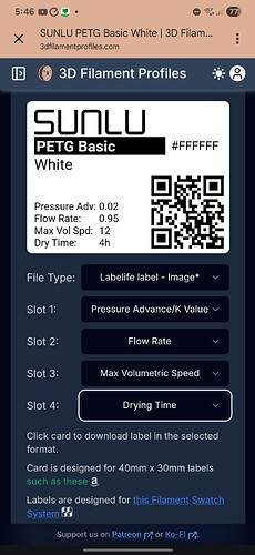

I’m kind of late tot he thread. I ran across this web site dedicated to sharing printing settings. Thought it might be useful to the group and a nice database already set-up for filament settings.
https://3dfilamentprofiles.com/
Bookmarked !
That’s very useful cheers just printing some labels
