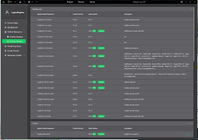

Dear all, Creality updates and changes printer and filament profiles over time. On CP6 there is a page where you can update the system profile to the newest version:
If you click on the creality logo on top left of CP6 and the select Online Params you will find the list, select the printer/nozzle combination you use and the see if there is an update button. If yes, run it to update to latest version as they are not updated automatically when you update the slicer!
I look every month on this page and update for the 2 printers/nozzle types I have (from Creality).
By the way, your user profiles are not changed but the new System profiles overwrite the defaults in there which you may not have changed.

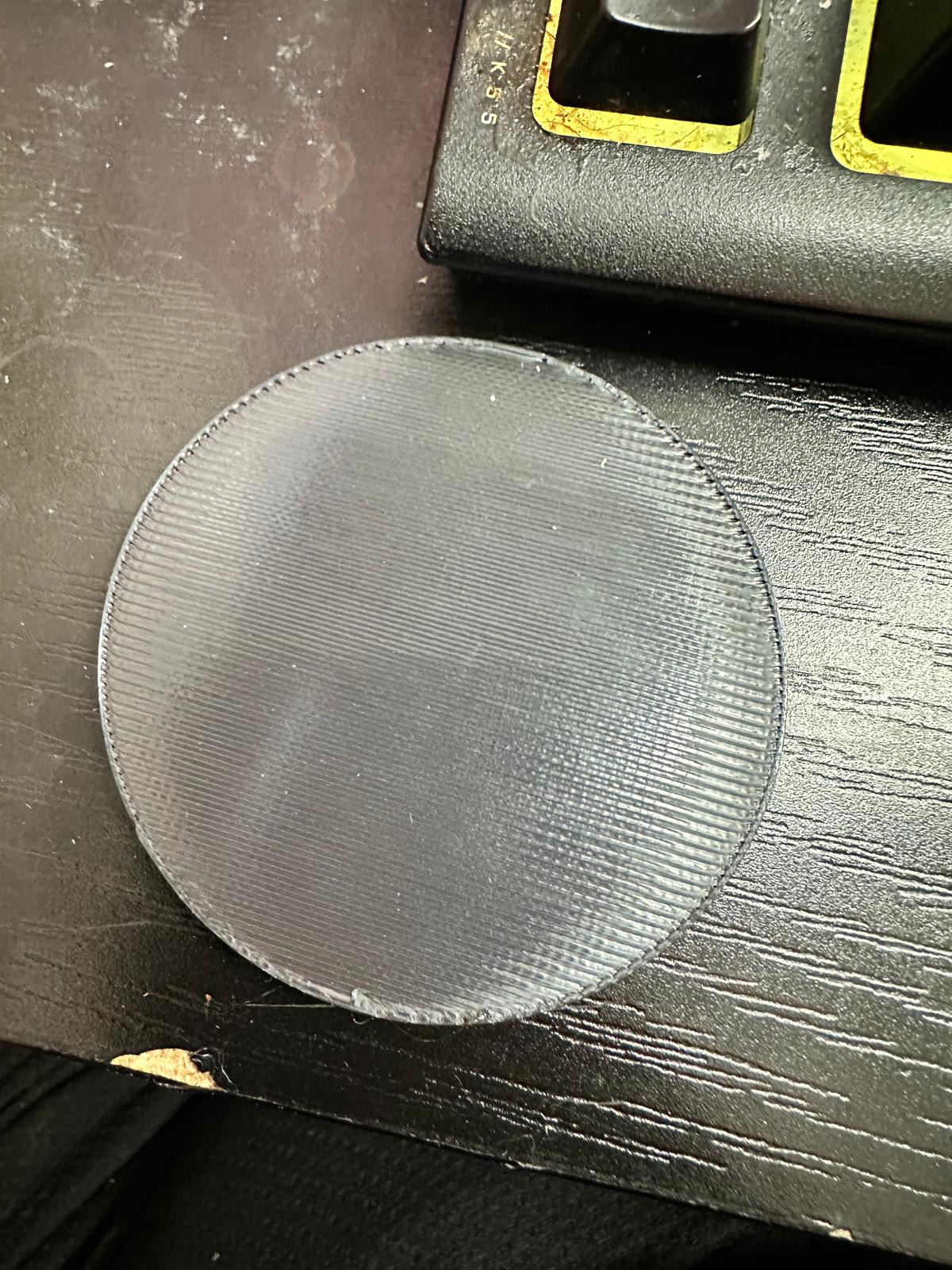

Filament brand: Sunlu
Filament type: PLA-Silk
Filament color: black
Filament profile: stock CR-Silk
Nozzle size: 0.6mm
The only setting I have enabled that is outside of anything ā€˜basic’ or ā€˜stock’ in creality print is ā€˜small area flow compensation’.

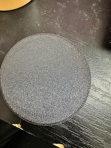

What was layer height and how many layers are this?
Did you use calibration for the print?
If there are >2 layers then top surface would lead me to adjust flow rate but on one or two layer prints you cannot really see correct flow rate.
Layer height: 0.3
Walls: 2
Top shell layers: 4
Bottom shell layers: 3

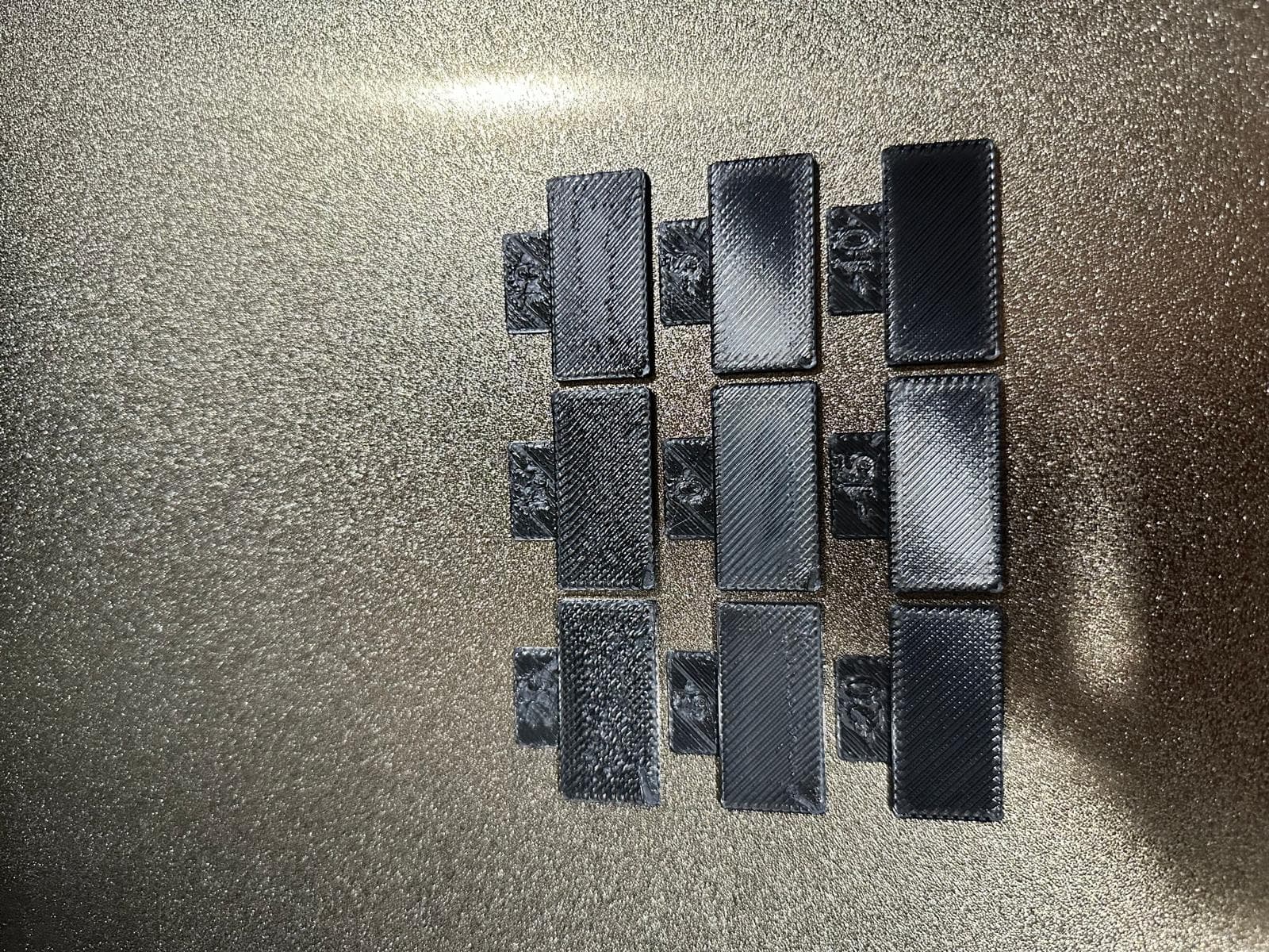

Here is pass 1 of the flowrate from CP:
I trust your wisdom and eyes way more than mine at this point @frankjoke if you would :slight_smile:
Oh, you went the hard way! I used this test only once in last 3 month because the K2 flow rate calibration produced no results on a white silk filament. I usually use only the method I describe here because it’s much shorter and you could have done it within printing this first disk you showed.
In your case I would go with -5 for the 2nd step!
