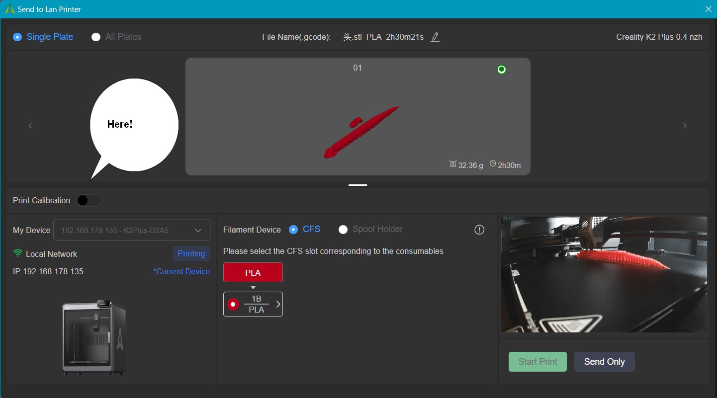

First, thanks for the info. I have been playing with the calibration routines in V6, and there is not much difference from Orca. I have not figured out how to send it to the printer without going to the printer and turning calibrations off at the front panel. Is this the only way?
Could you be more specific on the above statement? I want to continue using Orca for both my printers.
@txrpls : You can add & assign colors in Orca to #1-n and the print will use slot 1-n for it.
When using CP6 you can re-assign the slot numbers before sending and you can also set a flag for calibration.
This options you do not have when using Orca to send the file to the printer. You have to be sure that the right filament is in the right slot upfront and have to enable calibration manualy on the printer.
Thank you.
I have looked high and low. Where is that flag? Thanks in advance.
Well cr*p. didn’t even think about looking there.
