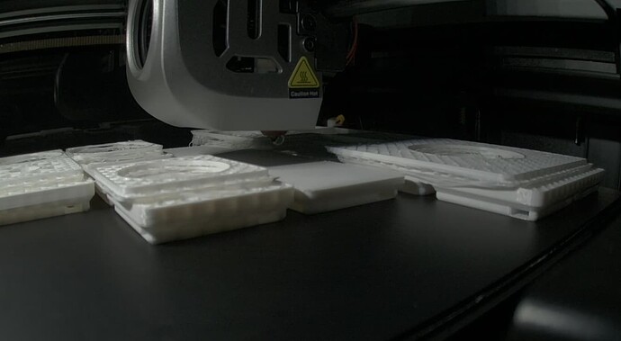

I’ve had the K1 for a year now. 3 months ago I had to change the extruder circuit board and that’s how I installed the successor model of the extruder.
Everything was working great until 2 weeks ago. Suddenly I have shifts in the layers in the middle of printing. Is this perhaps a defect?
If I had changed something I wouldn’t be surprised.
I tried this with different filaments. Always the same result.
Any tips? Or does the K1 only last for 1 year and is then so worn out that it causes such errors?
Did you ever find out the cause of shifting layers? My new K1C (late Dec. 2024) did this initially on large perimeter jobs. Now, almost every job fails. I hear what sounds like a belt slip, then the print continues offset. I have to STOP the print. The error log shows Warning key:2001,Unknown exception.
Hey, I have exactly the same issue… All belts are fine, bed is fine, everything is as it should be. I even changed to using OrcaSlicer and it was OK for a print or 2 and then reverted back to this (as your pic displays). Lets hope we hear something from someone. I’ve been looking at all sorts of blogs etc but nothing seems to work. … In hindsight perhaps I should have gone for the Bambu Labs P1S…

I’m having this issue too all of a sudden on my K1C. The printer was fine with all types and sizes of prints. Then just a few days ago I started having this problem. Somewhere mid-print it’s like the whole layout gets shifted 10mm to one side (or maybe it rotated?). The other day it was the first layer and this time I was about 3/4 of the way through a 4 hour print when all of a sudden things untethered. The first time happened with a print from Orca Slicer, beta 2 I think, and this time I started the print from 6.0.4.1794. I guess I’m not clear how much if at all Creality Print trails Orca Slicer.

Me too, started yesterday. 40-60 layers into a big (200x190mm) print, a loud CRACK and a layer shift of at least an inch in both X and Y. This doesn’t seem like a belt hop, it wouldn’t hop that many steps. Tried Creality Print 5, 6, and Orca, same thing. Rotated the print, same thing. If this isn’t fixable, it’s going back.

I finally got back to this over the weekend. It likely was the belt tension, I followed the tensioning procedure tuning both belts for 110-120 hz tones in the Gates app and now it is back to printing accurately, even on 8-10 hour prints.
This is exactly what needs to be done. Ive had this issue with the K1 since day 1. Creality needs to step up and support their products or stop producing this crap. Enough is enough
i had this issue i posted in another section, but it turned out my k1c was over heating becasue the bottom plate was poorly made and no exit vents for the air to flow through, my temp after i found the layer shift and stopped it was around 56c, i removed the feet and plate, and on another printer i made feet extensions and a fan mount for the mcu, i reran my print on my K1C a 7h 23m part keep checking the temp of the bottom area and came out just fine, before i had done this it had a layer shift before so this is what happend to me i hope this might be helpful to anyone with this issue i had and FYI im making my own bottom plate… with proper air vents…
