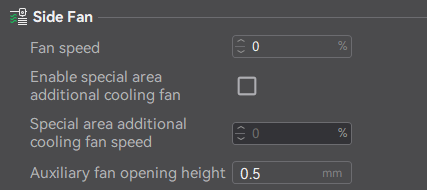

With my Creality K2, I am using my Side Auxiliary Fan to move air round the enclosure during heating.
I turn the cooling feature off selecting side fan 0%
I then turn the fan on manually in Fluidd or use a modified gcode gcode_macro M141
The side fan runs then turns off.
I inspected the print gcode and Creality Print is adding “M106 P2 S0” in three places, this turns the side fan off.
This occurrence is not a problem as I turn the side fan on after this.

With the side fan deselected there should be no occurrences of M106 P2 S0

I apologise, I didn’t understand the software, I have been trying to sort this for over a week.

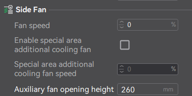

To stop the fans turning off in addition to selecting Side Fan Should 0%
You also need to set Auxiliary Fan Opening Height to your maximum build height, in my case 260mm
This prevents the Creality Print is adding “M106 P2 S0” in the middle of the print
I hope Somone will find this useful in the future
