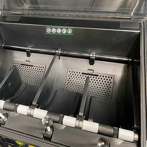

I made a simple but huge upgrade to my Creality CFS setup and wanted to share the results.
I’ve been fighting humidity levels sitting around 25–30%, which isn’t terrible—but definitely not ideal for filament storage. So I decided to print some attachments/mods for the CFS that add additional desiccant capacity.
What I Changed:

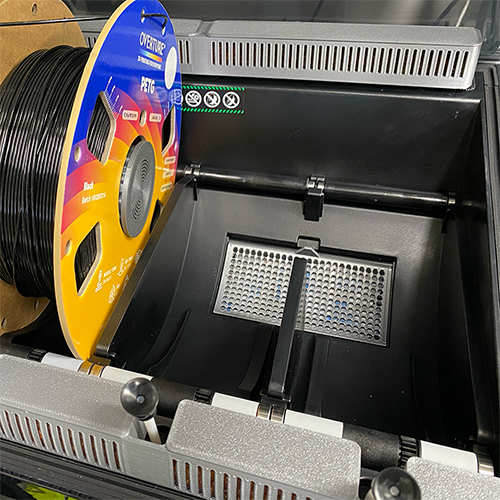

  • Replaced the stock desiccant chamber lids with removable, easy-access desiccant boxes
  • Added multiple extra desiccant holders throughout the unit
  • Printed desiccant holders that fit inside the filament spools (bonus: they add weight to light spools, which actually improves feeding when filament gets low)
Prints I Used:
I used indicating silica gel from Amazon so I can visually see when it needs recharging:
Print & Install Notes:
I printed in PETG for durability reason, but PLA (or PLA+) should work fine as well. I also used double-sided Velcro tape to mount the front and rear desiccant holders. The rear holder does require mounting, while the front one can sit in place on its own. Velcro makes it easy to remove/reinstall and keeps everything secure when swapping spools

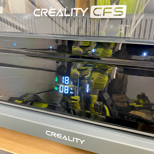

Results:
Before: ~25–30% humidity
After: 8% humidity
That’s a massive improvement, and it’s been holding steady.
If you’re running a CFS and dealing with moisture, this is 100% worth doing. It’s a pretty quick print setup but makes a big difference in print quality and filament longevity.
