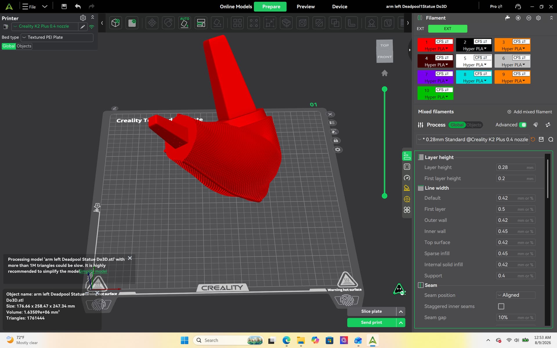

all of model is seen in the prepare screen, when sliced part of the model is no longer there and will not print if printed

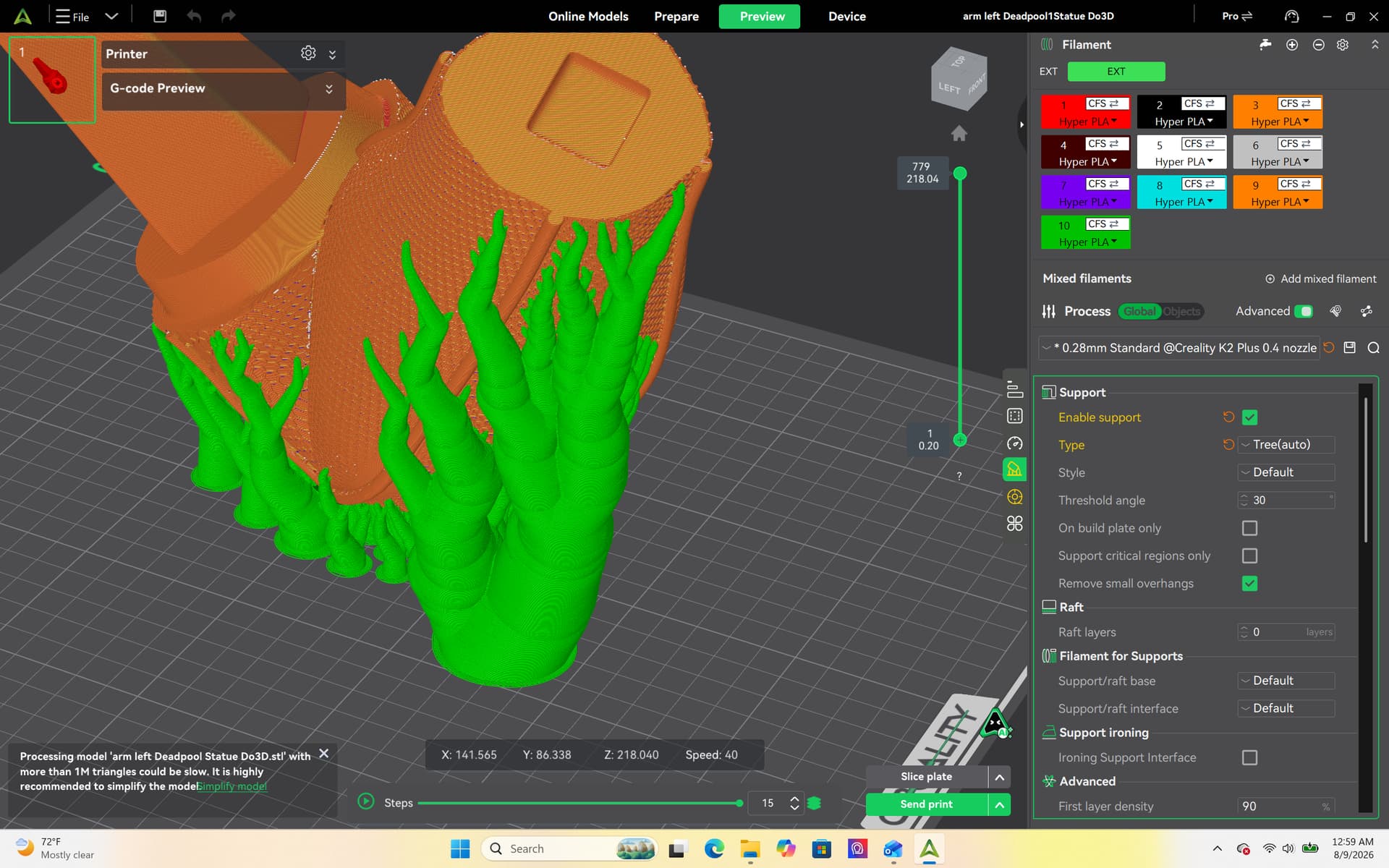

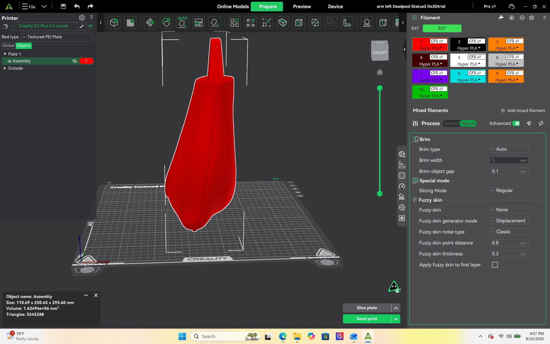

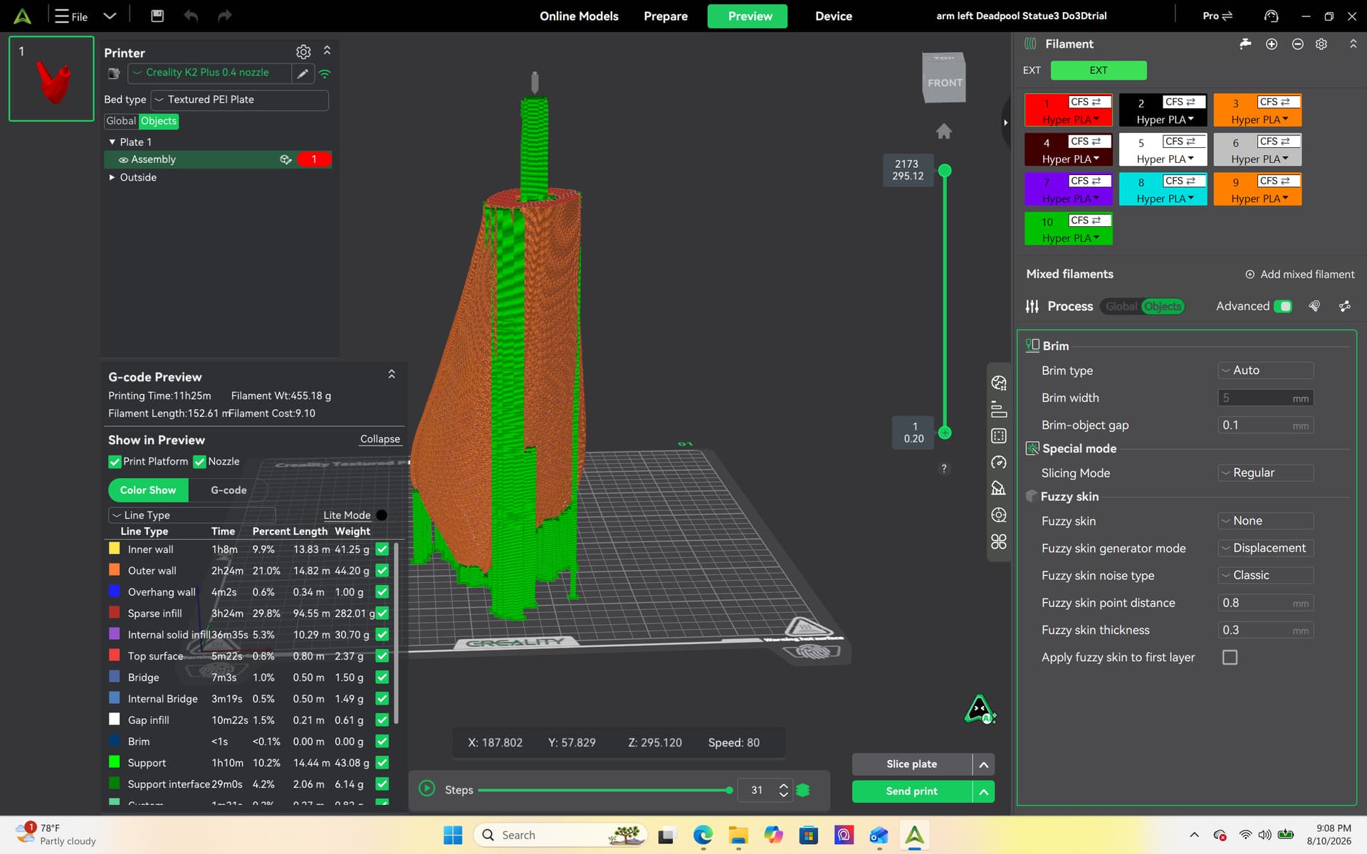

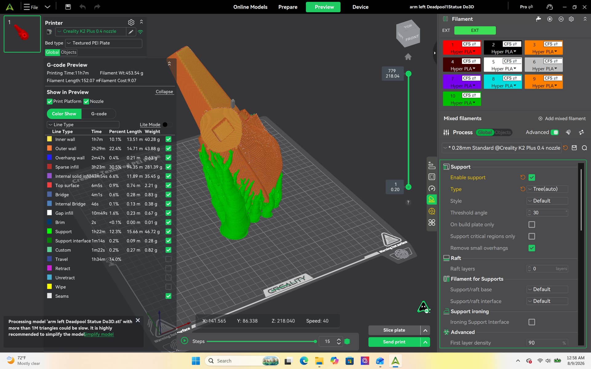

i have attached a before slicing screenshot and a few after slicing screenshots……i have tried repairing the stl, opening it in different slicers, making changes inside the slicer with no luck. The model is lifesize so continously attempting failed prints is getting costly. Lifesize Deadpool BTW
I have never seen anything like it !!! The images below are after a repair was performed. My opinion is I think the file is unfixable/corrupt. The part of the model that disappears after slicing looks as if a mouse has been chewing on it before its sliced. Then after being sliced it puts a support in its place.
