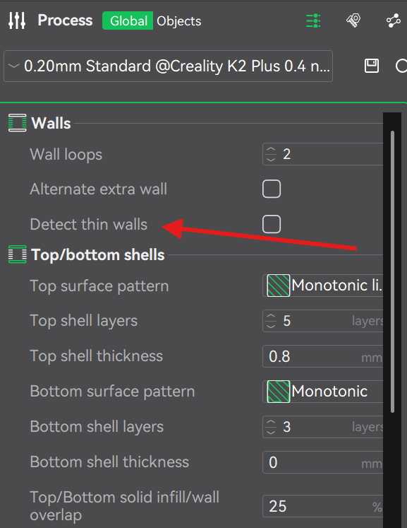

@zinK0 “Detect Thin Walls” in the UI
I haven’t played with these settings (also in the walls menu) but they might help:
”Sparse Infill Anchor Length” I use 200%
”Apply Gap Fill = Everywhere”
Under “Advanced”, “Detect narrow internal solid infill”

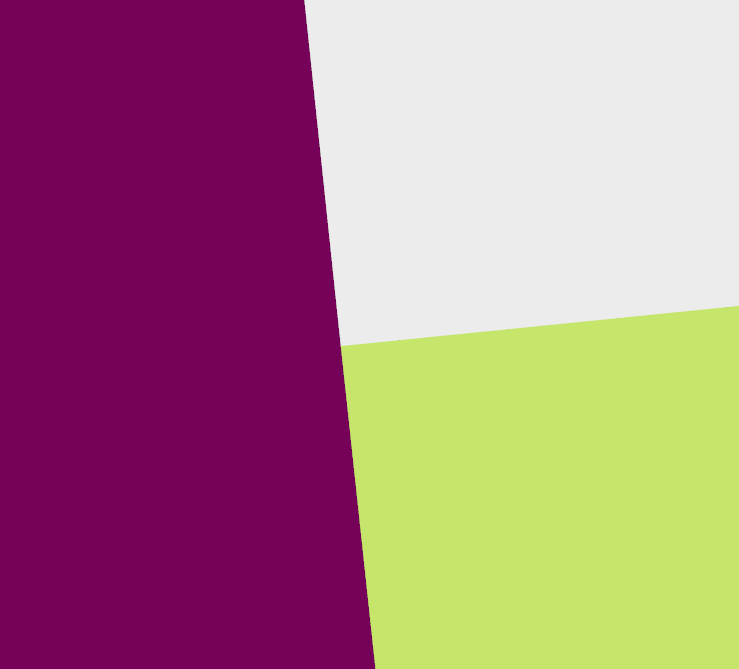

Also, remember the screen render is simplified geometry. It is not what you get in the real world, which begs the question, “what do these gaps look like when printed?”.

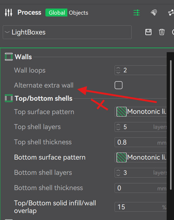

@gozmon Thank you so much for looking into this and offering your advice! I had actually tried using that setting in my custom parameter file. When I searched for it, the parameter appeared in the results, but clicking on it didn’t highlight it as usual, and I couldn’t find it anywhere in the menu. I thought it might have been removed in the latest update, but I just realized that when I search for it while a default system preset is selected, it shows up correctly. Strange behavior — but I guess a picture is worth a thousand words!
Here’s my preset file where that option is missing:
I don’t know how that happened but anyway, I am going to recreate my parameter file cloning a standard preset and will share the result with you.
By the way, this is a close-up photo — sorry about the quality; it was tricky to hold the print and take the picture at the same time. You can still clearly see the gap, though. This is how it appears on the printed object. For context, it’s part of a lightbox, so the gap lets light shine through — which is not what I want.

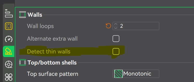

Ok, so the “Detect Thin Walls” option is only available when using the Classic Wall Generator — that’s why I couldn’t see it in my profile while using Arachne.
I’ve now switched to Classic and enabled “Detect Thin Walls.”
Here’s what I’m currently testing with:
  • Sparse Infill Anchor Length: 400% (also tried 200%, no difference)
  • Apply Gap Fill: Everywhere
  • Under Advanced: “Detect narrow internal solid infill” enabled
In the slicer preview, I notice a difference when reducing the outer wall line width, and also that orientation seems to influence how these micro-gaps get filled — depending on the angle, some of them actually close better.
