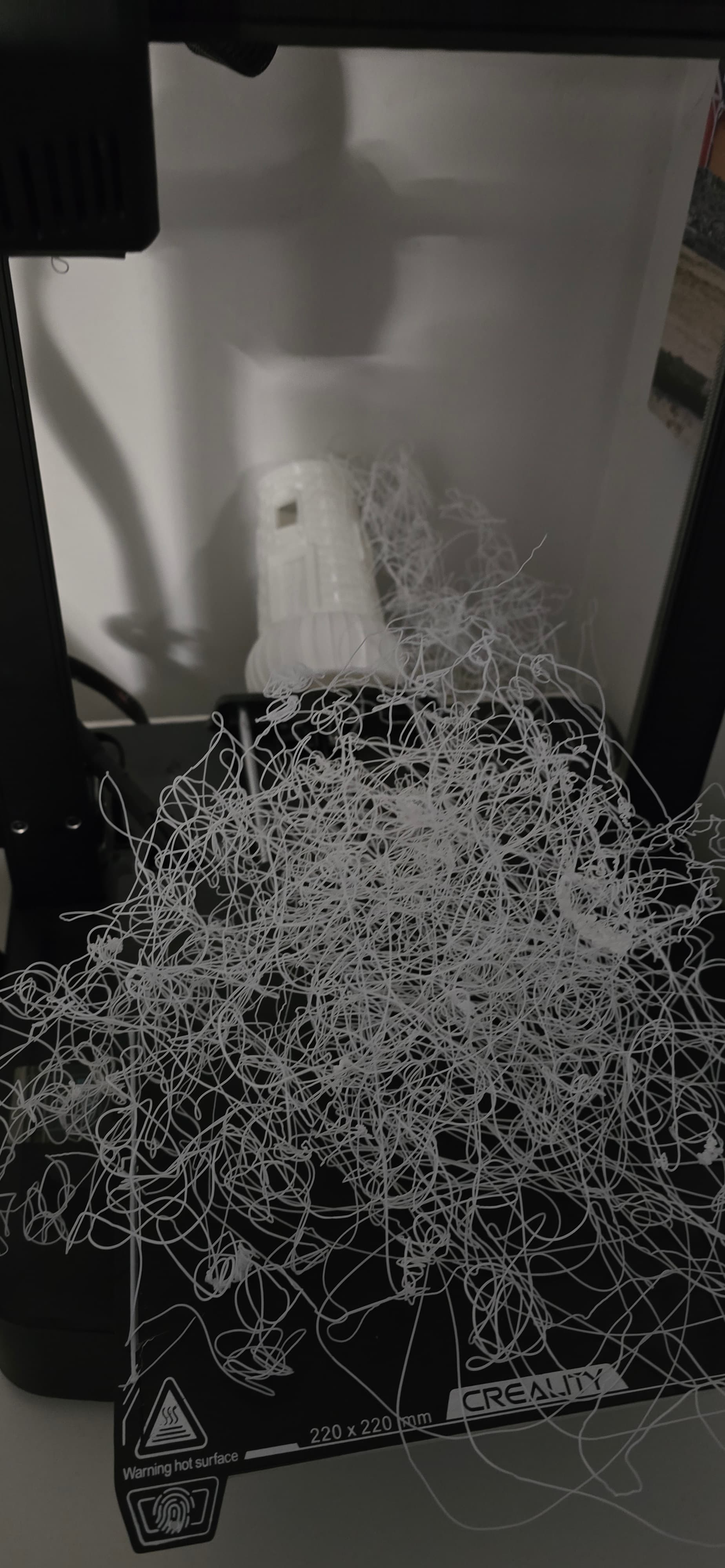

So Fed Up. 6 Months and still cant print

Can you describe the environment of the room in which you are printing, that is temperature and humidity?

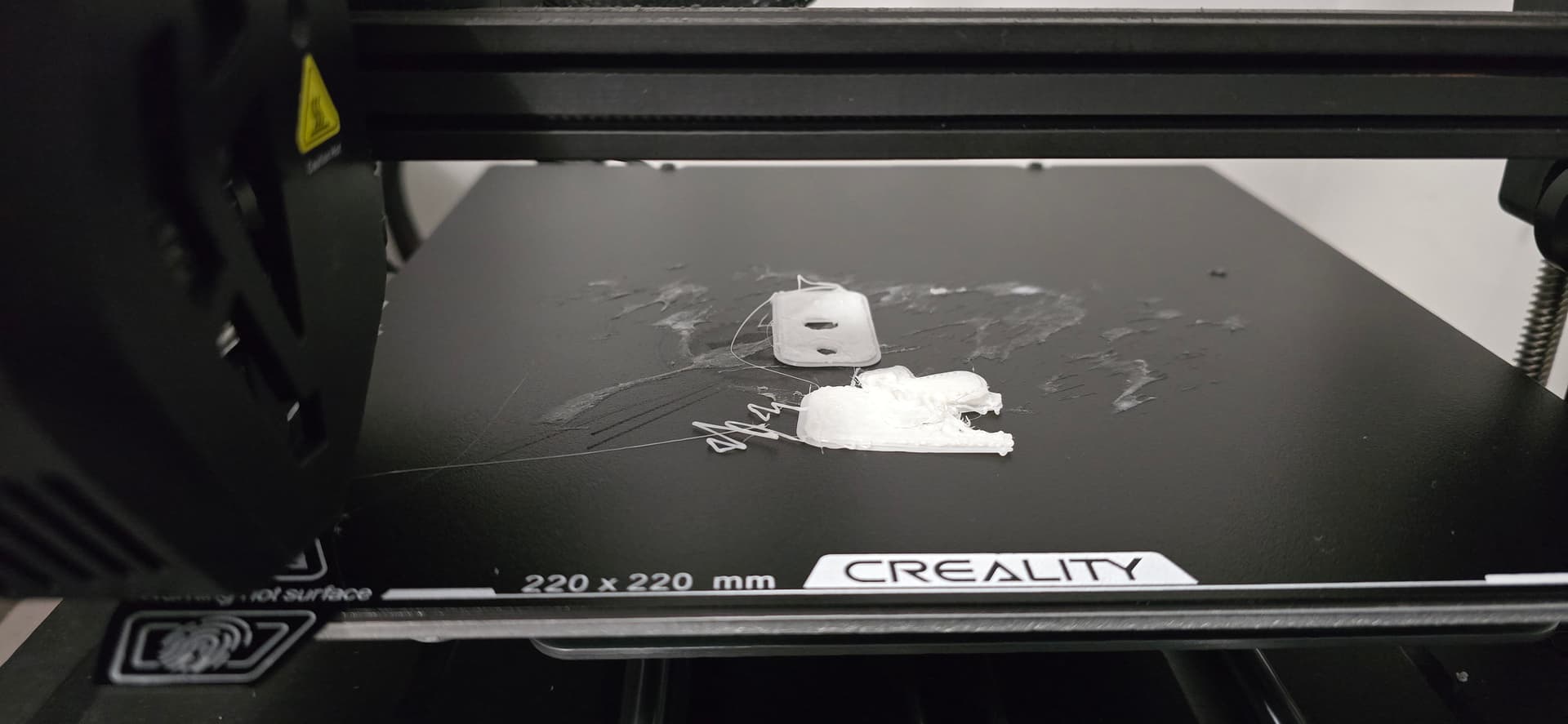

Appreciate all the suggestions from everyone. Am continuing to try but very frustrating. A kind member sent me a ready made file. First layer went down ok but then caught on it and ruined it
Filament can get wet in a matter of days. Many people turn their oven on a put the filament in there for a while. Google “how to dry filament in an oven” and you will see 1000s of videos on how to do this. Its a common problem.
All your photos are a symptom of poor bed adhesion and not the printer itself
  1. Check the nozzle to bed calibration distance. If the printer has auto calibration, run that. If not, use the copy paper method (just google calibrate 3d printer using sheet of paper) or something like that. It is very simple and only takes 2 minutes.
  2. Also, apply adhesive to the bed. Simple kids school stick glue will to (Elmers if you live in the States), although better quality purpose made sprays can be purchased on-line.
  3. Until you become experienced, use only PLA filament as others can be tricky to work with.
You are on your way to 3d printing success. This should be the final hurdle and is not that much of a problem once you understand what is going on.

Still trying to understand your z-offset calibration. You have stated your z-offset as -0.9. Mine is regularly at -3.62. This has little meaning, as it is the distance between the nozzle and the print bed at working temperature that is critical and should be checked before printing.

So I thought I was sorted. Gave it to a guy in work who had a look and adjusted a few things. Seemed to be working. This was a long print about 8 hours. Failed at about 6 hours
The photographs look like a loose slipping belt. When it releases at the base it is a bed adhesion issue. I got tired of throwing prints away and began using glue. When it slips farther into the print it generally means the belts are slipping.
