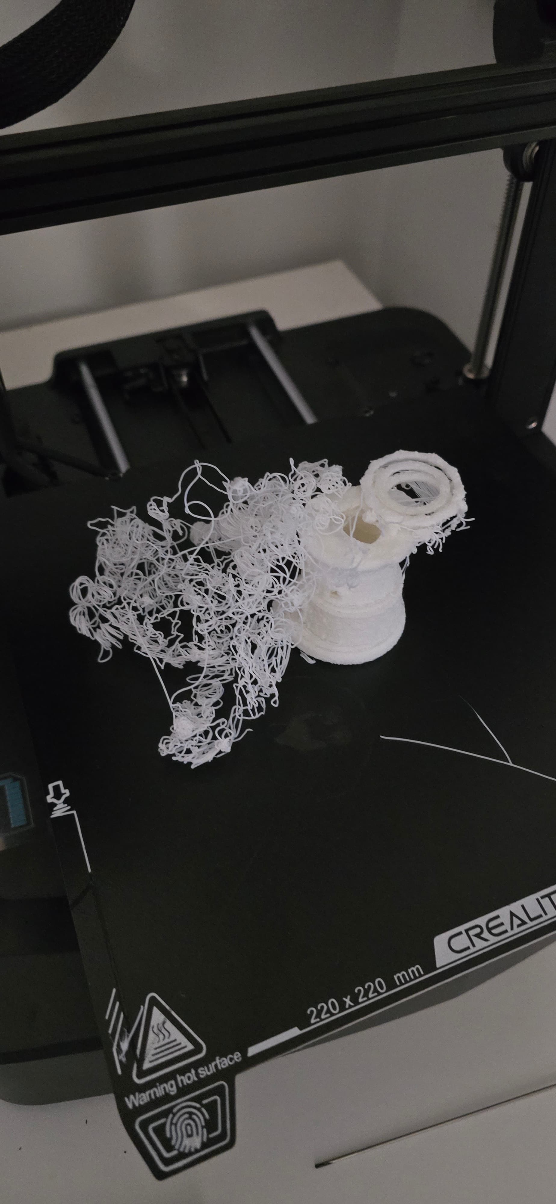

At the end of my patience here. Bought an Ender-3 V3 SE for my kids for christmas last year. Bought it in november and when we built it on christmas day, it was faulty. Creality would not refund/replace it as it had been over a month and thats all you get. They did however send me one part after another until finally, after 5 months which included replaced the power supply, motherboard, hot bed, extruder and some other bits, it finally powered up and seemed to be working.
I managed to print the cat and it came out great but everything after that has been a complete disaster. Ive tried and tried with every setting I can but cant get the thing to print. It either starts dragging the plastic around the bed or if it gets further along it ends up all bubbly and goes off centre.

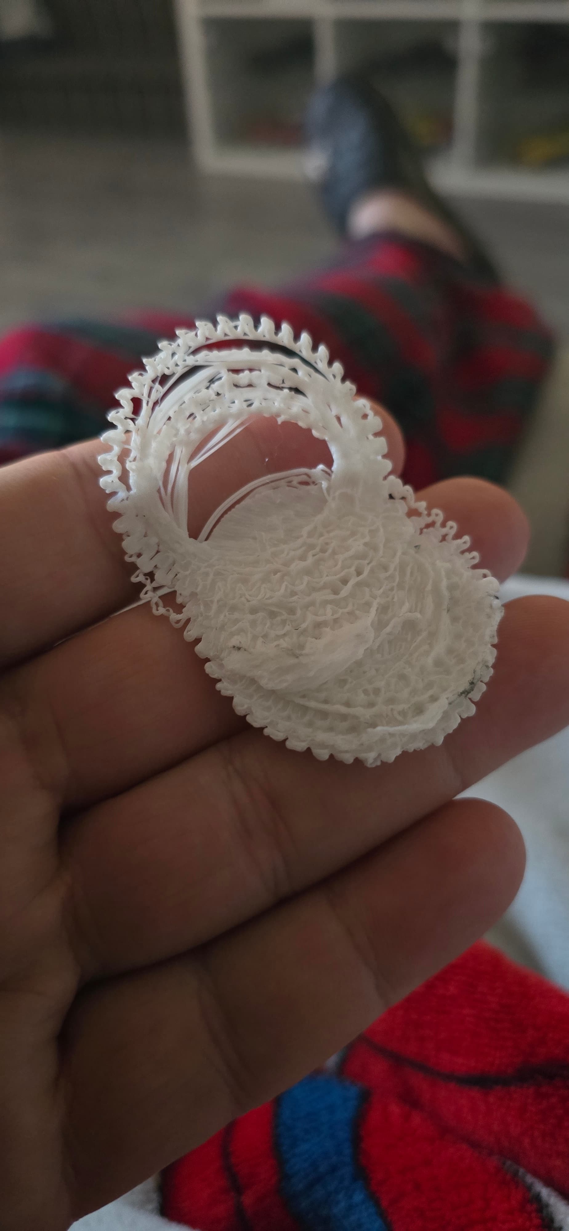

I have dried the filament for a few hours. Fairly confident it’s not that. Trying to print a simple candle holder, it’s getting the first layer down OK then once it gets to about 3% it starts dragging the print along with it.

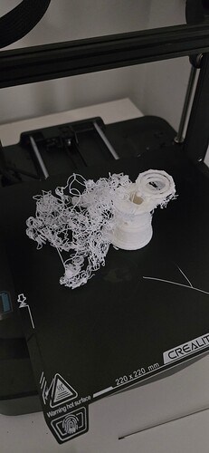

Put the temp up to 220. I haven’t got any alcohol cleaner at the moment but I will get some. This is the latest attempt
If your print is moving around then surely bed adhesion is the problem. If you are printing at the materials recommended temperatures then check levelling and adhesion options. For the levelling; preheat bed and nozzle, manual level to give paper thickness clearance between bed and nozzle, auto level, then check clearance again at centre. There should be some resistance when push/pulling the paper. I see from your prints that you dont appear to try brim and raft etc option. Try them
I increased the bed temperature to 65 and that seems to stop in moving, it seems to stick to the bed which I think is right? However it seems to be catching as you can see from the last picture it’s going off course massively.

I dont feel like its the bed thats the issue. I dont think its slipping until the nozzle catches it. The first layer goes down ok but then it doesnt seem to get out of the way if that makes sense.
