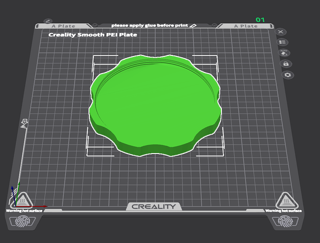

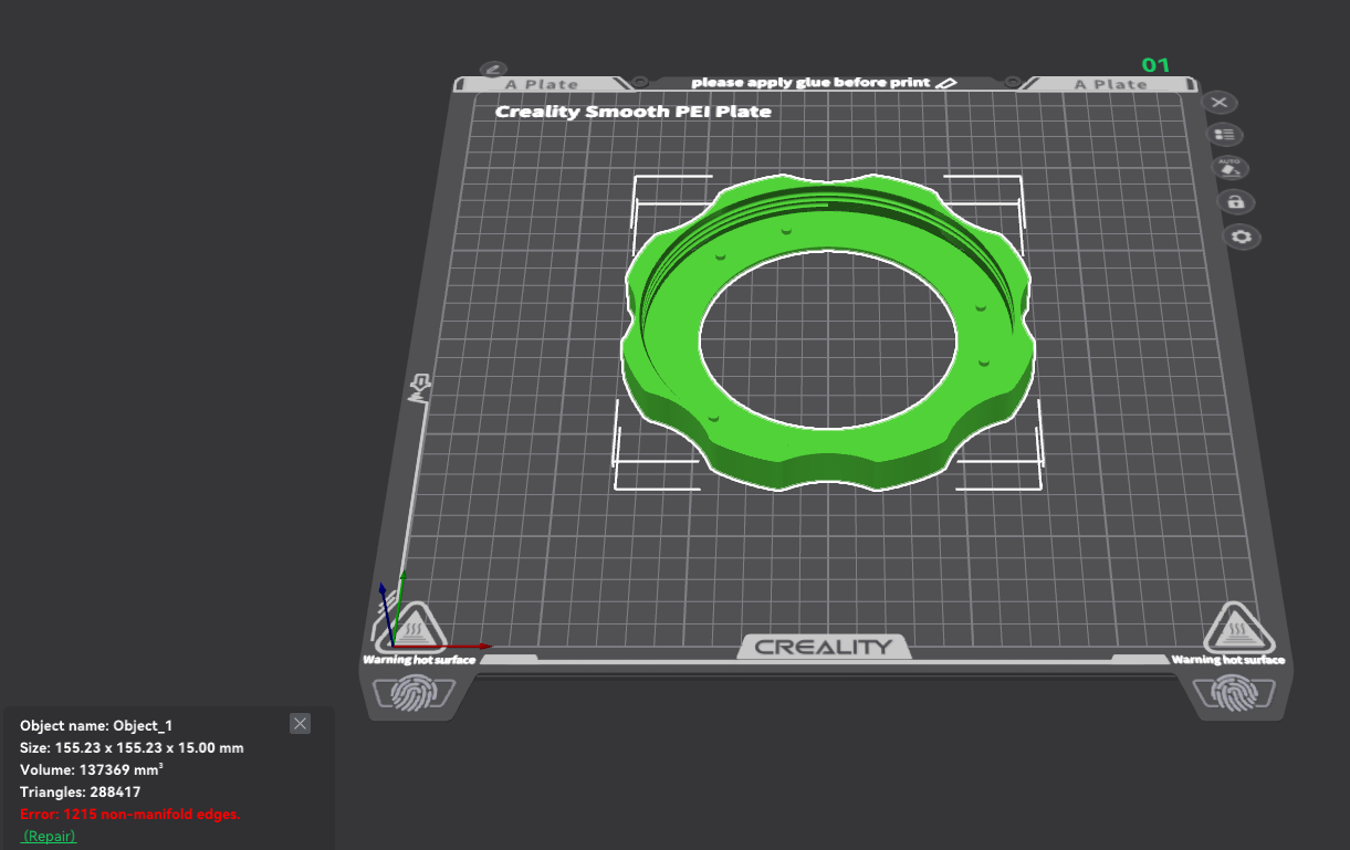

I’m using Creality Print 6.2.1. When I download the part in image 1, it gives me an error. When I fix it, it fills in the hole.
Don’t know how to fix it.

" Objects isnt manifold " means it has something like a gap , hole or overlapping triangles in the mesh etc, youll need to go into another program like blender to fix it, or maybe you can fix the filled in hole by drilling it out again in creality print once creality print has filled it in https://www.google.com/url?sa=t&source=web&rct=j&opi=89978449&url=https://www.youtube.com/watch%3Fv%3Db9dIDkIwlg4%26t%3D58&ved=2ahUKEwjp2KWjnIePAxUTxzgGHdYYImMQma4LegQICxAC&usg=AOvVaw2JeFndwXc_NAYzmHxVpmt4 havent tried it myself
