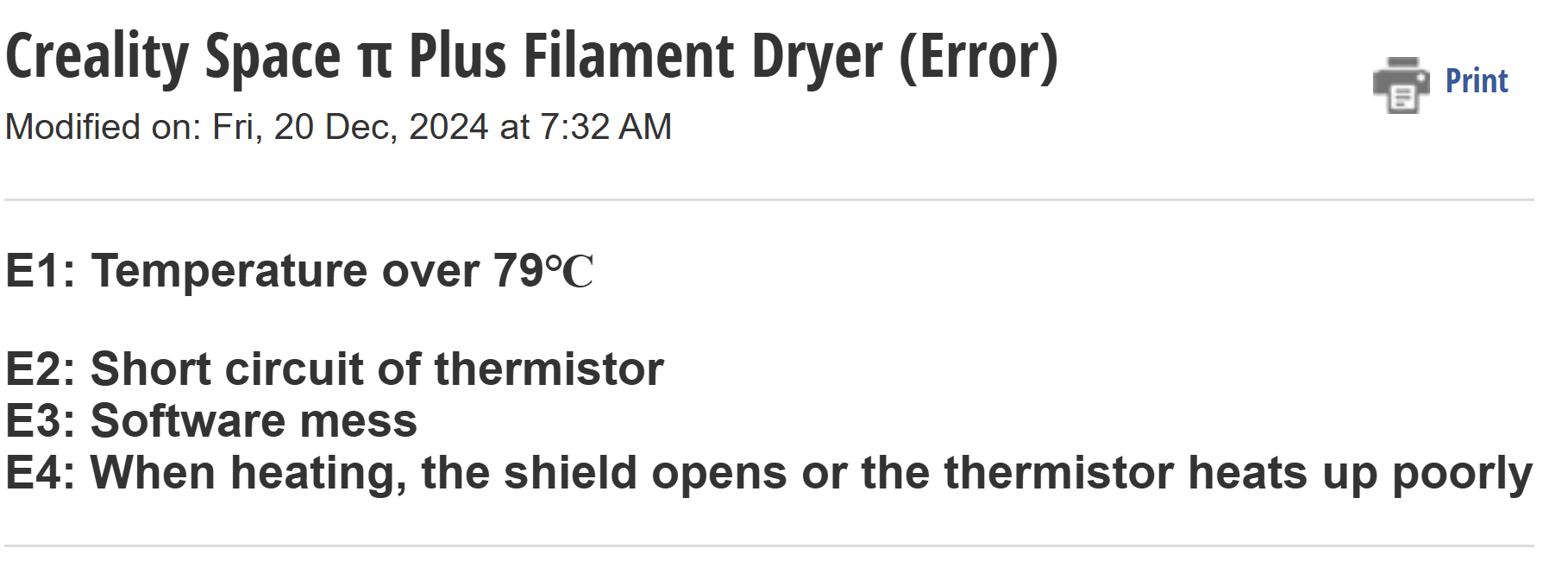

Space Pi (Dual) filament debugging E4 error code
FYI in case anyone else hits this, it can be self fixable.

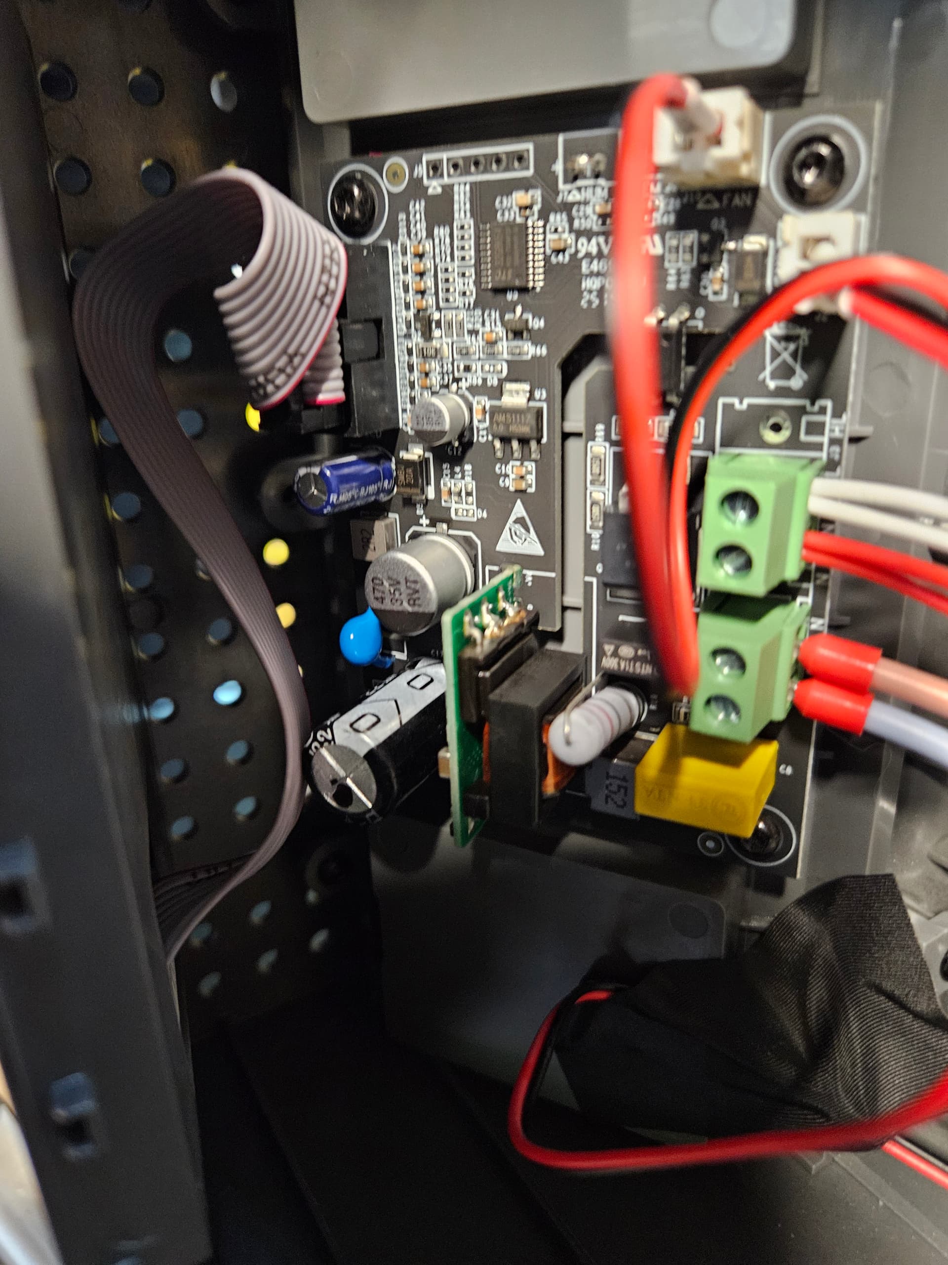

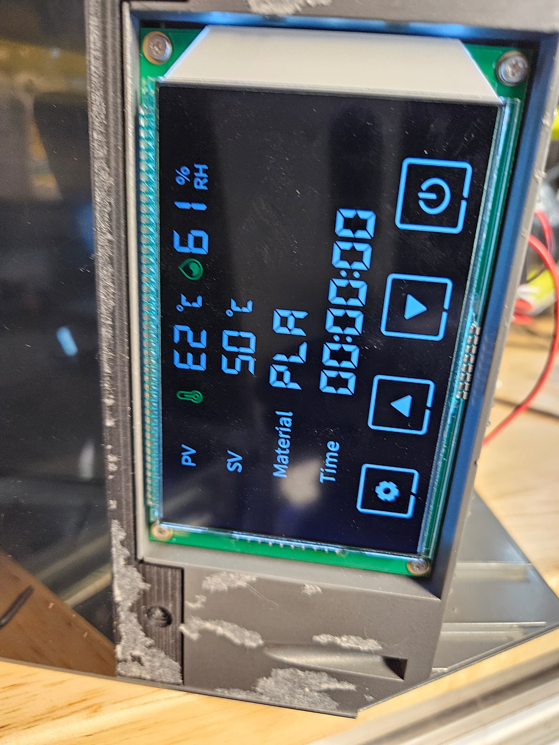

After a replacement circuit board my error went from E4 to E2

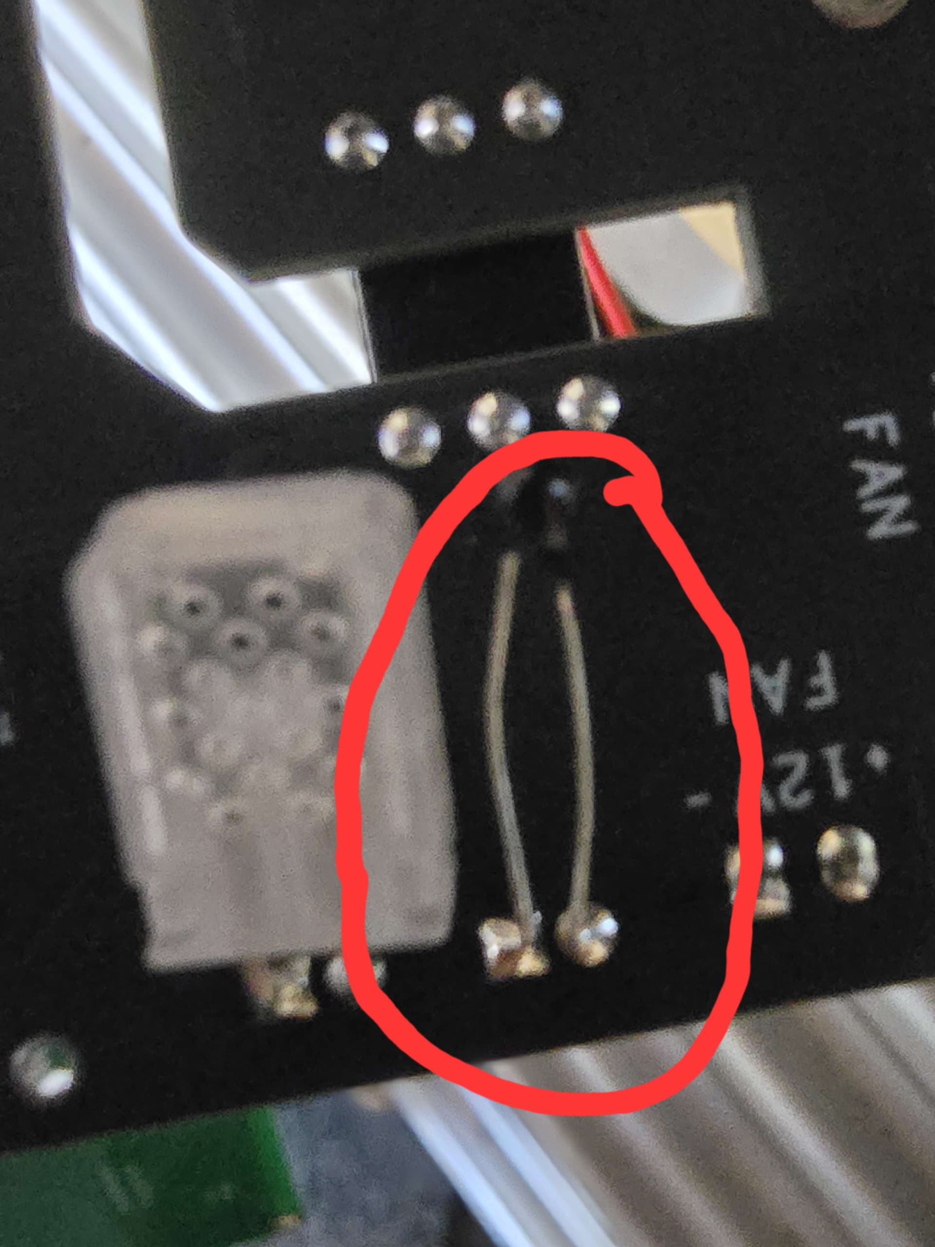

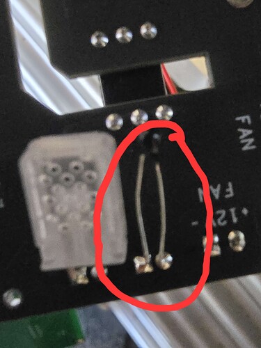

Using above information found and fixed E2 via (power off) using a screw driver and gently separating the smaller item on the back of the circuit board so the legs were no longer touching
