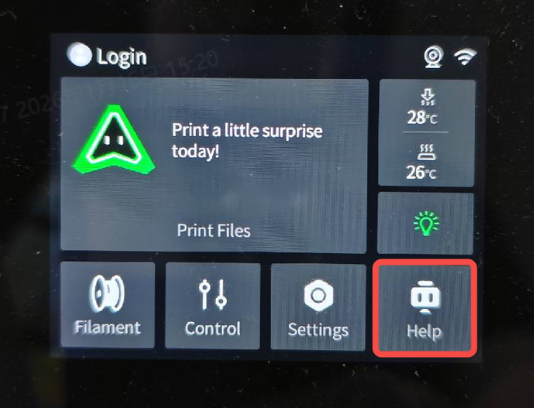

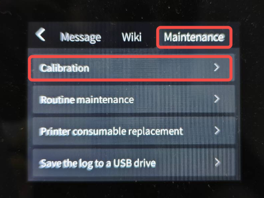

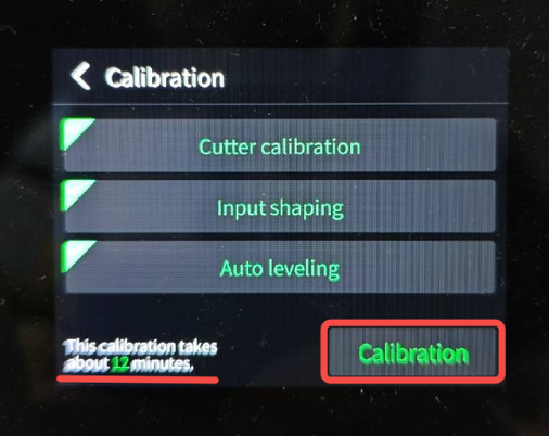

On the printer’s screen, tap Help → Maintenance → Calibration to enter the automatic calibration page. Select the calibration items you want to perform. The estimated calibration time will be displayed at the bottom of the screen. Tap Calibrate to start the automatic calibration process.
