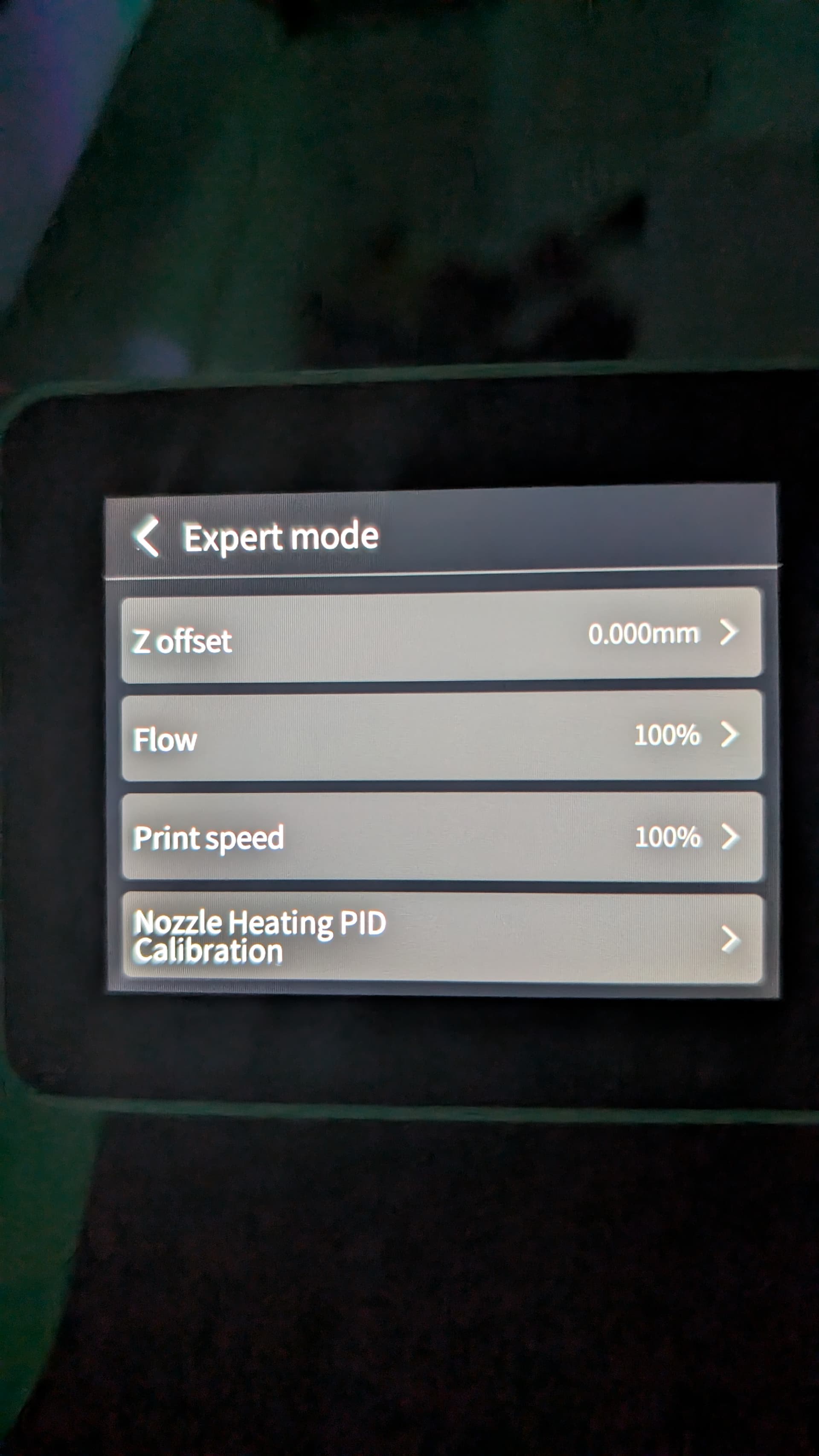

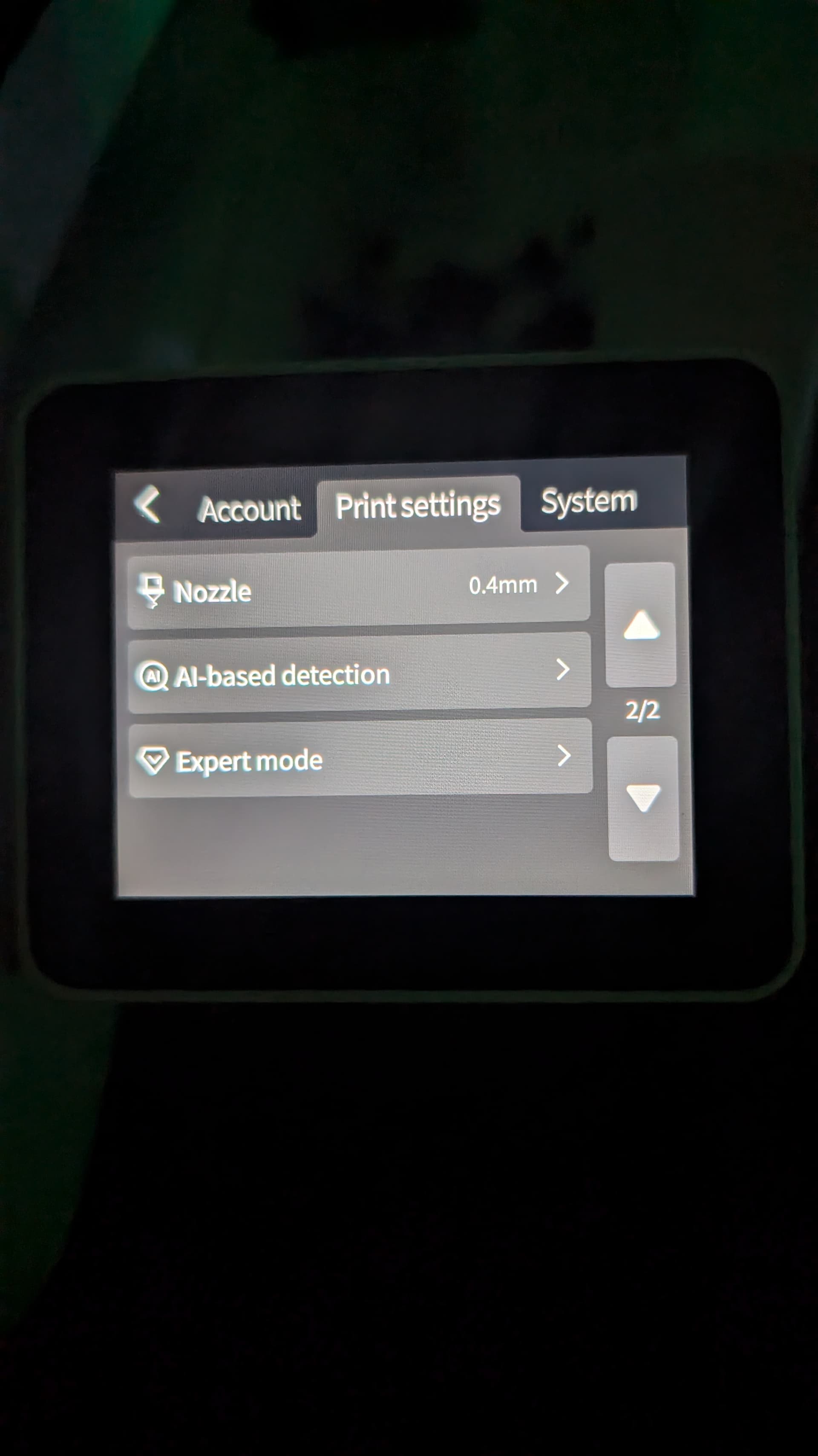

Just got my Sparkx i7 and I’m enjoying the experience so far, however, I’ve only been successful with two (out of six) prints due to poor bed adhesion. I’ve cleaned the PEI plate thoroughly with alcohol as well as soap and water. On my Ender 3v3se I can manually adjust the z offset to get a better squish on the first layer…but I can’t find how to do that on the Sparkx model. Any advice would be appreciated!

Z-offset is in the expert settings (temporary setting) and you can also set it for the device in the printer profile in Creality Print. But it should be able to print good first layers out of the box.
Thanks for the response. I actually flipped the plate over and found it laid down a perfect first layer. One thing I’ve come to realize is that I usually wipe down the plate of my Ender 3 with IPA…but I read that can actually smear contaminates on a PEI plate…so that may have been the culprit. Again - thanks for the help!

Under the user interface. Advance option can fine tune the z offset.
If the stock pei sheet causing issue you can try to order the cold plate or other replacement.
Under the user interface - advance option you can fine tune the z offset to get a better initial layer.
