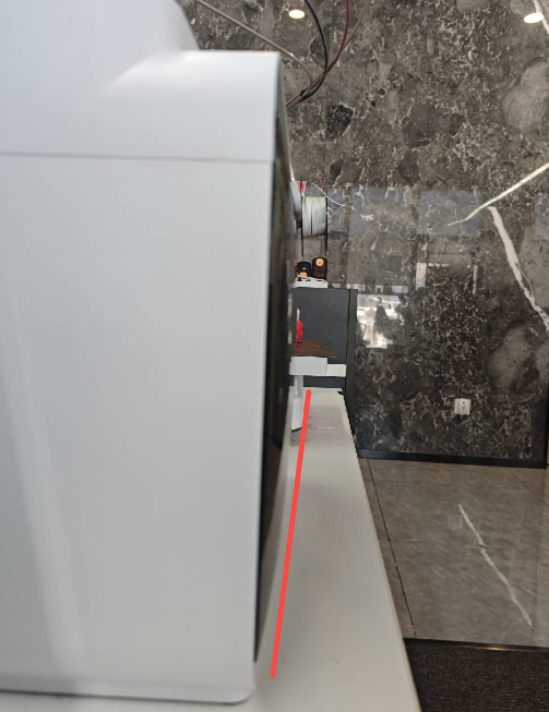

How should the i7 and CFS lite be positioned?
It is recommended to position the i7 and CFS lite as shown in the illustration, leaving sufficient space between them. The distance between the CFS lite and the Gantry should be approximately 8 cm, and the distance from the left side of the X-axis should be approximately 2 cm.
In addition, do not place the CFS lite too far back. It is recommended to align the CFS lite with the front of the i7, or place it in a centered position.

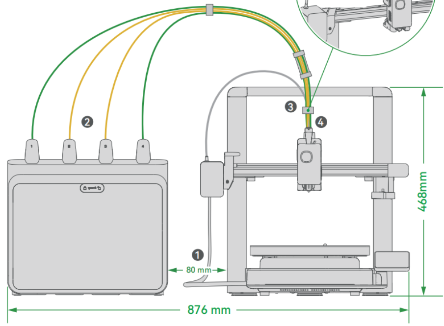

How should the PTFE tubes be arranged to reduce resistance during filament feeding and retraction?
All four PTFE tubes have a length of 98 cm.
The recommended distance between the i7 and the CFS lite is 8 cm (measured from the Gantry, or 2 cm from the leftmost side of the X-axis), as shown in the illustration. If the distance is too large, resistance during filament feeding and retraction will increase, and feeding resistance will also increase when printing on the right side.
To reduce resistance, we have designed three different hubs to help guide and align the PTFE tubes. Please install each hub as shown in the illustration:
Four-port hub (short): install it near the center position.
Four-port hub (long): its position is pre-fixed at the factory, approximately 8 cm from one end of the PTFE tubes.
Five-port hub: install it between the Toolhead Manifold and the four-port hub (long). During installation, place it closer to the four-port hub (long). The larger opening should face the rear of the i7 to allow the Toolhead Cable to be clipped in place.
What is the overall space requirement for the i7 Color Combo (i7 + CFS lite)?
To ensure more convenient use of the i7 Color Combo, you need to prepare a space with a length of 876 mm and a height of 468 mm.
Since the Heated Bed of the i7 moves back and forth, the required motion clearance is approximately 100 + 110 + 423 = 633 mm.
However, to prevent the Heated Bed Cable from colliding with objects at the rear, and to avoid contact with the user when the heated bed is at the frontmost position, we recommend reserving 200 mm of clearance at the rear and 120 mm at the front of the i7.
Therefore, the total required safety clearance is 200 mm + 120 mm + 423 mm = 743 mm.
