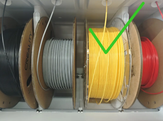

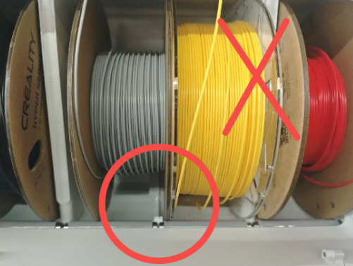

- The filament spool is installed incorrectly, has excessive rotational resistance, or becomes jammed, resulting in inconsistent filament feeding.

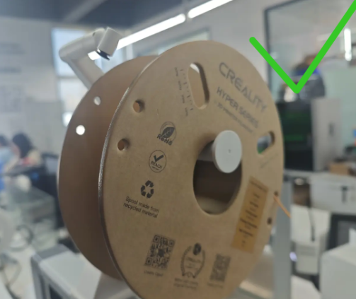

Check the filament placement and ensure the spool is properly seated on the Spool Holder or the CFS lite rollers.

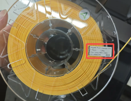

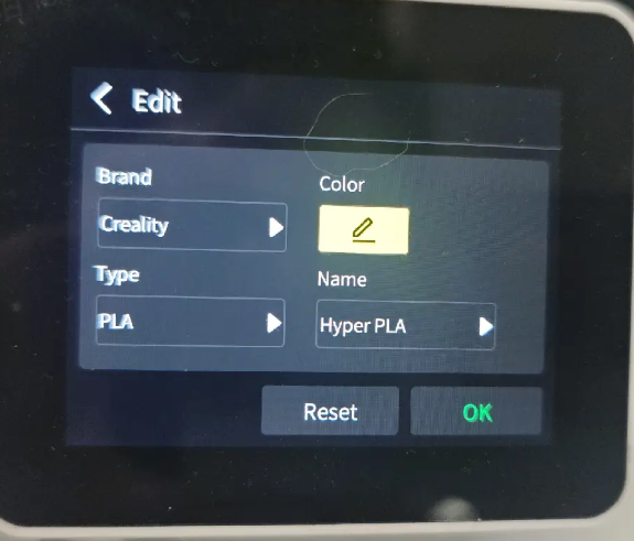

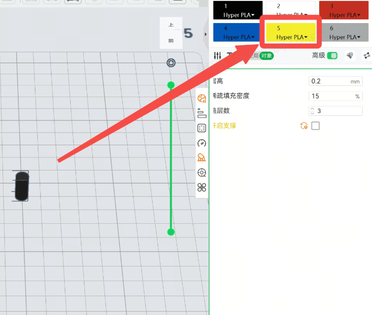

Check whether the filament parameter settings in the slicer match the filament being used.
Filament spools usually have labels indicating the brand, filament type, and recommended parameters. Please check that the filament settings on the printer and in Creality Print match the filament being used. The filament type must be consistent (for example, if PLA filament is used, both the slicer and printer settings must be set to PLA). It is generally recommended to also keep the filament brand, color, and other information consistent.

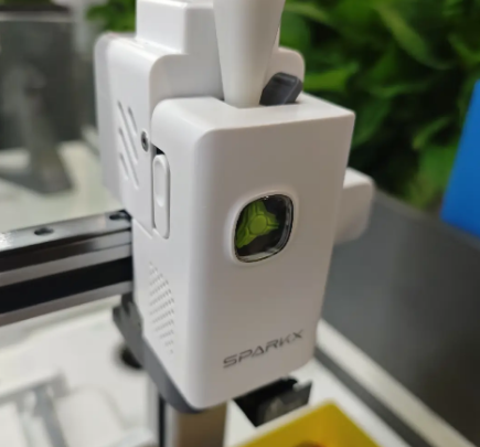

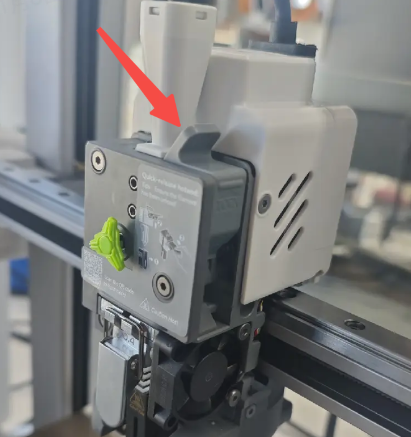

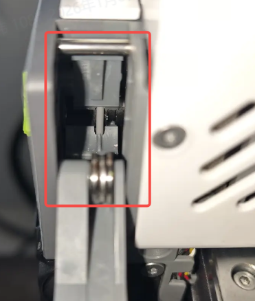

Remove the extruder front cover and manually cut the filament.

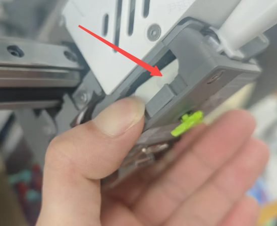

During printing, the motor is locked and the printer cannot cut the filament automatically. Do not move the X or Z axes, or the Heated Bed. Manually press the Cutter Arm to cut the filament.

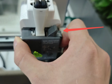

Open the Extruder Lever and manually unload the filament.

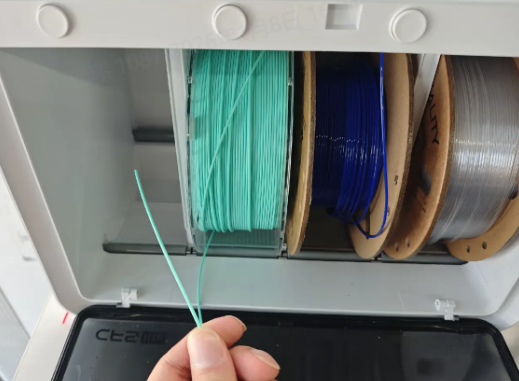

Open the idler lever of the extruder and inspect the filament inside. Manually pull out the corresponding filament from the CFS Lite.

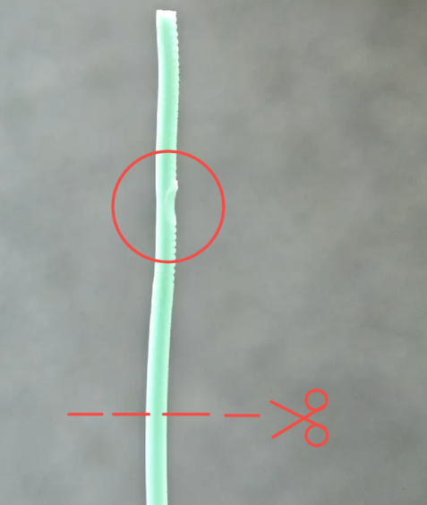

Inspect the end of the pulled-out filament and remove any damaged or abnormal sections.
Check the filament end for debris or grooves caused by grinding. Use scissors or manually break off any damaged sections to ensure the filament end is in good condition. Place the prepared filament back into the corresponding CFS Lite channel.

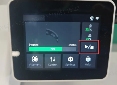

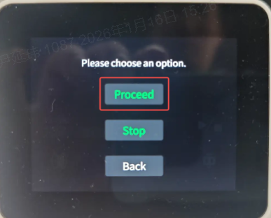

Resume the print job and check whether the filament is extruding properly.
Place the prepared filament back in position and click “Continue Print” to resume the print job. Observe whether the filament is feeding properly.;If the filament extrudes normally, you can continue the print job.;If the filament still does not extrude and the printer reports a grinding or clogging error, it is recommended to replace the Hotend before continuing.
