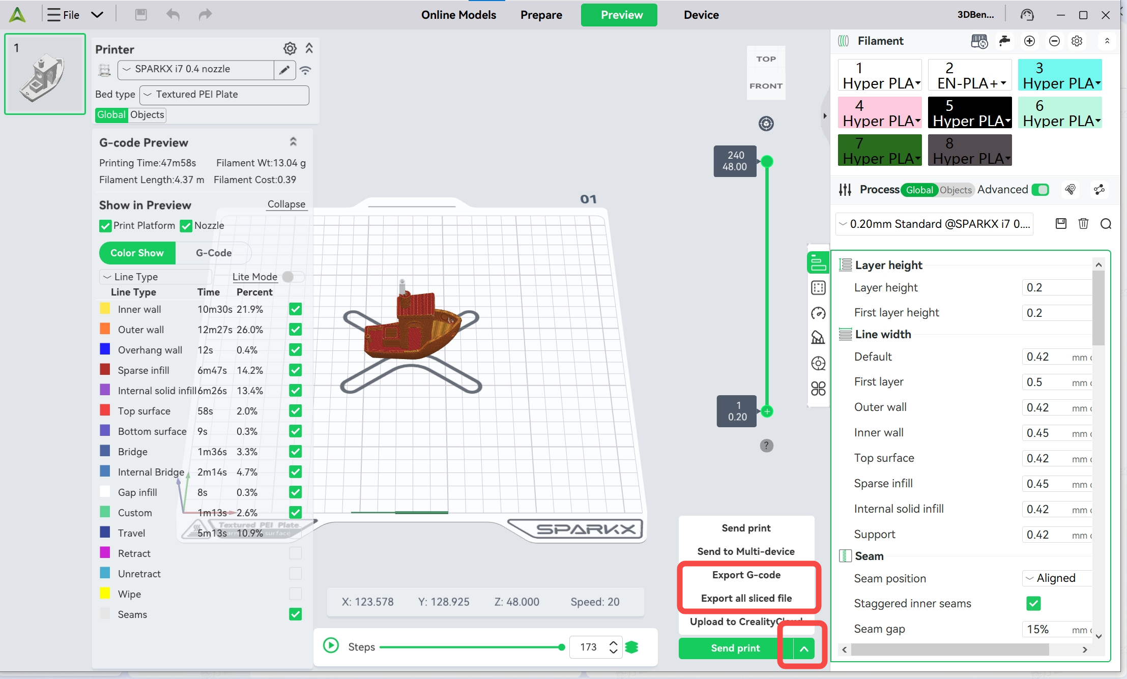

Prepare the Sliced Model File

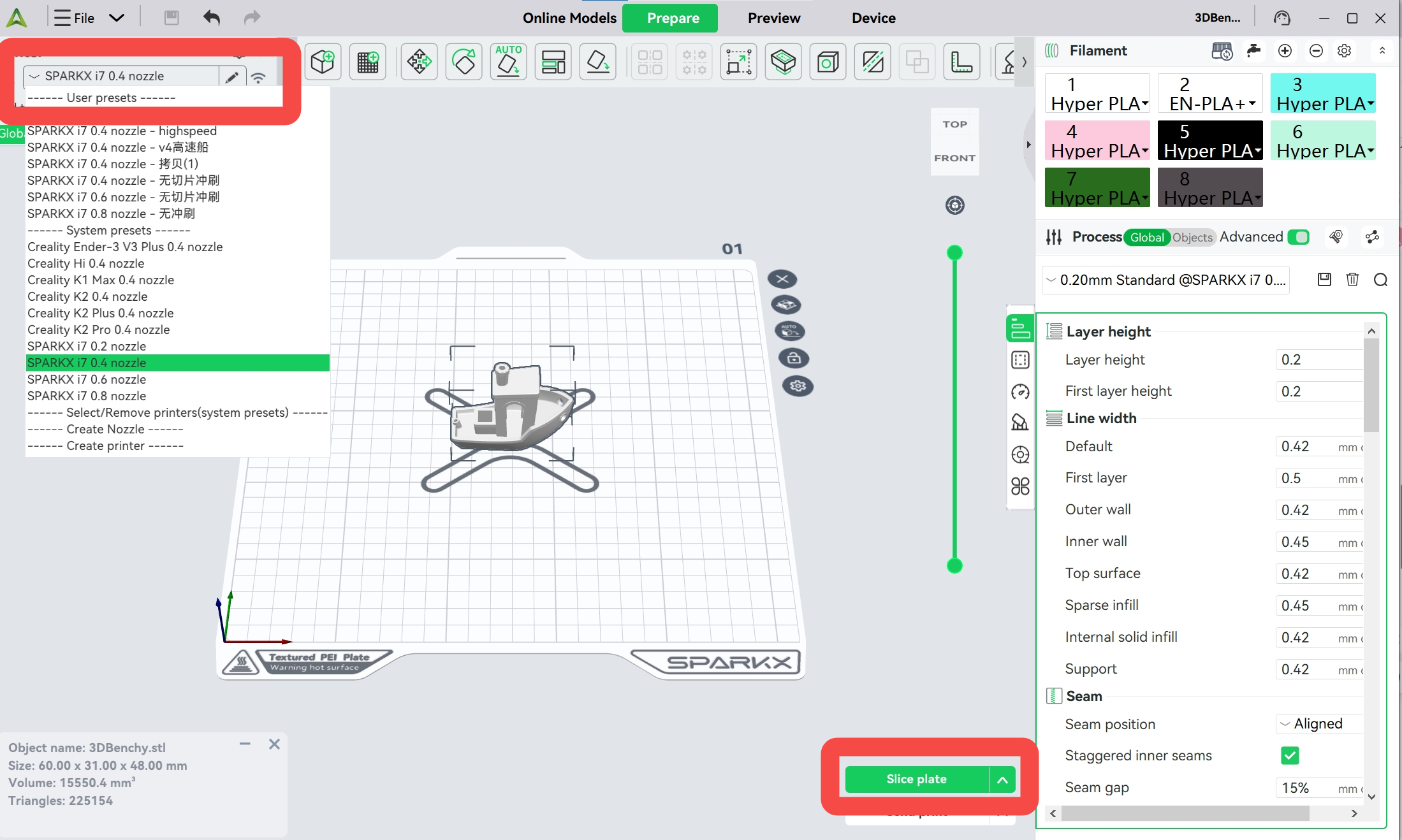

Open the model file you created or downloaded from an online model repository using Creality Print slicing software.
In the upper-left corner, select the printer model SPARKX i7.
Verify that all slicing parameters are correct.
Click Slice in the lower-right corner to generate the sliced file.

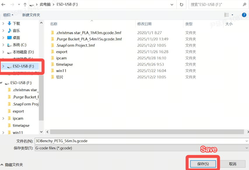

After slicing is complete, export the sliced file and save it to the prepared USB drive.

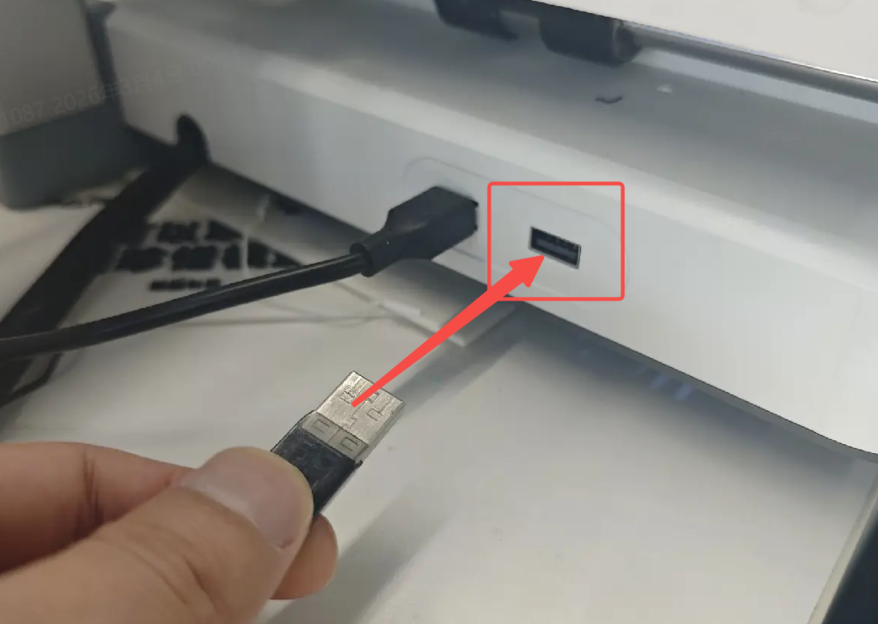

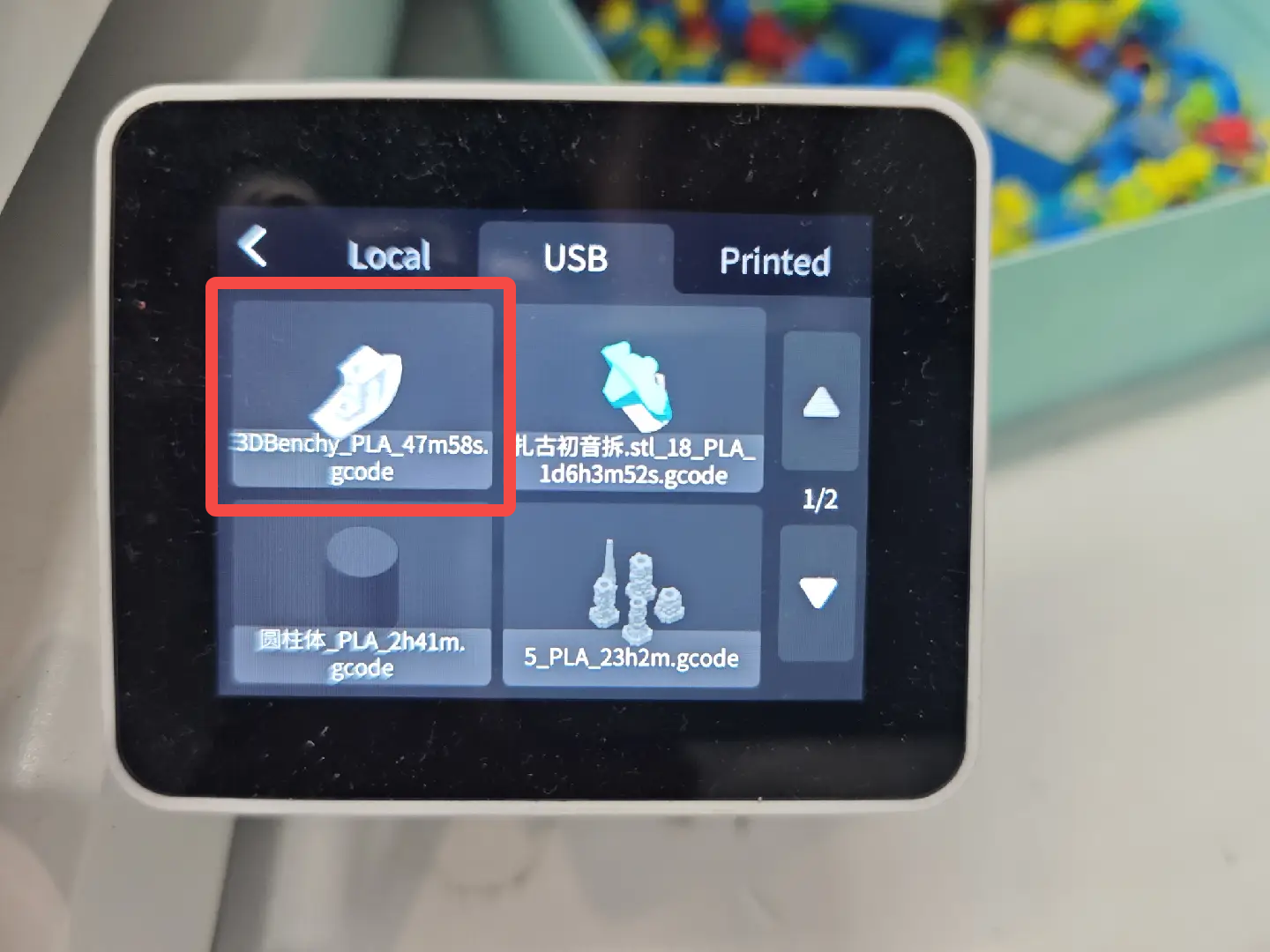

Insert the USB drive into the USB port on the left side of the printer. The printer will automatically detect and read the USB drive.

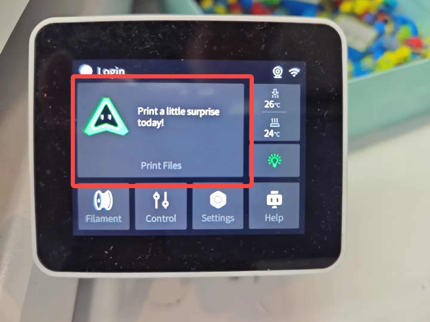

On the touchscreen:

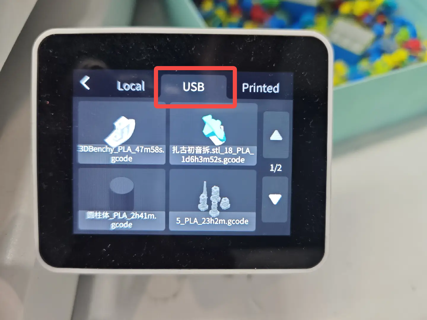

Tap Print Files → USB.
Wait for the USB drive to finish loading.

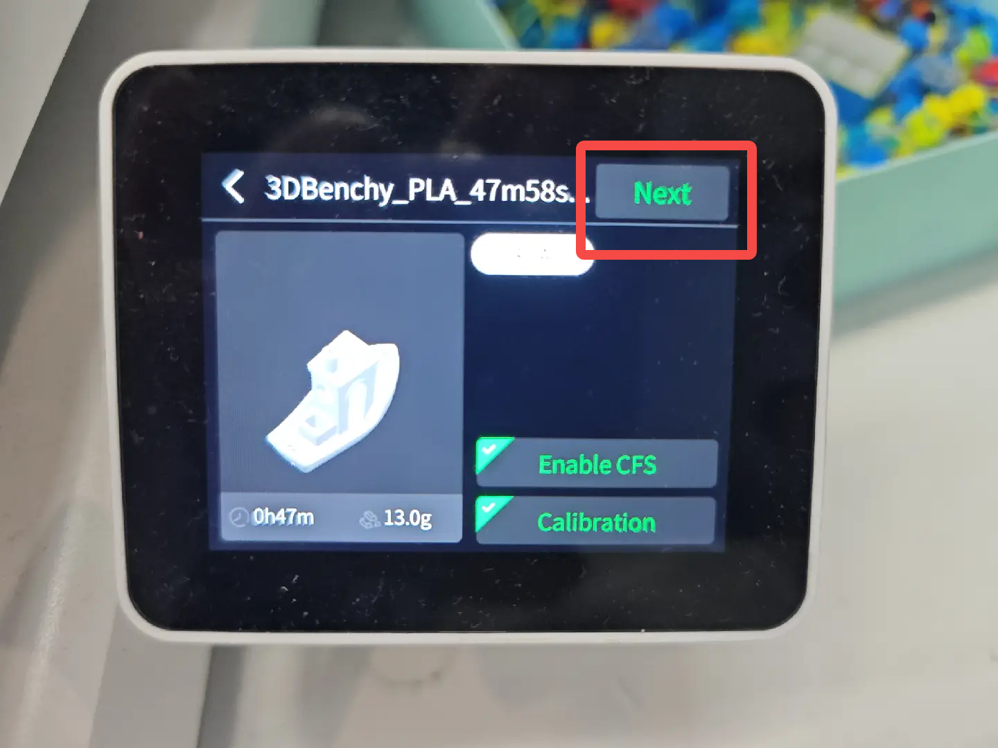

Select the sliced file you want to print.

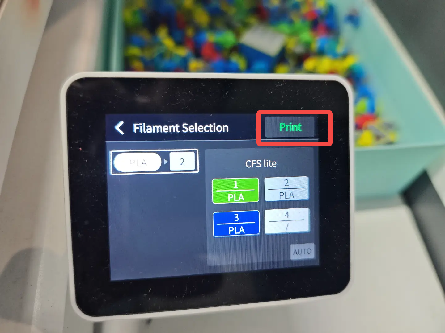

Choose whether to enable CFS (if available) and printing calibration.
For Color Combo models, you can also select the filament colors to be used.
Tap Print to start the printing task.
