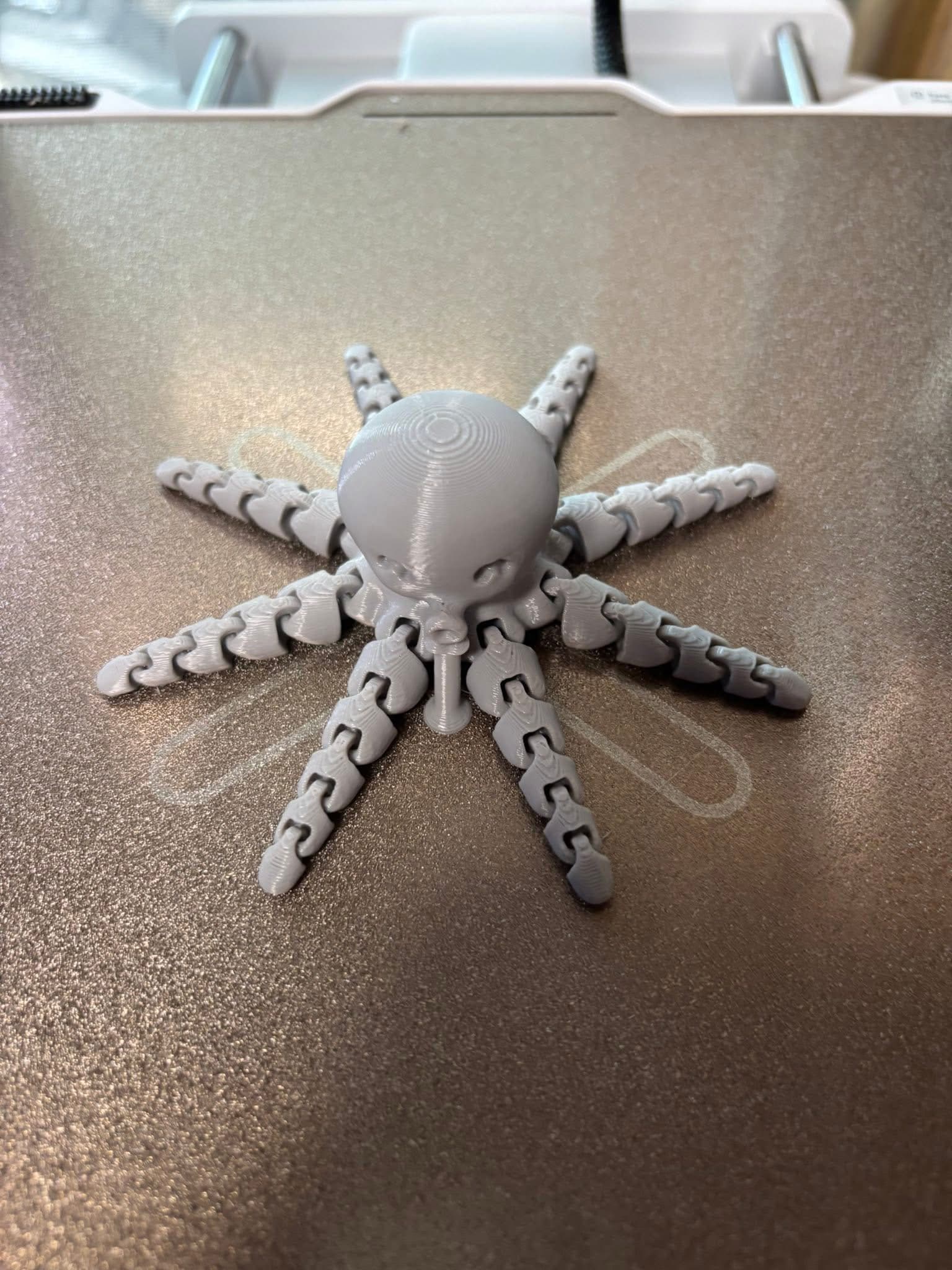

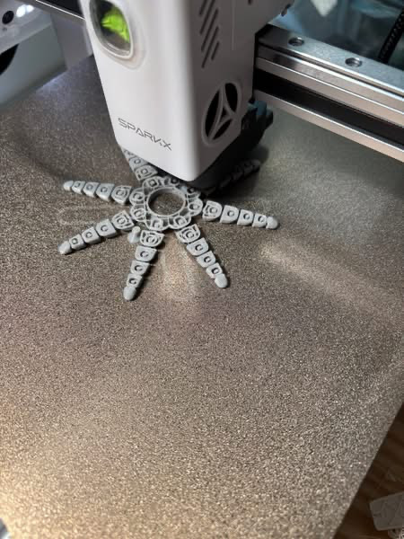

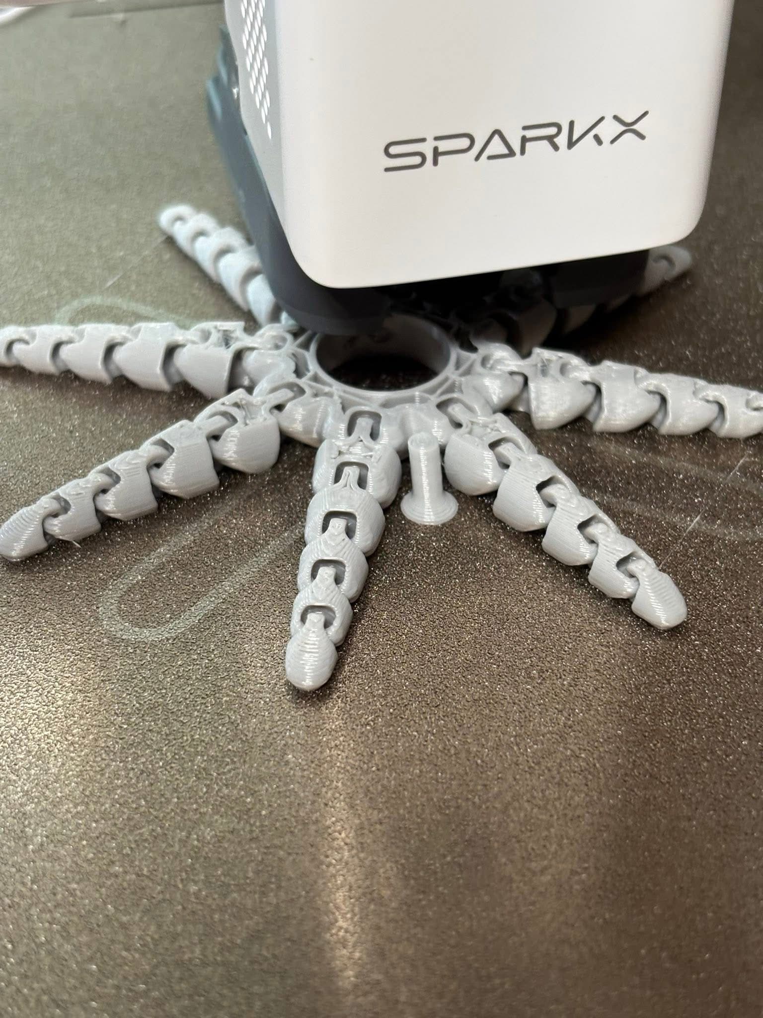

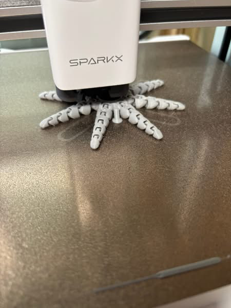

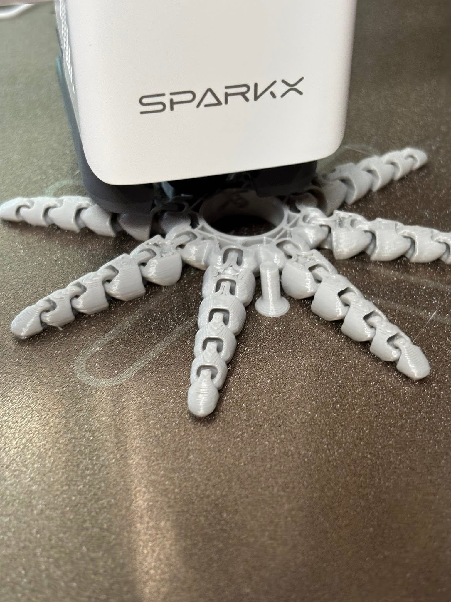

Printing: my first prints were excellent. The first layer adhere perfectly without defects. The benchy it printed without any flaws or stringing. I printed the articulating octopus and it was great! The articulations move easily and right from the plate. I didn’t have to do anything to initiate movement of the legs. I next printed the “Sparkx” keychain and utilized three colors. The waste was minimal for the amount of filament used. The texture was smooth and the lettering was clear and nice edges. All these prints were done without adhesive. They peeled off the plate with little effort.
