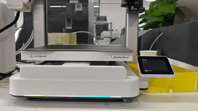

The SPARKX i7 features a multi-color intelligent status light located at the lower front of the printer. During printing, it displays the current print status in real time, including the task stage, printing progress, and error alerts, allowing you to quickly understand the printer’s current state. It can also be used as ambient lighting, with multiple lighting effects available to choose from.

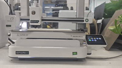

Power On
Light Effect: White breathing light
Description: The printer is powering on and entering the system. The white breathing light pulses until the startup process is complete.
Printer Self-Test / Calibration in Progress
Light Effect: Rainbow flowing
Description: The printer is performing a self-test or calibration. The rainbow flowing light remains active until the process is completed.

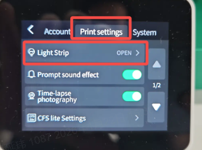

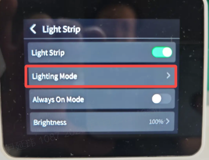

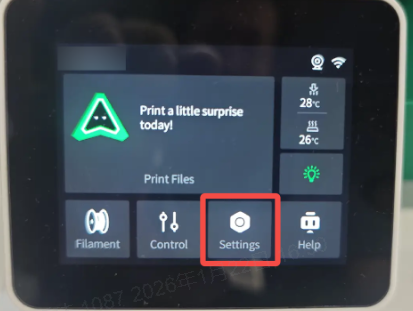

Description: The printer currently has no active tasks. You can enable Always On Mode in Settings → Print Settings → Status Light to keep the status light illuminated even when the screen is off.

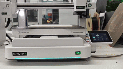

Printer Preparing
Light Effect: Cyan breathing light
Description: The printer is in the pre-print preparation stage. The cyan breathing light pulses slowly until preparation is complete and printing begins.

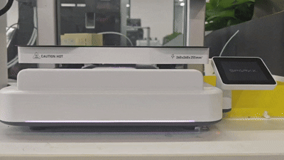

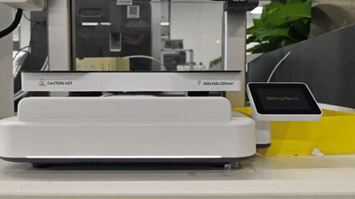

Printing in Progress
Light Effect: White indicator light displaying a progress bar, or custom ambient lighting
Description: The printer is actively printing a model, with the light indicating the printing progress in real time.

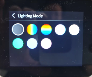

Multi-Color Ambient Light Guide
The SPARKX i7 comes with a variety of built-in ambient lighting effects for you to choose from. You can select your preferred lighting effect. Custom ambient light effects are only active when the printer is idle or printing.
Ambient Light Settings: Settings → Print Settings → Status Light → Light Effect Style
