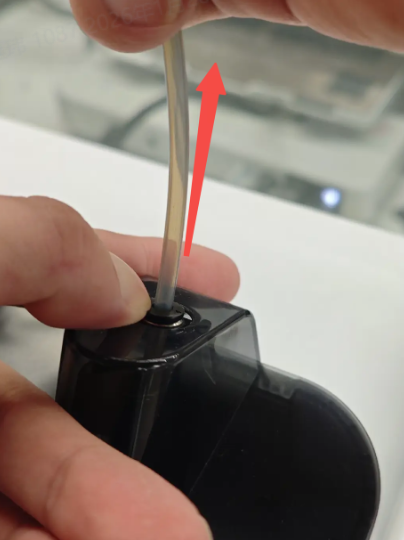

Removing the Old PTFE Tube

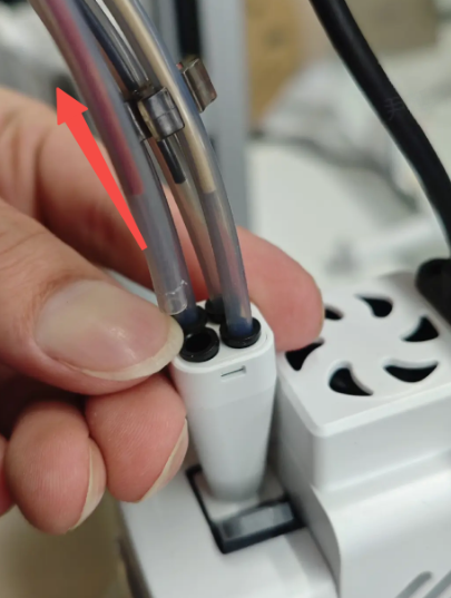

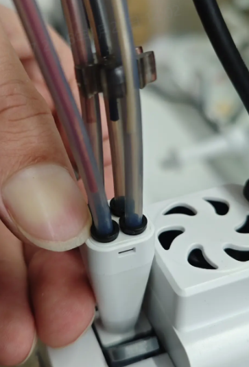

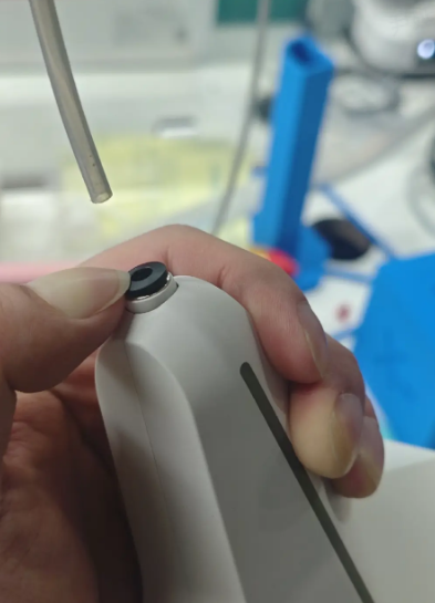

Remove PTFE Tubes from the Toolhead Manifold
There are four PTFE tube ports on the top of the Toolhead Manifold. Press the black collar of the port while pulling the PTFE tube upward. Tools may be used if necessary.

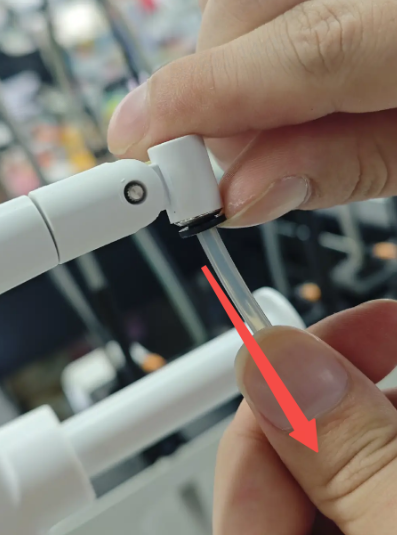

Remove PTFE Tube from the Spool Holder

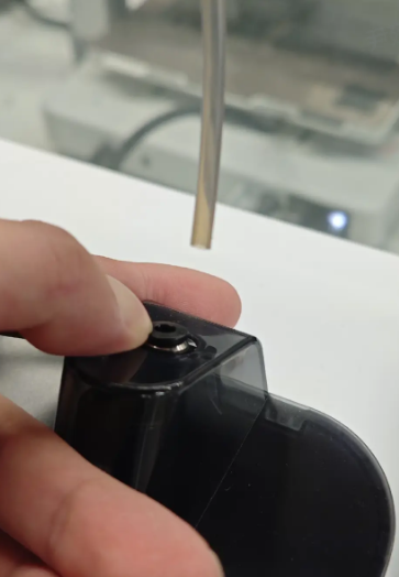

The rotating joint of the Spool Holder has one PTFE tube port. Press the black collar and pull the PTFE tube outward.

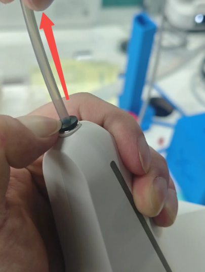

Remove PTFE Tube from CFS mini
The filament output side of the CFS mini has one PTFE tube port. Press the black collar and pull the PTFE tube outward.

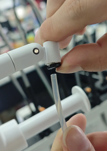

When using a Spool Holder or CFS mini, only one PTFE tube is required.
Insert one end of the PTFE tube into the PTFE port on the Spool Holder rotating joint or the CFS mini outlet until it can no longer be pushed in. Gently pull back to confirm the tube is secure.
Insert the other end of the PTFE tube into any port on the top of the Toolhead Manifold until fully seated. Gently pull back to confirm the tube is secure.

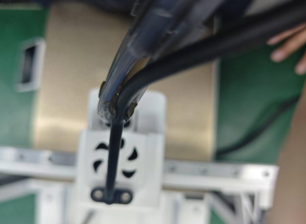

Secure the Toolhead Cable into the slot of the Toolhead Manifold clip to complete the installation.
CFS lite PTFE Tube Installation

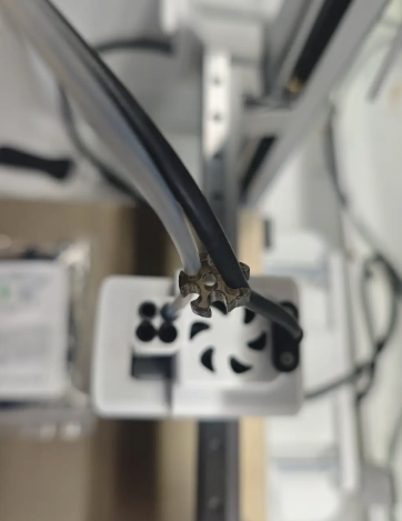

When using CFS lite, a total of four PTFE tubes, each 980 mm in length, are required. It is recommended to use the SPARKX multicolor PTFE tube replacement kit (product link). If using custom-cut PTFE tubes, install the three PTFE Clips as shown in the diagram below.
Align one end of all four PTFE tubes and insert them into the four ports on top of the Toolhead Manifold. Gently pull outward to ensure the tubes are securely seated.
At the other end of the tube bundle:
Insert the two slightly shorter PTFE tubes into the middle two ports on top of the CFS lite.
Insert the two slightly longer PTFE tubes into the left and right ports. Gently pull outward to ensure the tubes are securely seated.
Secure the Toolhead Cable into the slot of the five-port clip to complete the installation.
