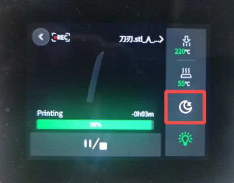

How to Enable
During printing, tap the “Sleep Mode” button on the printer touchscreen to activate it immediately.
