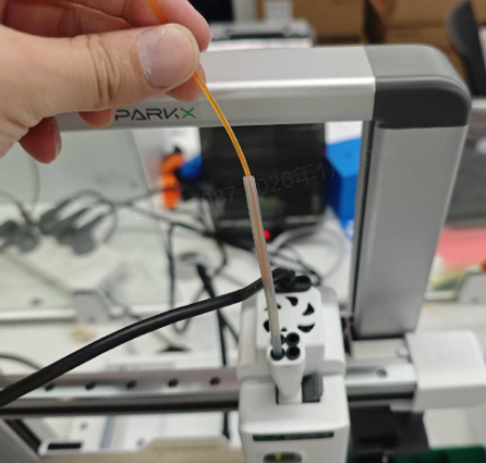

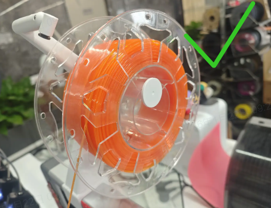

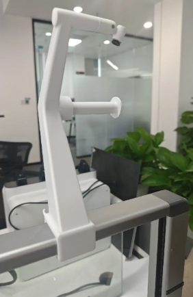

For flexible filaments that cannot be printed using the CFS lite, an external spool holder is required.
Remove all PTFE tubes from the Toolhead.
Install the external spool holder on top of the printer gantry.

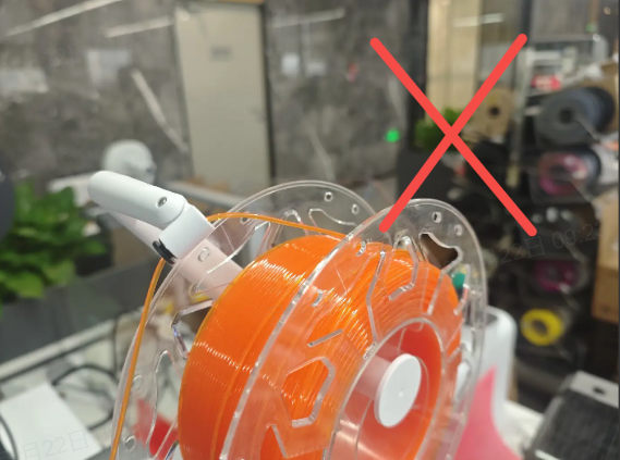

Load the filament. When printing flexible filament, do not feed it into the extruder through the pneumatic fitting of the spool holder.

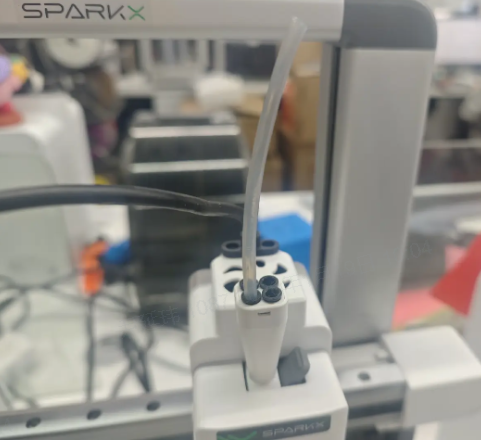

Prepare a PTFE tube approximately 10 cm long and insert it into any pneumatic fitting of the five-way connector on the Toolhead.

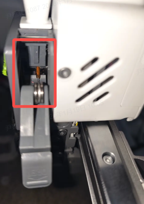

Load the filament to be printed. Remove the extruder front cover, open the extruder idler latch, and insert the filament into the PTFE tube.
When the filament end is observed entering the extruder drive gears, close the latch and reinstall the extruder front cover.

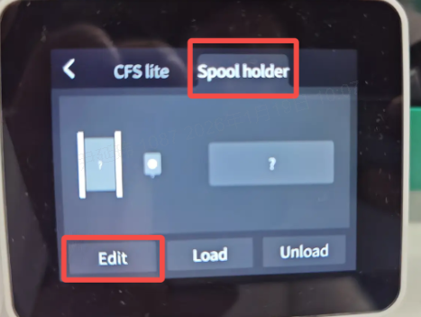

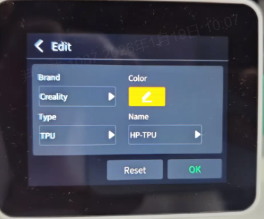

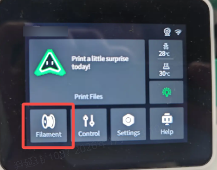

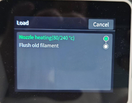

Enter the Filament interface, select External Spool Holder, edit the filament information, and tap Load.
Follow the on-screen prompts to complete the filament loading process.

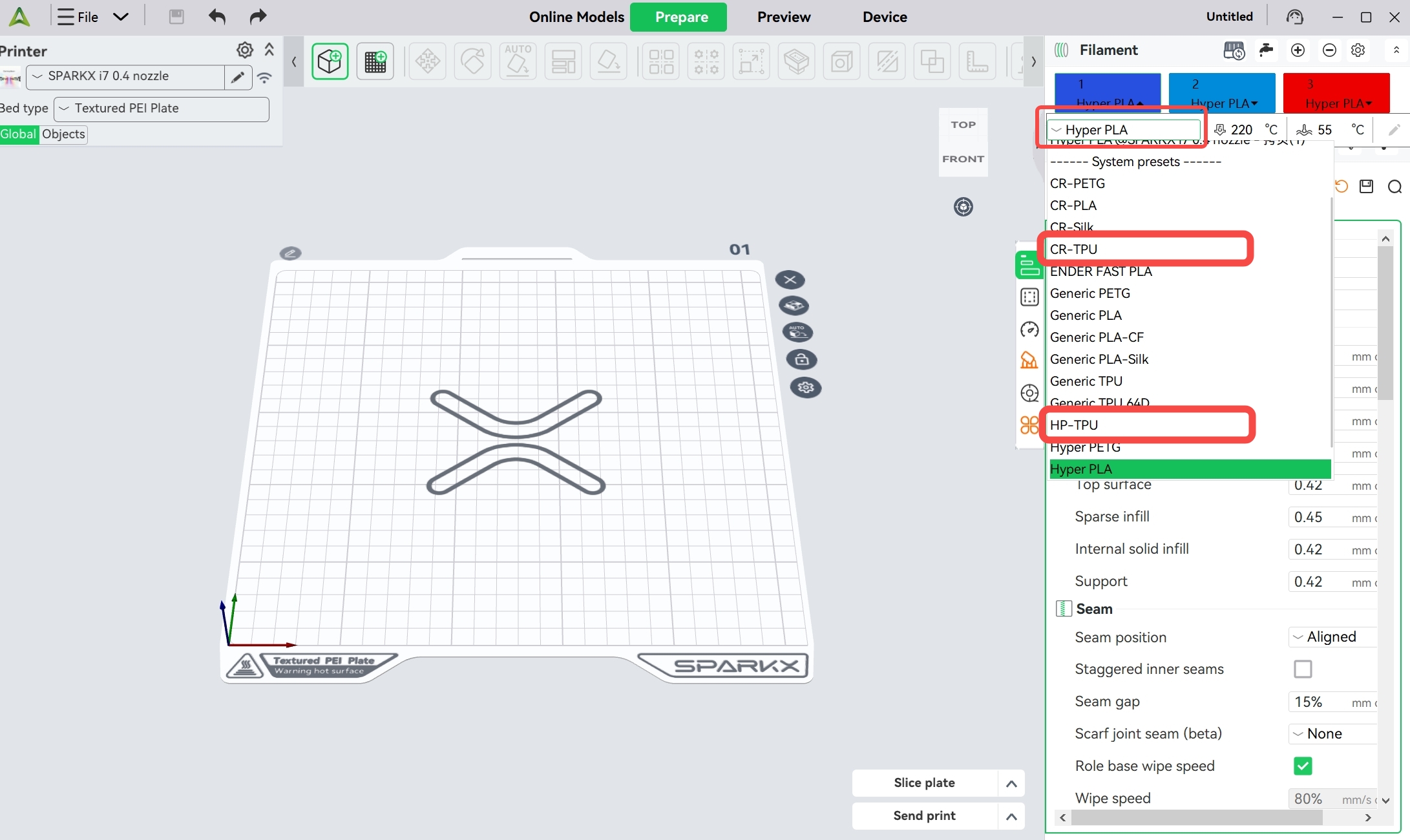

Slicing Settings

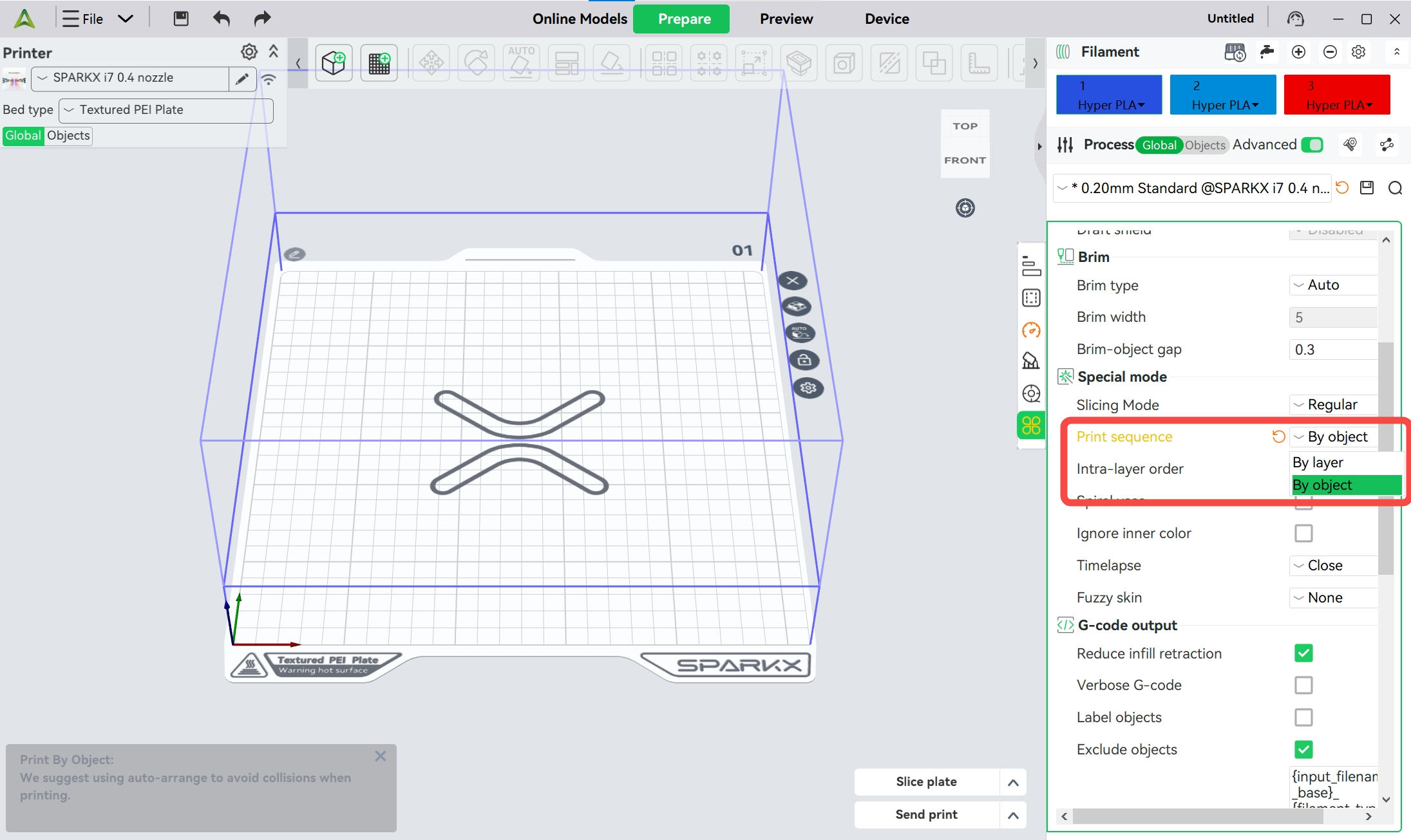

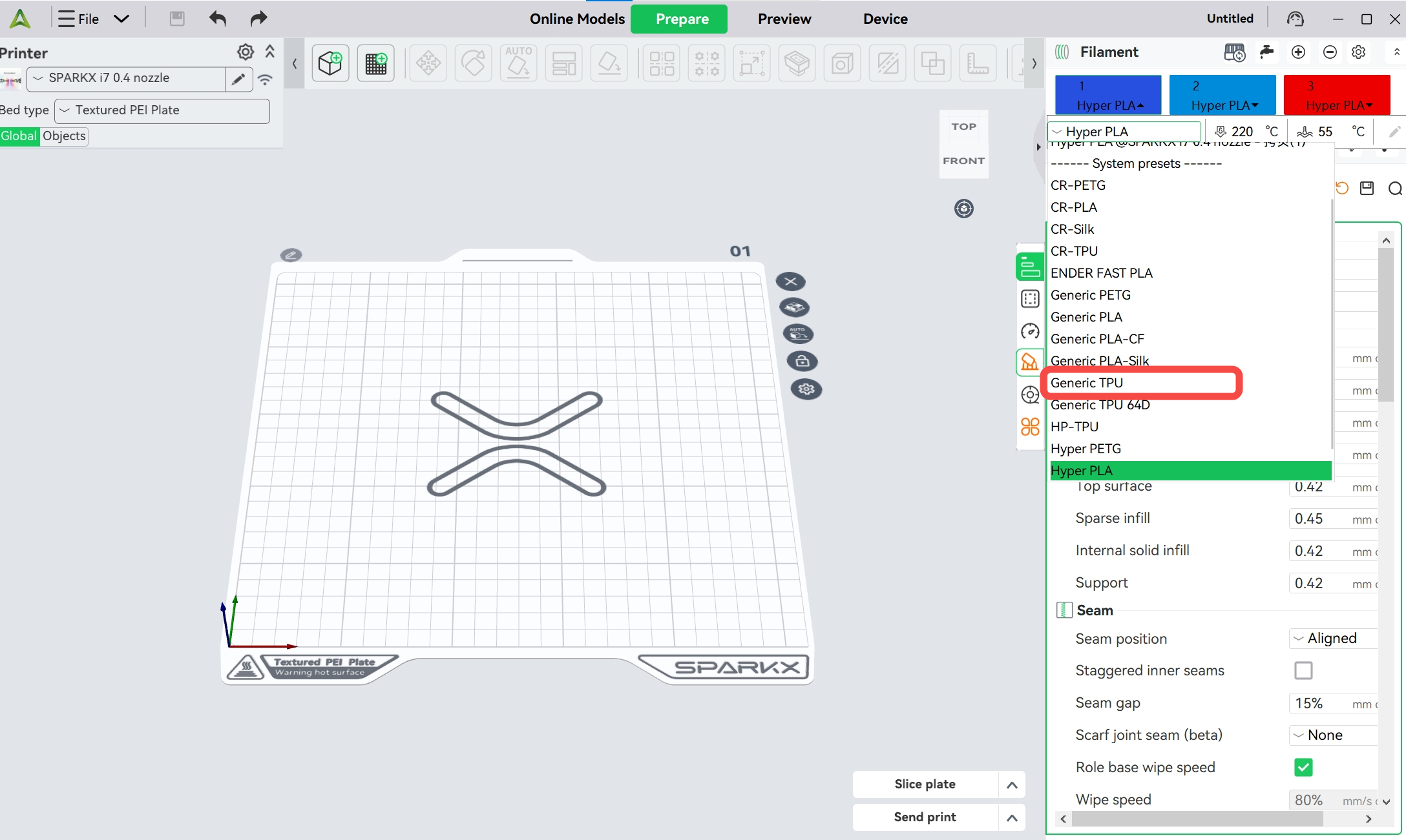

When printing flexible filaments, it is recommended to use a 0.4 mm nozzle along with the corresponding preset parameters. For Creality CR-TPU and HP-TPU, dedicated filament presets are available. If you are using third-party flexible filaments, we recommend selecting the more conservative “Generic TPU” preset.
Most flexible filaments are prone to stringing. Therefore, when arranging models on the build plate, excessive travel moves should be avoided. It is recommended not to place too many models on a single plate or use layer-by-layer printing. Instead, place only one model on the plate, or place a small number of models and use print by object mode.
