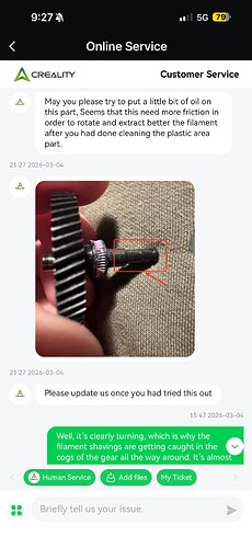

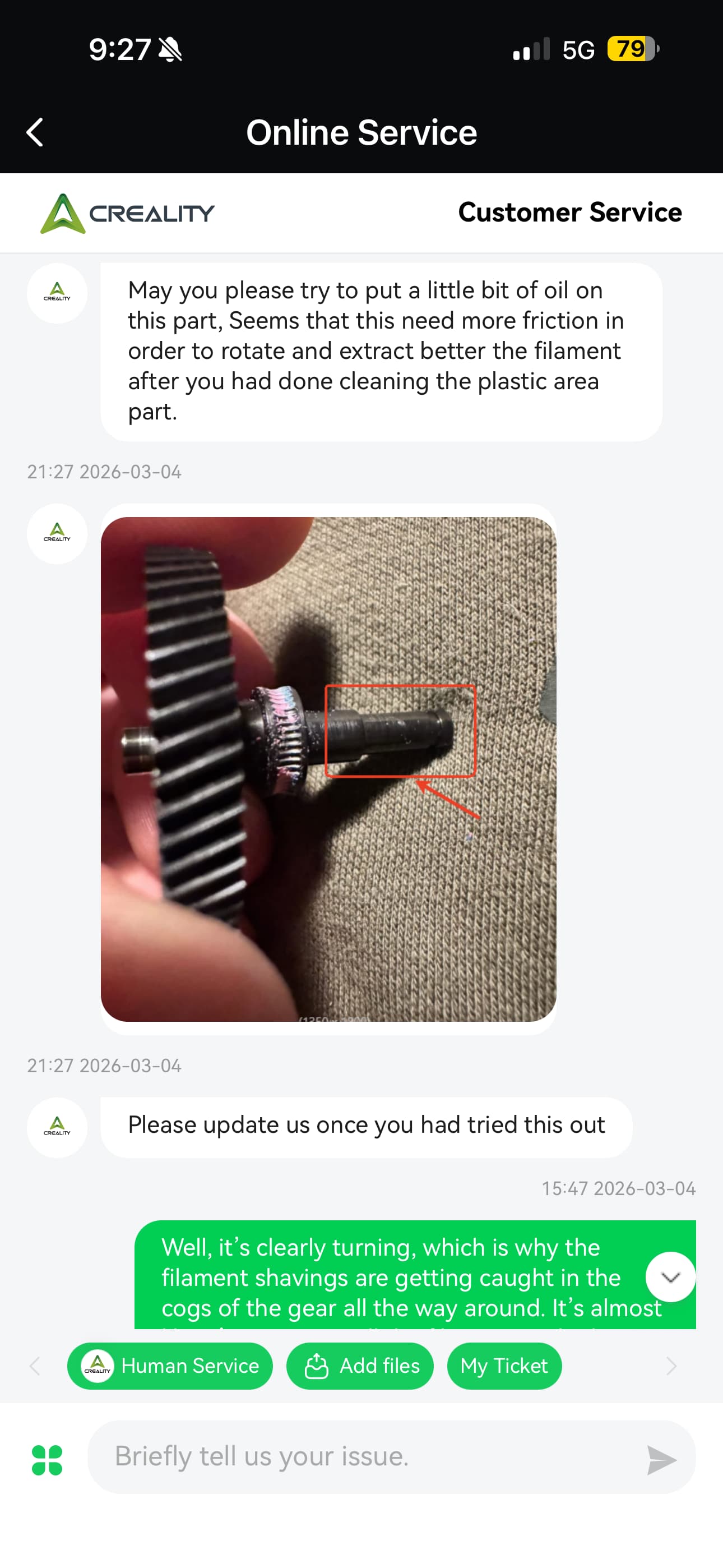

Turns out, if you put lubricant on the highlighted part, and reassemble, it works again lol hope this works out for you guys
@KicksStandLabs this is interesting :slightly_smiling_face: So it turns out to be resistance/friction on the shaft. Let us know if this solves the issue completely with an update :star:
It worked for about a week or so, then started pushing the same error code. FO0528. I havent found a permanent fix yet. But ordered a 3 pack of the extruder gears, in hopes that it permanently solves this pesky issue. I will say, by watching for many hours, it seems to be one or two specific CFS nozzles that are causing a problem. I did see a tip from someone that if you remove the PTFE tube from the splitter on the extruder side, heat the nozzle to 250 deg Celsius, and run a push pin all the way through, that should work. Gonna try that and see if it helps any.
