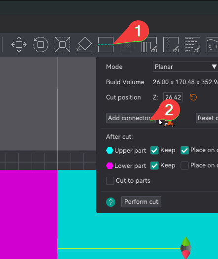

You can use the split function of OrcaSlicer

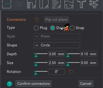

You can even add dowell connectors
