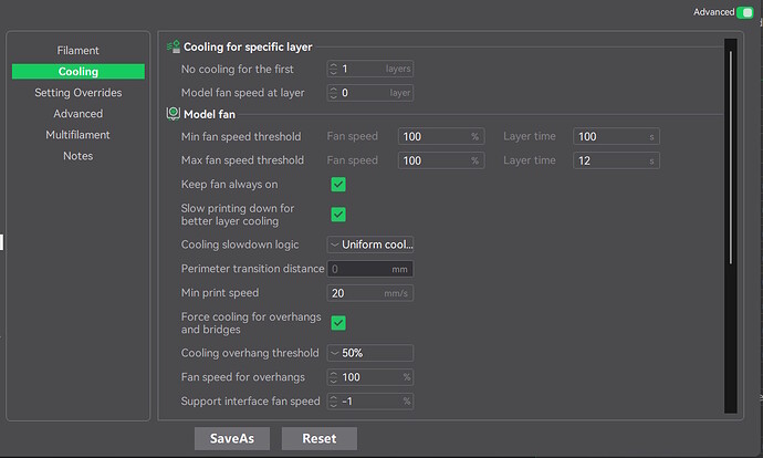

Hello there,
is it possible to stop the Case and Side Fans by a GCode or other command after finished prints?
I´m using ASA Materials and wanna lower the Temp in my chamber so slow as possible.
The fans are my problem.
I tried to stop it by slicers end-gcode but it doesnt work.
Can you help me?
Kind regards,
Chris

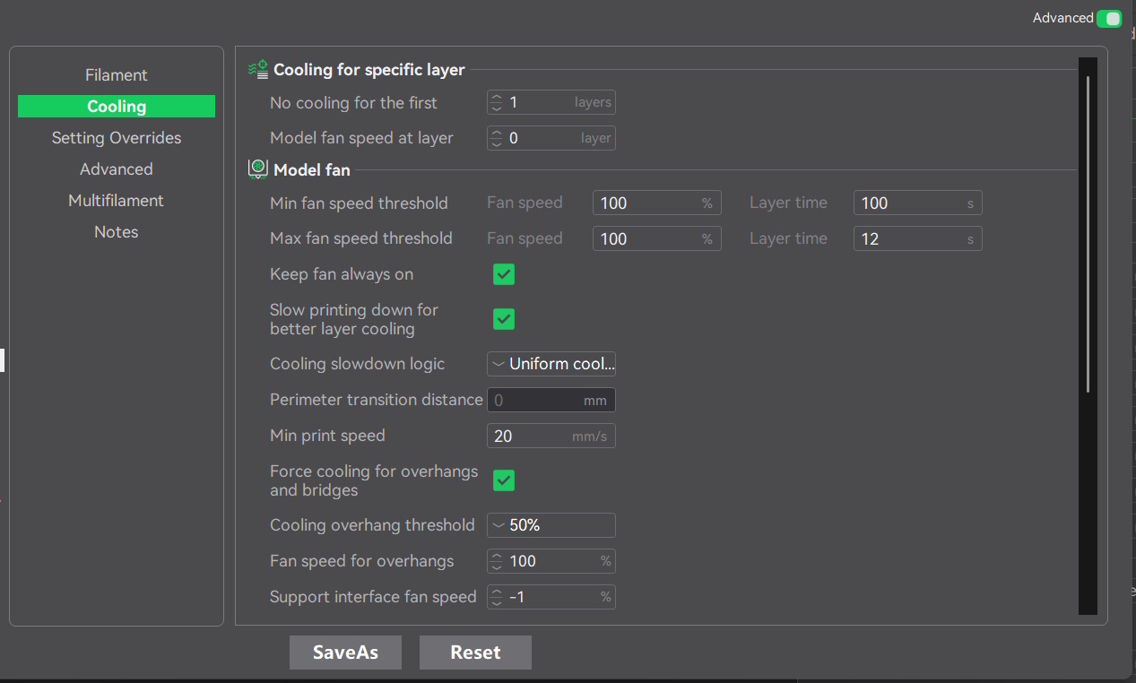

The setting for the fans can be found in the material-profile in Creality Print…
To shut down the fan that cools the chamber you can try M141 S70, this sets the desired chamber temp to the max value… fan will not start untill chamber temp will reach that goal…
